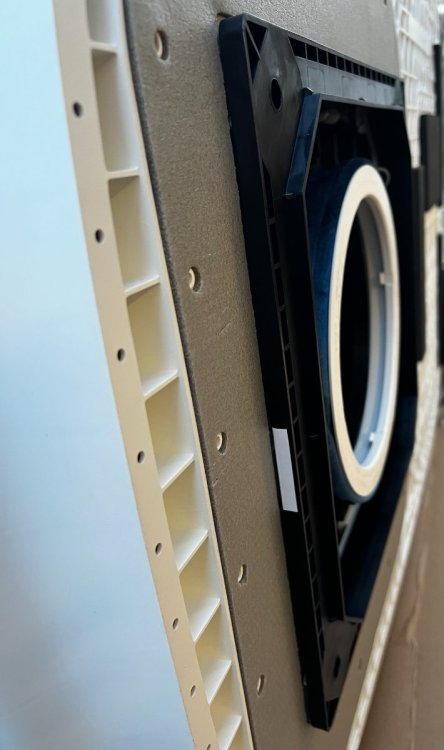

Here are a couple of pictures to help you. I'm afraid it's not going to be as easy as you'd hoped.  On the first picture, I've circled all the holes below the evaporator coil. The orange in the corners are maybe 8mm while the green ones are probably 5. As you can see, the entire bottom pan is structurally molded "plastic".  Looking at the parts breakdown may also help you.
The second picture shows the height of the roof support bracket. At best it's 10 mm so there's not a whole lot of space underneath the unit. The support bracket has an integrated foam perimeter seal, and compression-seals to the bottom pan when it's torqued down.  Elevating the unit would be much more involved than just using a "spacer gasket".
This particular 3400 is a sacrificial unit I was using, primarily to address your concern. Originally my thinking was to adapt a mini-split condensate pump but the juice didn't seem worth the squeeze. There is a company in OR that fabricates mounting "adapter plates" for these, primarily to accommodate the curvature of Airstream roofs. I thought about contacting them to come up with a design that also incorporated a drain pan system to connected with the Oliver's internal drain tube.  My mental design started to get really complex so I haven't pursued this idea any further at this point.
I've been using the 3400 on my LEII for about three years and don't find the way this unit drains onto the roof to be a big issue. I do tend to avoid high humidity however.

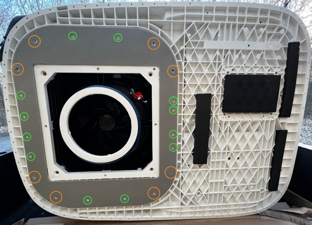

UNIT DRAIN HOLES:
  •   It appears that there are 20 each drain holes.  As they are in a pattern by design, I am thinking that not all 20 of them are for evaporator condensate.  If they were, Houghton would need an exotic air containment system for higher pressure Supply Air from the coil than the pressure outside the unit (atmosphere).  Without such a design feature, there would be a LOT of cold Supply Air leaking out those many holes.  It is possible that many of them are drain ports for rain, snow or splash that has entered the condenser coil area or when traveling?  If so, we would not need to capture that rain water.  Just let it flow over the side.
  • If that's the case, can we determine which ones are actually evaporator coil condensate drains?   That could simplify the collection of actual cold condensate.

All the holes I circled are open to a drainage trough under the evap coil perimeter. Since the coil is contained in a sealed housing, the fan tends to creates a negative pressure environ so any air leakage should be outside in. It seems to me however that the 8 larger holes at the corners are primarily drains for condensation with the remaining smaller holes providing pressure equalization.
Since the entire evap assembly is enclosed, there won't be any intrusion by rain or snow. For the exposed section of the unit, drainage is provided by the multitude of holes around the entire perimeter and a few others strategically positioned in the base.

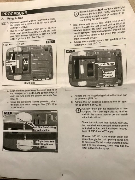

This is a picture of the Dometic A/C drain kit instructions.  The 14" square gasket in your picture of the drain kit is used in addition to the existing 14" gasket around the hull penetration with a notch cut into the original to allow passage of the drain tube from the cups to the internal drain tube.  The 2 straight gaskets are stacked at the rear of the base plate to level to unit.
