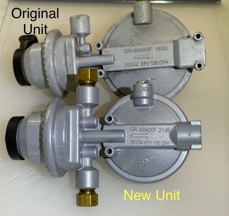

I recently had my original gas regulator die on Hull 505.
I wasn't paying close attention when I ordered the replacement and ended up ordering one with a lower BTU Rating.
The original Hull 505 part -  GR-9984XF with 345,000 BTU from the Main Service Cylinder is what I should have ordered.
The replacement part       - GR-9994XF has 262,500 BTU from the Main Service Cylinder is what I have now sitting in a box.
Since I learned of my error, I've ordered the original part and left the other new in the original box.
I can't return it as the time's expired for exchange.
Net Result:  I have a NEW in Box GR-9994XF sitting in my garage.
I'm wondering if the GR-9994XF would work as a spare for those of you with newer trailers that no longer have the Gas Fridge?

Thanks GJ.  I'll do that math exercise.
Thanks for the tip on summing up all propane users for the trailer and comparing to the max BTU output from the regulator.
Here's what I found out about my Hull 505 Propane Users:
Propane draws
Norcold N412.3FUI:          1,200  BTU/HR.  *From Fridge Service Manual*
Suburban Furnace:         18,000 BTU/HR.  *Printed on Side of Furnace*
Truma Waterheater:       60,000 BTU/HR. * Printed on Side of Water Heater*
Outland Fire Bowl :         58,000 BTU/HR.  *From Specs on Outland Website*
Dometic Cooktop :            9,600 BTU/HR. * From Domestic Website*
Sum of ALL:                    146,800 BTU/HR
Other BBQ’s etc:                 TBD
So it appears the smaller 262,000 BTU regulator will work just fine and can feed all those things running at the same time...and I shouldn't worry about upgrading to the larger 345K BTU  regulator that was originally on the unit.
I still have one in the box if anyone needs it.
Craig
