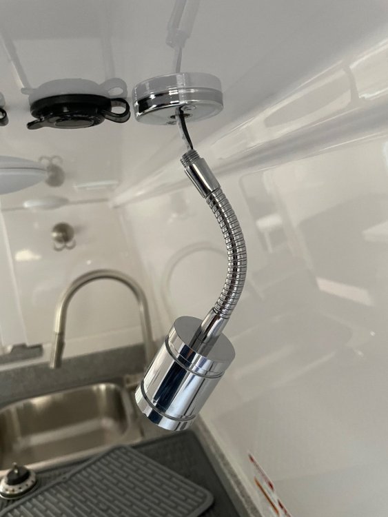

RustyMD Posted April 26, 2023 Share Posted April 26, 2023 I will try to attach pictures, but the question is this: one of my individual push button lights with the short gooseneck wire cover has come loose at the base. It is hanging by the two wires. The wire go through the gooseneck and then thru a hollow bolt and then thru the base that is attached to the ceiling/under cabinet. A nut inside/on top of the base has apparently come loose. QUESTION…what the heck are the fasteners holding the base to the fiberglass? They look like rivets. They don’t seem to be hex/Allen or torx/star. I can’t remove the base for what should be a simple fix. Help. Robert Youens 2023 LEII Hull #1304 TV 2022 RAM 1500 5.7L Hemi e-torque with tow package Link to comment Share on other sites More sharing options...
John E Davies Posted April 26, 2023 Share Posted April 26, 2023 Those are common aluminum pop rivets, you must drill off the heads and install new ones. Obviously you will need to buy a rivet gun and appropriately sized rivets. They look like 1/8”, so start with a 1/8” drill bit. If they are larger ,then go up in size. Wear eye protection and put down cardboard first. https://arrowfastener.com/wp-content/uploads/2017/09/RT187M-Rivet-Guide.pdf You could file a warranty claim, but who knows how long that will take….. BTW those are called reading lights. John Davies Spokane WA 4 SOLD 07/23 "Mouse": 2017 Legacy Elite II Two Beds, Hull Number 218, See my HOW TO threads: Tow Vehicle: 2013 Land Cruiser 200, 32” LT tires, airbags, Safari snorkel, Maggiolina Grand Tour 360 Carbon RTT. Link to comment Share on other sites More sharing options...
Rivernerd Posted April 26, 2023 Share Posted April 26, 2023 It looks in this photo like the top of the flex housing is threaded. Have you tried twisting it into a vertical position, then screwing it back in to the flange above it? If this method works, it would be easier than drilling out and replacing the pop rivets, after securing the flex housing to the flange in some way. 3 Hull #1291 Central Idaho 2022 Elite II Tow Vehicle: 2019 Tundra Double Cab 4x4, 5.7L with tow package Link to comment Share on other sites More sharing options...

Steph and Dud B Posted April 26, 2023 Share Posted April 26, 2023 8 hours ago, Rivernerd said: It looks in this photo like the top of the flex housing is threaded. Correct. One of ours started to come loose and we just twisted it back in. 1 Stephanie and Dudley from CT. 2022 LE2, Hull #1150: Eggcelsior. Tow vehicle: 2016 GMC Sierra 6.0 gas dually 4x4. Our Oliver journey: Steph and Dud B's RV Screed Where we've been RVing since 1999: Link to comment Share on other sites More sharing options...
Moderators mossemi Posted April 26, 2023 Moderators Share Posted April 26, 2023 9 hours ago, Rivernerd said: It looks in this photo like the top of the flex housing is threaded. This is the OEM light hull 193 was equipped with. My best guess is that the nut and washer is loose and will be impossible to get back on the hollow bolt. You can remove the rubber mat in the cabinet and locate the top of the fixture, it will be under the black tape corresponding with the fixture location. If you attempt this method I think it would be beneficial to pre twist the wires in the opposite direction so that they straighten out when you thread the stem back in. Mossey 7 Mike and Krunch Lutz, FL 2017 LEII #193 “the dog house” Link to comment Share on other sites More sharing options...
Moderators mossemi Posted April 28, 2023 Moderators Share Posted April 28, 2023 (edited) Revisiting my post above, I don’t think you can complete this repair without drilling out the rivets. The nut and washer have to be trapped in the chrome base which is still attached to the bottom of the cabinet. The hole in the cabinet that the wiring passes through is not large enough for you to work through to line up the washer and nut. And of course there is no way to get a wrench on the nut to secure it either. And I will add that the lights I installed are screw mounted, not riveted. The lights Oliver installed are riveted. Sorry if I miss directed you with my first post! Mossey Edited April 30, 2023 by mossemi typo correction 1 3 Mike and Krunch Lutz, FL 2017 LEII #193 “the dog house” Link to comment Share on other sites More sharing options...

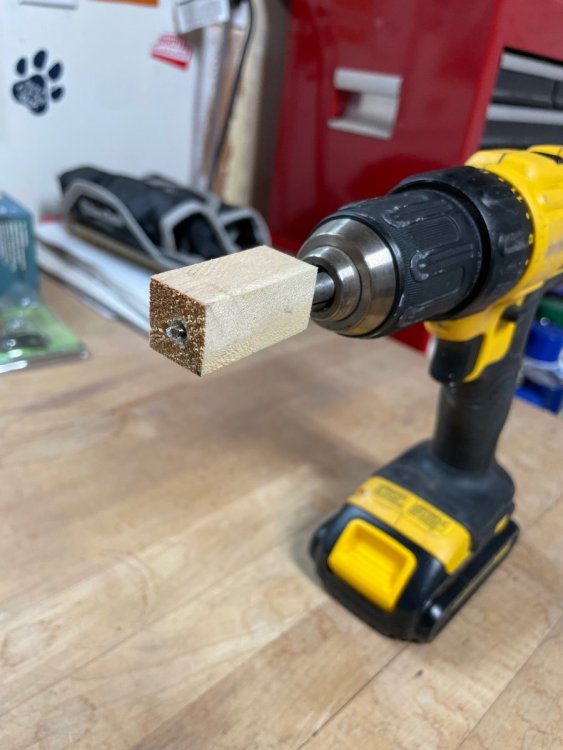

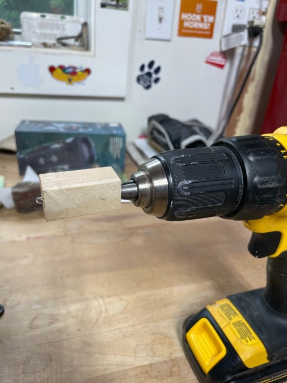

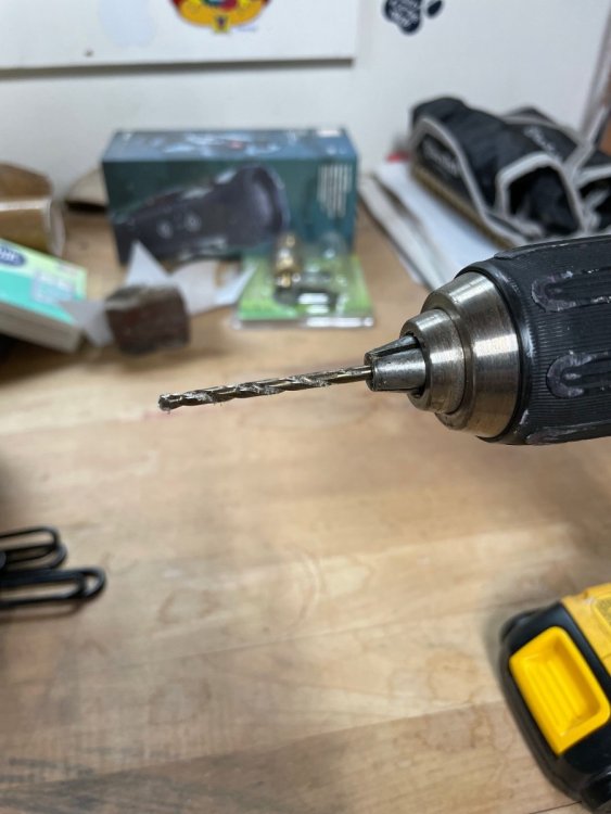

RustyMD Posted May 15, 2023 Author Share Posted May 15, 2023 Follow up and result. I drilled out the rivet. 1/8” bit. I rigged a guard so I wouldn’t go to deep at first. I’ll try to add a picture. The nut was off inside the cover and this was reattached and I applied a drop of removable Loctite. Used the drill bit to push the rivet stem thru the fiberglass above. Lined up the holes and replaced the original rivets with 1/8” diameter by 1/2” length aluminum rivets. 1 3 Robert Youens 2023 LEII Hull #1304 TV 2022 RAM 1500 5.7L Hemi e-torque with tow package Link to comment Share on other sites More sharing options...
