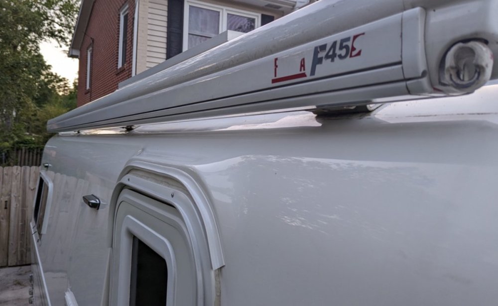

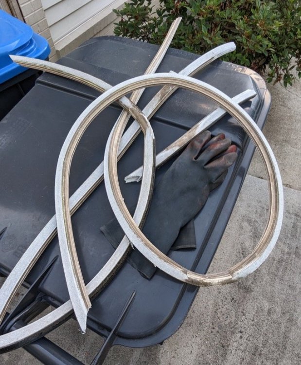

Wow, I'm pooped.  Even with 3M General Purpose Adhesive Cleaner (08984), a 3M Scratch Brite sponge, and flat razor, it was a "BLEEP" to get the sticky residue off the hull.  Thankfully the Bulb seal was only sticking well to half the trailer.  Still took me over an hour to scrub-down and get clean.  There's still grime to pressure wash off, but I think I will like it better than having the seal on the trailer. Time will tell.  I have the new seal on the way, if I change my mind. I have already installed a EZE Gutter Guard over the door, just to keep the door seal, what's left of it, drier. I'm not sure if I will have time to pull off the door and reseal before the rally.  Who wants to help?  LOL 😜
I'm mean, it's not like raising a barn!  🙂
Pro tip:  Putting the Gutter guard in the dryer for 15 minutes with some rags quickly softens up the rubber to make it go around curves easier.  I had no sun that day.
I did mine on a hot day.  I left the EZ Gutter on my black tonneau cover for a half hour or so, very pliable after that.  Mike
HA, I tried the same exact thing, then the sun got blocked by clouds.  Dryer it was.  Hehe.

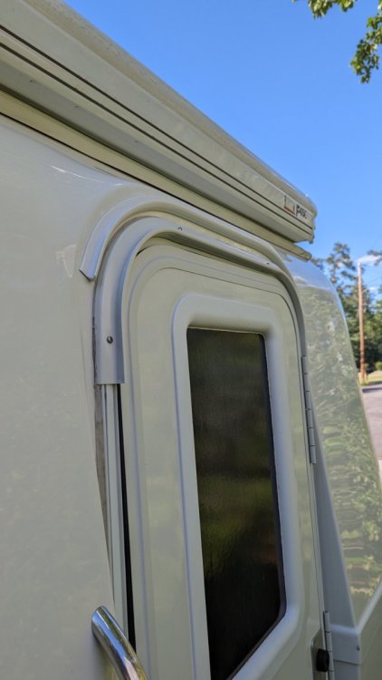

Received my new awning seal from Ryder at OTT Parts Team a few weeks ago, will be installing before our road trip later this month.  I like the idea that @Patriot mentioned about OTT service team dropping the seal down slightly and drilling weep holes in the FIAMMA mounts for drainage.
We will also install the EZ Gutter over the main hatch and windows...  brilliant!

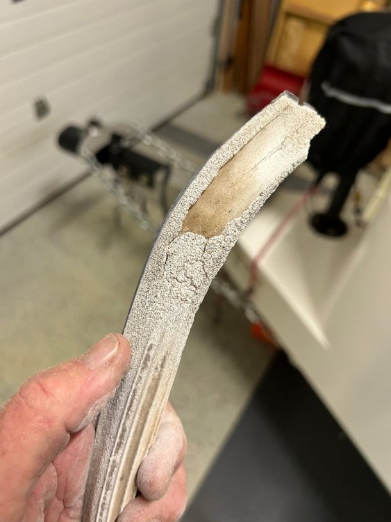

Here's what one end of my bulb seal looked like after I removed it:
UGH!, Nasty!  You can see the oxidized rubber material powder coating my hand...
From an observation stand point of watching how water flows when washing our Oliver, I would not recommend installing the EZ gutter above the awning seal. I honestly do not think you would be happy with this mod post install. If you install the bulb seal properly and it adheres well you should not have any side streaking. Also consider drilling your awning brackets to keep water from puddling.  This made a huge difference after Oliver drilled ours out.
My other thought on installing the gutter guard it will be a very tedious job to remove if you are not happy with it. Naturally debris falls from trees or leaves or pine needles dropping. I try to not park under pine trees or weeping trees when possible.

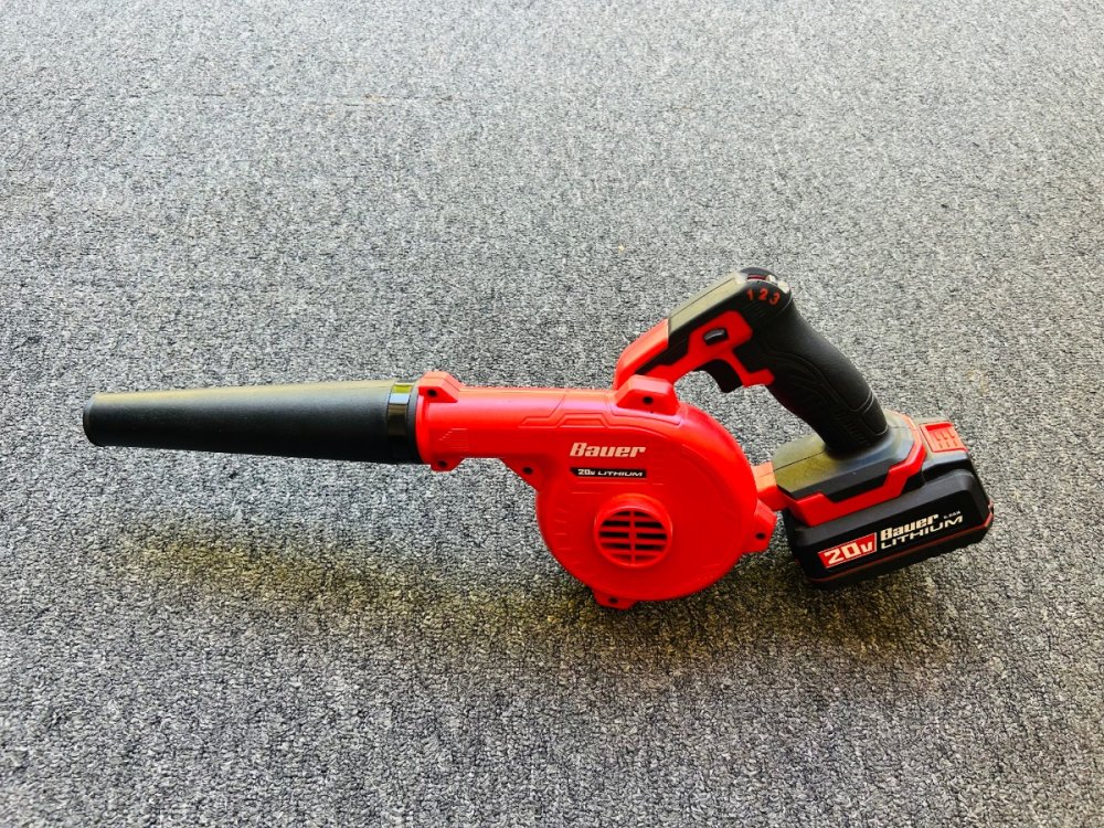

Would a battery powered blower be of any use to keep this area clean before it gets matted down in that area? That was the first thing that came to my mind reading this discussion.

Pulling off and cleaning that Bulb seal was a PAIN.

I just tilt the Oliver nose up a little and just use a strong nozzle water hose and honestly just about everything washes out after a few rinses.
A battery blower would work as long as the leaves are dry. Most dry debris flys off the roof when under way.
My little HF battery powered blower. A great little toy, I mean tool. The broom is retired as this travels well and is fairly quiet. Just go buy one.
