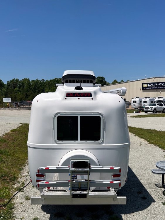

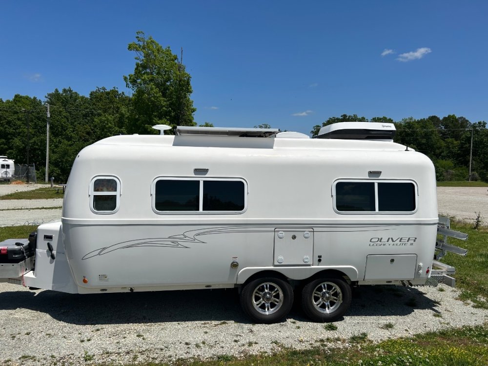

We are very happy to report that our 13500 BTU Truma Aventa AC retrofit was seamlessly completed today. A special thank you to Director of Service Jason Essary, Mike Sharpe, and Tucker the technician that did an excellent job on our install. Just amazing work and we are so grateful.
A Big Thank you to the entire Oliver Service Team!

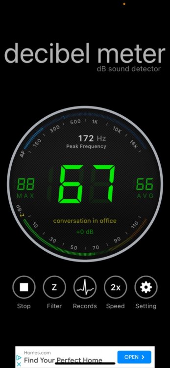

New Truma Aventa decibel reading on high setting.
Former Dometic Penguin on high setting.

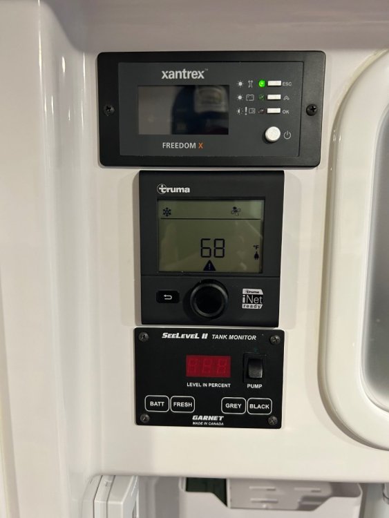

New Truma CP Plus Control panel.
https://www.truma.com/int/en/products/truma-operating-systems/truma-cp-plus

New Truma Pro Plus Control panel.
Do I see in this photo at the bottom left the original thermostat on the wall remaining to control the heater? We're having our Truma retrofit done on June 22. I hope the Dometic thermostat can be left in place.
@MobileJoy
That is not the OEM Dometic digital thermostat you see in the photo. I made a suggestion in April to Oliver to consider using this Honeywell furnace only digital thermostat in the below link. It was approved by their electrical engineers and is now an option when having the Truma retrofit done. Otherwise you will get the Dometic mechanical thermostat. So no Oliver is not using the original dual control thermostat. I much prefer the look, fit, and finish of the digital Tstat below.
This ended up being particularly helpful to me as I presold our Dometic Penguin prior to the retrofit being completed. I needed the original thermostat to sell with the Penguin.
here-
https://www.amazon.com/dp/B00H6ARNXO?psc=1&ref=ppx_yo2ov_dt_b_product_details
Patriot🇺🇸
Just now, MobileJoy said:
https://olivertraveltrailers.com/forums/profile/3243-patriot/,
Did you previously have an Easy Start capacitor? If so, did they remove it, or just bypass it, leaving it in place?
I wanted the ES left in in the Penguin. The buyer of my Penguin wanted it as part of the sale as he has a small genset. Oliver removes the ES along with the Penguin during the retro fit.

So with the retrofit complete, ours runs fine on AC setting using a 20amp circuit.  However we do have a 30amp we plug into in our barn.  We run a 12volt fan and the invertor when we are storing it in our barn.  Has anyone measured the E2 height with the retrofit?
