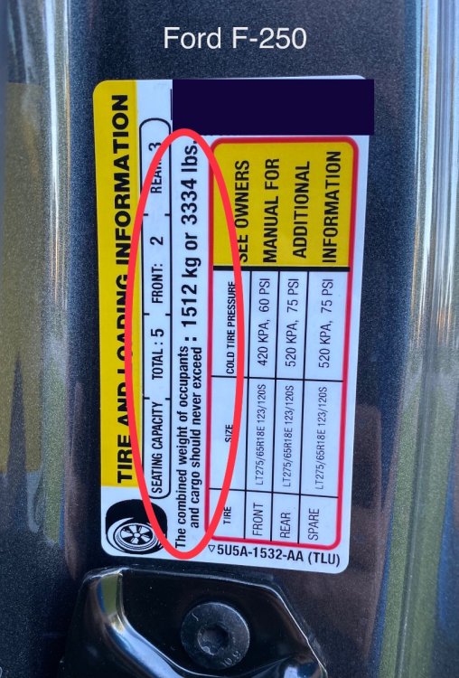

Frank C Posted May 17 Share Posted May 17 There’s some additional info needed in order to answer your question. You didn’t mention the payload rating of your Subaru. There will be a sticker on the driver’s door jamb that looks like the photo below that will state “weight of passengers and cargo must not exceed……”. That will tell you how much weight you can safely put IN your tow vehicle. You must count the tongue weight of the Elite I in that limit. Most calculations assume a tongue weight that is about 10% of the trailer weight. So if you have a dry camper weight of 3700 lbs, plus 266 lbs of fresh water plus 200 lbs of food & clothes, that gives a trailer weight of 4166 lbs, so a tongue weight of about 416 lbs. That tongue weight plus driver plus passenger and anything else in the Subaru count towards the payload limit. Most people with smaller tow vehicles exceed their payload limit without realizing it. 1 2019 Oliver Legacy Elite II - Hull #461 Tow Vehicle: 2019 Ford F-250 SuperCab 4x4, 6.2L Flex-Fuel engine Link to comment Share on other sites More sharing options...
