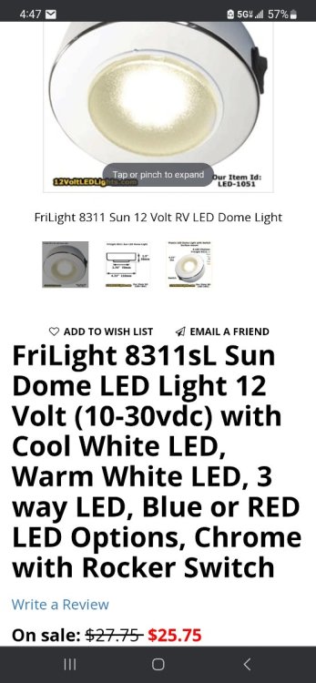

I am not confident that these pictures will show our lights…We have the older style switched puck lights in our Oliver. Road vibration caused the rim to come loose from the main body of the light. Nothing seems broken, and all the tabs on the rim seem to be intact. However, we can’t get the two parts to snap back together. Has anyone had experience with this? Or, does anyone know what brand Oliver used for this style light? I can’t find it online. Thanks in advance.
David
Kim and David Thompson Nomads' Nest 2018 LE2 #366 2018 Toyota Tundra, 4x4, 5.7L
Perhaps a little dab of E6000 on those tabs and then a couple of strips of painters tape to hole everything in place for 24 hours while the E6000 dries would take care to the issue while still allowing for removal if necessary?
