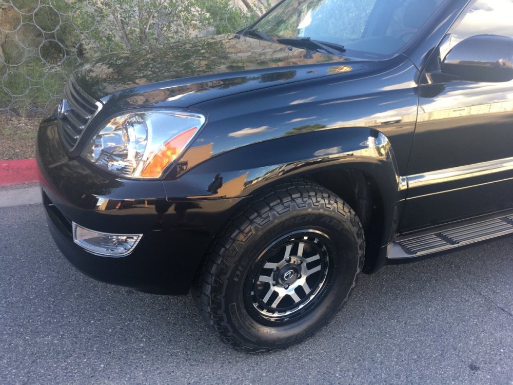

jd1923 Posted September 9, 2023 Posted September 9, 2023 Yep, pulled our Elite II once with our '08 GX470. Not a LX, but a similar Toyota 4.7L v8 (the Tundra 5.7L might work). It was fine around town, with the Anderson hitch, but I could not at all see it going down the 4000 FT drop on I-17 to the Phoenix valley and in the SLOW lane coming back up. Two weeks later, I found an older Ram 2500 Cummins so we can now climb anything! Love the GX on the Arizona dirt when not towing! 1 3 Chris & John in Prescott, AZ | 2016 EII #113 | '01 Ram 2500 Cummins!
