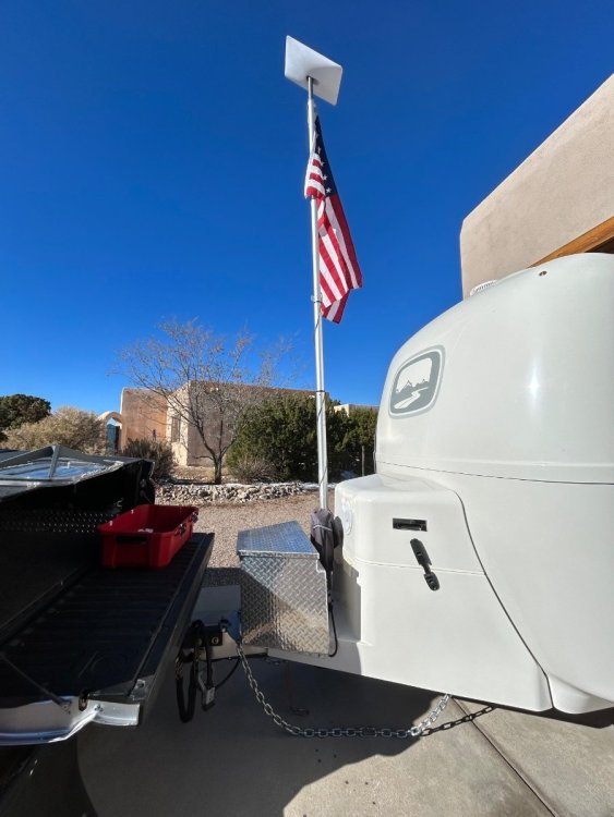

So, since D works from home and spends quite a bit of time on Zoom, Teams, etc., we decided to get into a Starlink-Mobile kit. The kit will allow her to work from Casa Blanca with Starlink's scorching fast internet connectivity and allow us to travel more often.  Today we played around with a proof of concept for using Starlink in our Oliver - there are literally dozens of YouTube vids and deep rabbit holes for ideas of how to integrate Starlink with RVs.
Here's how we'll be lugging is around:
We're using a 12-gallon plastic Husky tote with custom-fit travel pieces from Etsy to keep components from bouncing around when towing.  Its a neat and tidy mobile kit.
Next, we didn't want to use the Starlink-supplied "quad stand" so we modified the top of our E-Z Flag Pole to accommodate the "Dishy" mount that would normally be inserted into the stand.
We inserted an adapter (a 3D print from Etsy) into the top of the E-Z pole so the Dishy just snaps inside.  By drilling-out the upper mostIMG_0441.HEIC flag connector with a step-bit, we're still able to fly the colors.
We used the exterior curbside AC outlet for the Starlink router power connection.  With the inverter energized, it took about 10 minutes for Starlink to connect to its satellite.  Energy consumption varies between 60 and 80 watts according to our Victron Smart Shunt via the Cerbo GX.
The solar modules are generating about 180watts at today's low sun angle, which more than makes up for the inverter/Starlink consumption.
We'll likely put a through-hull connection using a modified waterproof Furrion capped connection (same one OTT uses for the satellite coax connection).  The standard supplied cable is 75' and needs to be shortened anyway - so we'll do that when we install the modified Furrion.
More later...

Great effort. Down the road June likely will need the same set-up.  Some questions:
  • How do you raise the mast?
  • What kind of speed does the system generally provide in "city" and while "remote"?
  • Any wag on the equipment and accessories cost (not counting your time which is priceless of course?).
  • About what does the monthly cost run?
Thanks
GJ

Hey, GJ!  Thanks, brother...  It's a work in progress for sure.  Regarding your questions:
1. The E-Z Pole mast is designed with 4 nested aluminum sections with "twist-to-lock" fittings in each.  To unlock, it takes about a 1/4 turn clockwise.  Push the top section up first, lock, then 2nd, and 3rd.  The pix show the mast at about 2/3 max height, FYI.  The mast configuration gives us more use options - for example, we can use the quad-stand at the house should we lose our Xfinity/Comcast service.
2. I measured the speeds today in on the apron at 225mbs download; 28mbs upload.  Basically faster than our Xfinity service.  However, we've learned through some of the previously mentioned rabbit holes, that speeds vary depending on location.  In some highly dense populated areas speeds can be slower, as Starlink "chokes down" speeds - same goes with remote locations.  A subscriber can pay extra for guaranteed higher speeds.  We've decided to try the basic plan for the time being.
3. The basic Starlink Mobile kit is $600.  The Husky tote was $28 at Walmart.  The custom fit packaging pieces were $50 from Etsy.  The Esty pole adapter cost $15.  We're planning to modify the kit (router) from AC to 12vDC.  Switching to 12vDC drops power consumption by approximately 18%, FYI.  I've already purchased the component parts to make the DC conversion for about $125.  Parts needed are a PoI injector, 12-48vDC converter, and a standalone router.  Easy peasy.
4. The Starlink Mobile monthly service is $150 - but, service is set up as "pay by the drink".  If you're not planning to travel during a particular month, or your rig is in storage mode, you can access you account online and deactivate service.  Only the "Mobile" option allows this feature, the "Residential" plan does not.
Hope all is well on your side - best regards to June...  Cheers!

@MAX Burner nice work on the initial set up as we are considering SL mobile. My only concern is your SL dish mounted on the top of the flagpole. I suppose in high winds you can lower the dish for a more rigid pole mount. Is it really stable enough to handle a sudden wind gust?  I am thinking about an aluminum awning bracket mount.
Thoughts?

Love the flag pole mount concept, we have a similar pole configuration. How is the coax routed up the pole? Just wonder if the flag will get caught up in the wire.
I was considering the same type of mount only for a shortwave/GMRS base antenna setup.

Totally get y'all's concerns.
The key requirement for us was to get the Dishy off the ground and still be able to use it without the OTT.  The EZ Pole and mount is robust - 4 nested aluminum tubes.  High wind conditions would require striking the colors, lowering the dish to the 6.5-foot position and thus keeping it off the ground. FYI, in snowy conditions, the user can select the snow melt mode (more energy) via the SL app to keep accumulation at check and maintain high signal strength.
There are flat mounts available for SL that we've studied - but once its flat-mounted on the roof, you're committed to that application - we wanted flexibility to use SL if we were tent camping, for example.
As noted, we're also interested in a 12vDC conversion and shortening the proprietary CAT6 SL cable to save a bit of energy - but that's down the line.  We want to log some more trips in the current mode first so we're better able to make an informed decision on what best meets our needs.
Thoughts?
Apologies, @Patriot, for the delayed response.
Regarding the EZ-Pole with Dishy mounted during high wind conditions - could be an issue if extended to the entire 24-foot max height.  The Dishy antenna is not a huge sail by any stretch - in fact, it's quite sleek and aerodynamic in a tilted position.  We experienced high wind conditions in Quartzsite last week, the pole height was lowered to the 6.5-foot lowest setting, no issues - the down/up internet speed remained constant during the windy conditions.  Our thoughts regarding the Dishy pole placement was simply to get it off the ground and out of the way.  The height of the Dishy doesn't improve or speed up internet signals, but it could be beneficial in avoiding obstacles.  In sustained high winds, we'd likely opt to place the Dishy on the quad pod in a protected area such as the truck bed.
If you and your lovely bride aren't concerned about having a dedicated SL kit for "XPLOR", our recommendation for y'all would be to modify the antenna such that it could be flat mounted on its roof.  Roof real estate being a premium, the antenna dimensions are 12" x 20.25", so depending on your roof configuration, there should be a clean install location up there.   FYI, there is a downloadable file available to have a low-profile plastic housing 3D-printed to encapsulate the antenna and its internal components.  They're doing this all over the Ukraine and SL antenna shells are literally cast aside along the roadways!
However, some may not have the stomach to "not-so-surgically" separate the antenna from its shell - after all, it is a $600 piece of kit that would no longer be under warrantee by Elon.
Our's should be rigged-up by this afternoon and tested - so there will be more to share later on...
Cheers, brother!

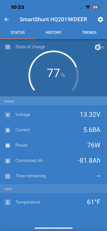

STARLINK 12vDC Conversion UPDATE #2:
While after 5+ hours of "final install" steps, we're about 90% complete.  Todays efforts include the following:
1. Power Switch:  Determine SL power switch location, drill 1/2" hole in bulkhead, pull supply, ground, and load wires.  Connect switch.  Green LED illuminated indicates that SL kit is energized:
2. Prepare "Closet-end" ethernet cable with an RJ45 shielded connector.  Test the continuity of the ethernet cable from the Dog House connection to the Duely circuit board inside the closet with remote tester:
Above pic show the rolling continuity test between Dog House and (below) closet end:
3. Mount Components:  Roughly mounted components in general area of need with blue painter's tape.  Final locations of component will be adjusted slightly for best wire runs.  Planning to use a strong double-sided "carpet-type" tape for final install:
(L to R) Components are 12 to 5vDC power converter which supplies power to mini router, next is the back of the power switch, then the mini-router - power cord and SL ethernet cable visible on bottom of unit, finally - the workhorse of the mod... the "Duely Dishy 12vDC to 48vDC power supply and Power over Ethernet (PoE) injector.  Visible on the Duely is the red LED "ON" light, the mini router cable on top and below, the SL Dishy ethernet cable from the antenna atop the EZ-Pole:
4. Prepare the power supply wires:  Turned main battery bank switch to "OFF" which is located inside battery compartment.  Connected positive (red) 12AWG stranded to main bus from battery bank below aft dinette seat/pantry area. "Anderson-clipped" an inline 10amp fuse (recommended by Boondocker.oi) as close to the bus as practical.  Connected negative (black) 12AWG to the main negative bus which feeds into the Victron SmartShunt.  After double-checking SL power switch LED "OFF", turned main battery switch to "ON".
5. Energize the SL Kit:  Ever watchful for the release of the magic smoke from black boxes, selected the "ON" position of the SL power switch.  Got the green LED to illuminate - good sign.  Peeked inside the closet - no smoke, another good sign.  Opened the SL app and followed the connect procedures - exactly like with the 120vAC router configuration.  The system behaves in the same manner with the 12vDC mod.  Waited a few minutes for the system to go through its satellite connection protocol.  Selected "Casa Blanca Starlink Kit" on the iPhone, Settings, Wi-Fi, which was programmed into the router yesterday during the test set-up drill.  Ran the speed test and got 209up/12.5down - good sign, yet again.
6. Check energy consumption:  The CERBO S GX registers our baseline (no systems in the OTT on) background/phantom wattage consumption at 8w.  With the SL energized and connected and all other systems "off" the energy consumption registered 52w.  So, that's indicating that the SL kit is pulling 44w.  This is lower than we thought as during CERBO readings with the 120vAC/Inverter tests averaged about 70w, that's about a 37% decrease in energy using the 12vDC configuration.  Not bad - another good sign.
FULL DISCLOSURE:  Today's plan was to have the components full mounted and system tested, frankly, I ran out of gas - the components in the closet will still be there tomorrow when they get permanently fixed to the bulkhead.  Oh well, it's time for a cold one, friends!
Cheers...
