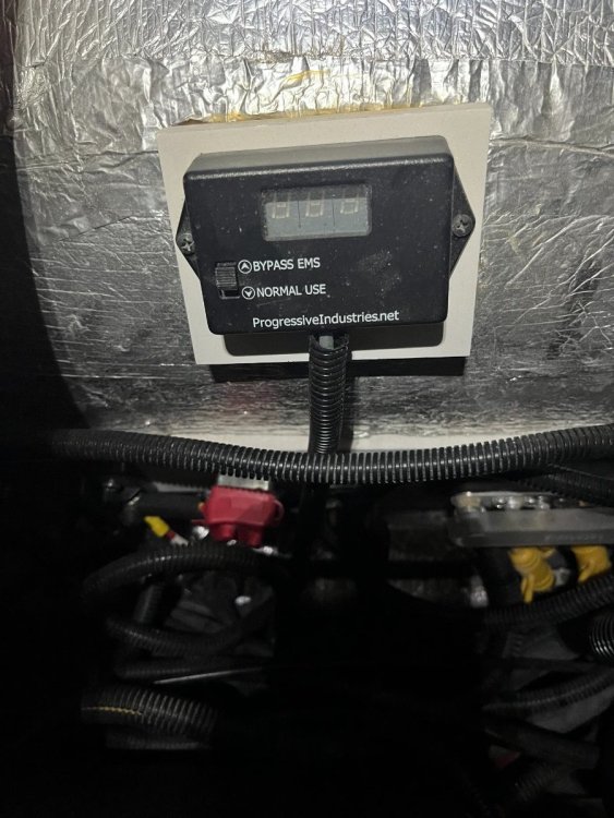

Moderator+ ScubaRx Posted December 26, 2023 Moderator+ Posted December 26, 2023 There is a switch on the EMS display that will allow power (from any source) to bypass the EMS. You can feel reasonably confident that the power coming from your own generator is safe and switch the bypass on so you can at least get power while you're figuring this all out. I can't see any reason that what the RV repair guy did could have caused this. I assume you're using the front generator hook-up. There's a transfer switch (under the front dinette seat) that SHOULD activate once it senses power being applied to that port (you should hear a click from the contact points inside). If the transfer switch is bad that would be the problem. 3 Steve, Tali and our dog Rocky plus our beloved dogs Storm, Lucy, Maggie and Reacher (all waiting at the Rainbow Bridge) 2008 Legacy Elite I - Outlaw Oliver, Hull #026 | 2014 Legacy Elite II - Outlaw Oliver, Hull #050 | 2022 Silverado High Country 3500HD SRW Diesel 4x4
DonnaDuane Posted December 26, 2023 Author Posted December 26, 2023 Yes. Using front generator/shore power hook up. Excuse my ignorance but where is the EMS display? When I look in the compartment there’s a little box with a led display and a switch. I’ve tried flipping the switch but nothing changed. The usual click when the system switches from battery to AC didn’t happen. 2018 Elite TV - Audi Q5 3.0 TDI

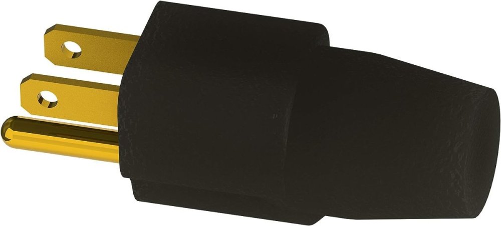

Rivernerd Posted December 26, 2023 Posted December 26, 2023 43 minutes ago, skalywag said: Are you using a Bonding Neutral plug with your generator? Sometimes referred to as an "Edison Plug" A neutral bonding plug plugs in to one of the 120V receptacles on your generator. It looks like the image below. Your Oliver electrical system will not accept power from a generator without one: 1 2 Hull #1291 Central Idaho 2022 Elite II Tow Vehicle: 2026 Ford F350 Crew Cab with 7.3L gas engine
DonnaDuane Posted December 26, 2023 Author Posted December 26, 2023 Yes. have been using a Bonding Neutral plug since I got it. I have been using the generator for power to the trailer for the past 5 winters, as that's when I use the Oly most. I take it skiing. I just learned from Service that I need to record the messages on the EMS LED when switched on. It displayed an error message and some other info. I checked the circuit breaker panel for issues and found none. Thank you for your suggestions and keep them coming if you know how to get this thing working again. 2 2018 Elite TV - Audi Q5 3.0 TDI

DonnaDuane Posted December 27, 2023 Author Posted December 27, 2023 Seems some of my posts are not showing up here. I posted the following last night to see if any of you know that this means. When I run the generator the LED on the EMS switch lights up, so power is getting to that switch. However, still no power to trailer. When it's switched to the ON position, I get the following codes: 128, OA, 60H, E2, PE2 Just spoke with Oliver. Here's what I learned. Those codes are saying either the Neutral Ground plug is faulty, or the surge protector is faulty, or the connection to the bypass switch is faulty. He recommended having an RV Tech check it out after trying a new Neutral Ground Plug. Duane 1 2018 Elite TV - Audi Q5 3.0 TDI

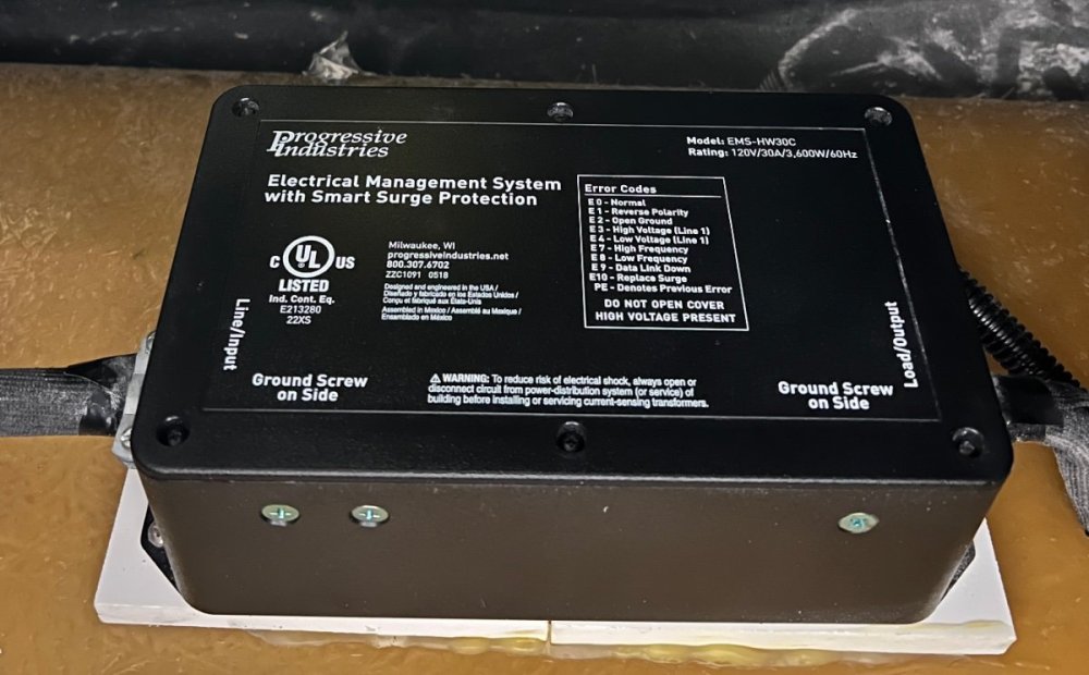

rich.dev Posted December 27, 2023 Posted December 27, 2023 @DonnaDuane here is a list of the EMS codes, looks like open ground! this box should be under your rear dinette. Check out this thread, sounds like (might be) your ground bonding plug is faulty, so either get a replacement neutral ground bonding plug, or turn off the EMS and trust the generator. IF it’s a faulty ground bonding plug, a replacement bonding plug is not that expensive, that would be my go to. Stupid question, did you check if the ground bonding plug is seated properly in your generator? 3 **Sold😞** 2023 Elite II, Hull# 1386, Lithium Platinum Package (640AH, 400W Roof Solar, 3000W Xantrex Inverter), added 400W Renogy Solar suitcase with Victron MPPT 100/30 CC, Truma water heater & AC TV: 2024 Silverado 2500HD 6.6L 10-Speed Allison
