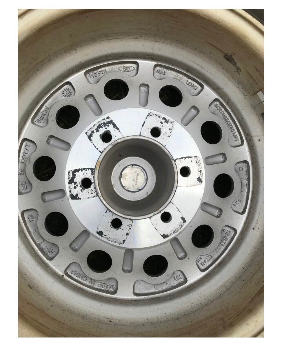

Here’s a photo of the inside of my original 2017 (hull 208) wheels. You can zoom in and see all of the specifications including the 110 psi pressure rating and load rating for the wheel! I took the picture when the trailer was new and filed it for future reference.
Good decision, Bill. Looks like you're upgrading in Load and PSI rating. I believe the ones you're buying are the 4th row on their website table, 15"x6" with a 6/5.5" bolt pattern. Big improvement at 3200 LB @ 95 PSI ratings! Not that we need a wheel that strong. That 60 PSI on the OEM wheels gets me. S20-56655T-2+ 101073 S1050-425CC / 46879 15X6 6/5.50 0 4.25 3200 @ 95 PSI

This is the fact I got mixed up. I’m going to have to see what’s printed on our OEM wheels. So OTT put 60 PSI wheels on Hull #75 in 2015! Does your hull have a DOT sticker stating 80 PSI! Mine does.
- Yesterday
John, The original 5 wheels on my LE2 were ION wheels with 60PSI maximum air pressure in the casting, following photo. I finally decided to install four 15" Sendel S20T trailer wheels replacing the original ION wheels next year, instead of refinishing the original ION wheels. https://www.sendelwheel.com/wheels/s20t.html This is the 15" Sendel S20T with Goodyear Endurance ST225/75R/15 tire on the right that replaced the original 16" ION spare wheel with passenger tire on the left, both fit in the smaller fiberglass spare tire housing that will not accommodate a LT225/75R/16 tire/wheel assembly. Bill
