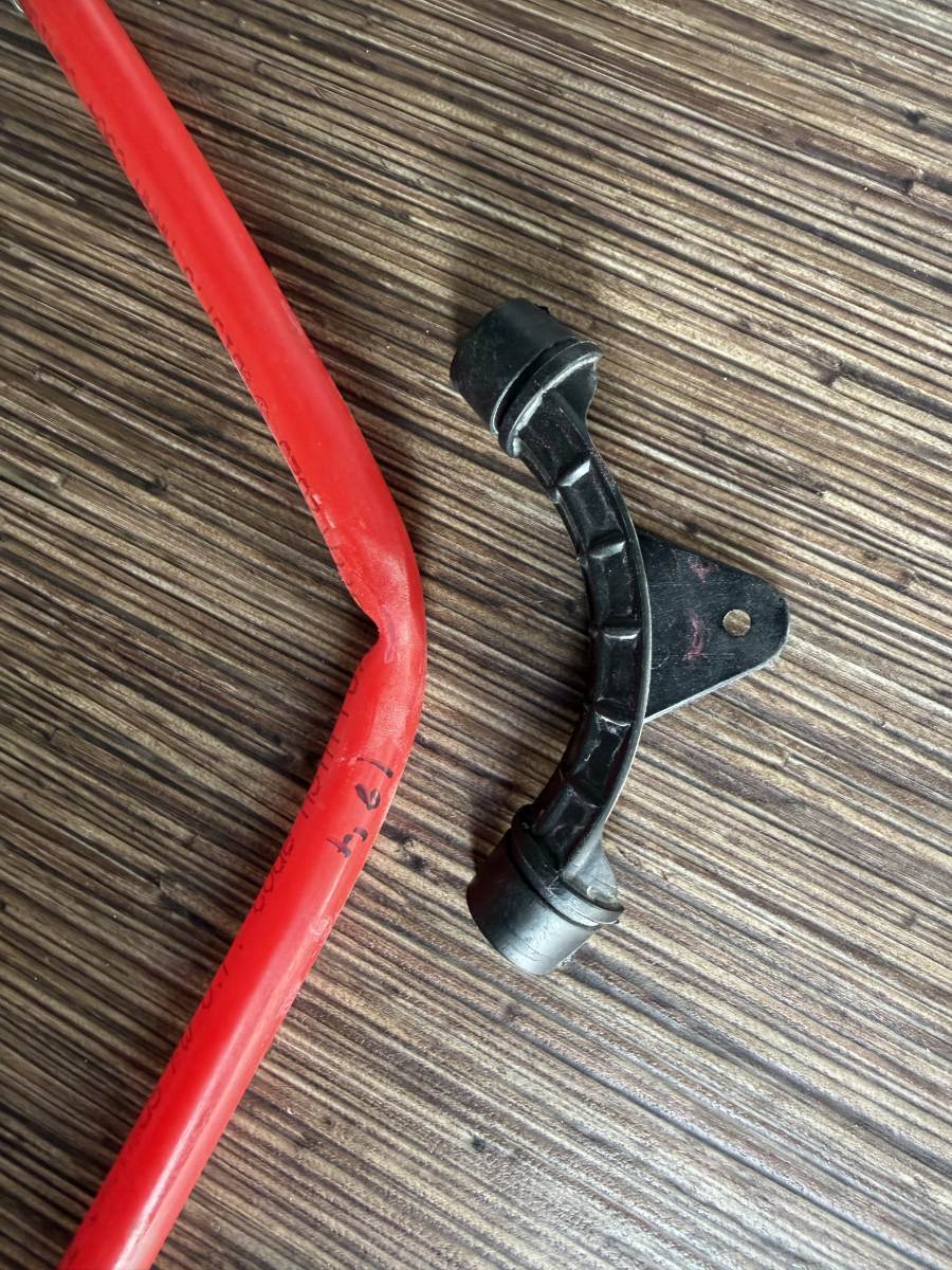

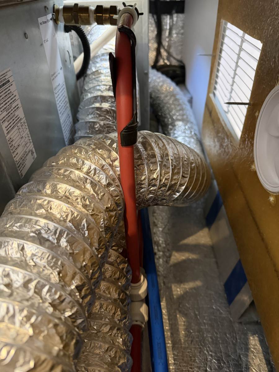

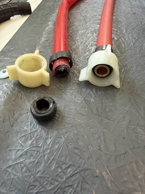

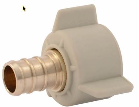

I'm posting for an anonymous 2017 Ollie owner. This is why we should NEVER leave our trailer with city water on to the trailer. I need to remember this too, or just use fresh water tank with pump off when leaving. He heard water flowing under the bunk when hooked up to city water and found that the 1/2 inch plastic swivel adapter going to the water heater, under the passenger side bunk, had broken off. Easy fix, but only if you had the Pex tools and parts with you. The trailer would have flooded with that much water pressure going into hull. Here are some pics. He also found out why, in his 2017 ollie, he had low hot water pressure (a kink). Time to put a straight and right-angle brass swivel adaptors in my plumbing bag. Spend a few more bucks to save the rig from being an indoor pool.

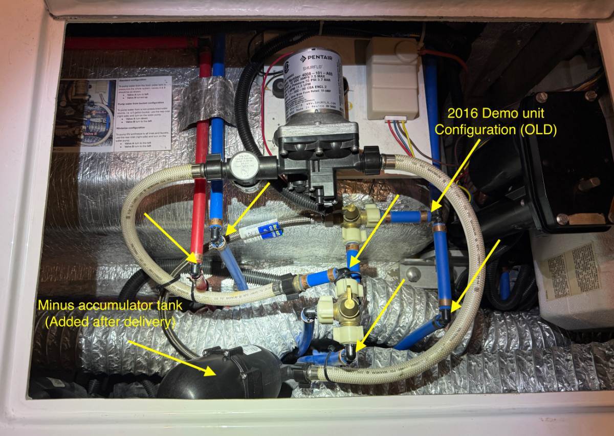

This is what we got in 2016. Matches the configuration for hull # 145. Hope this helps. Scotty PS good seeing you at the rally. -

Hey folks, I recently saw that Jenni & Omar have a 2017 rig, and they have a nice plumbing diagram in their manual. I do not have that same type diagram in my 2016 manual (paper or digital), likely because my hull was the 2016. demo unit, so maybe too early. My plumbing fittings in the main area are also VERY different than their hand-tightened connectors (large white fat fittings - all lose by the way). Did anyone with a 2016 (pre-fat white fittings) get a plumbing diagram with their 2016 trailer? Does your wet bay look something like mine, with the same simple fittings? We can never assume they are the same, even for the same year trailers, but I was curious. Minus the accumulator tank, which I added later, this is what my water area looks like. Again, note the solid Pex fittings. So far, they've never YET broken or sprung a leak, but I did not just say that. If you have a plumbing diagram or two of the entire rig, can you scan or take a nice picture with your phone and send to me, or attach to this thread? I have already checked the Oliver digital library. Thanks,
