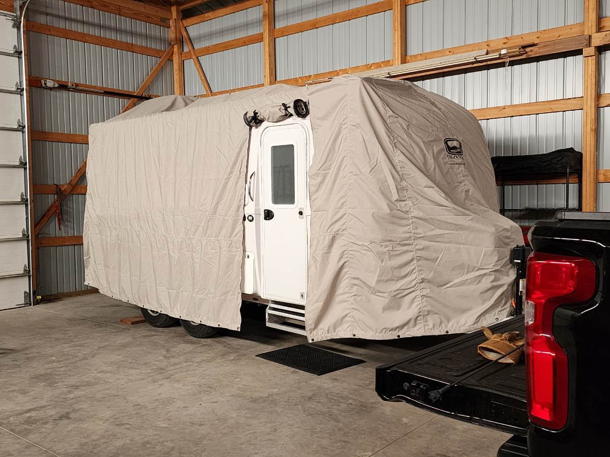

  2. It may be overkill but similar to @Patriot , I use the Calmark cover inside. Keeps the dirt off during storage so come season everything is clean and ready to go. Glad I bought one at the price I did when OTT still had them even though I don't desperately need one. My most desired Oliver upgrade is to get a ceramic coating - someday.
