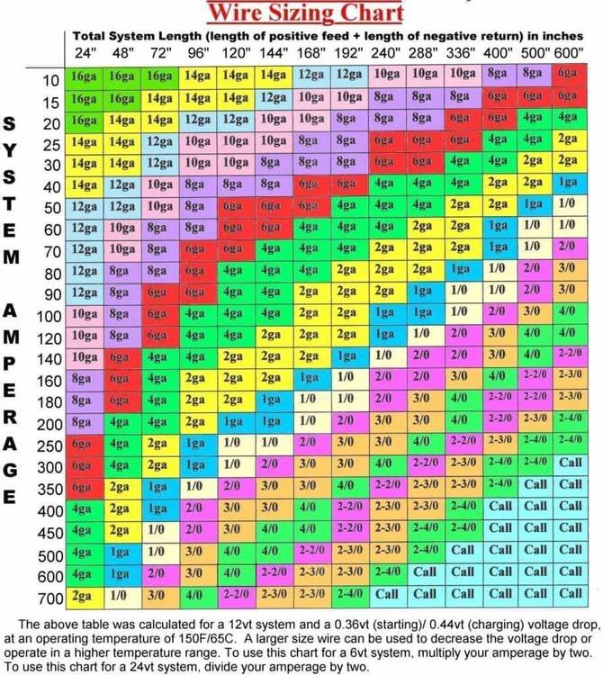

I don't see any margin in fact they're below spec (see table). This table only goes to 600" which is 50 ft and roundtrip for DC-DC wiring from the battery bay in the Oliver to the starter battery in a full-size truck is closer to 80 ft. The tables are ultra conservative being concerned for voltage drop which is less of a concern in RV charging. But STILL! Note row 3 where 20A on 12 AWG wire is only good for a 120" or a 10 ft run. They want 4 AWG for 20A and 1/0 for 50A. I went with 4 AWG wire for the 50A Orion on a cost basis when some were warning get 2 AWG. It is what it is. The 7-blade wiring is only 12 AWG. You'll fit right in here! 🤣 Got my hydraulic crimpers and cable cutter when I first got into this 2 years ago! (Used once on eBay). You'll have a new hull and can order your options. So, you won't have the 20 +/- mods I've done, but perhaps a few regardless. -

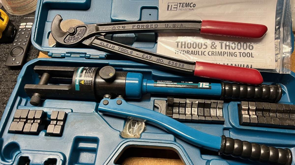

Thanks for the info! Seems odd they would design an unsafe system, and they must have some margin. At the very least the fuse would blow hopefully before any smoke. But this would lead to a bunch of service calls they would have to deal with. Don't even own the trailer yet and thinking about mods already and I always wanted an excuse to get pair of hydraulic crimpers. But, before I get mod crazy, I'll wait to see how we camp first. How hard was it to run wires in the TT? Is there a bulkhead where the trailer wiring goes into the TT to fish the wires or do you have to drill holes? -

Charging on the "7-pin connector" has come up now twice in two days! (see "Rich Solar" post). Not sure why OTT would think to install a 20A DC-DC charger on the 12 AWG black (aux) wire of the 7-blade coupler. For years, they had been disconnecting that wire on lithium installations. I'm pretty sure 20A is too much current for 12 AWG wire over the roundtrip distance, truck alternator back to the trailer house batteries! Yes, you are correct! 10A can run on 12 AWG, I believe for 20A charging 10 AWG is required (so the OTT DC-DC charger installation is truly unsafe)! Your delivery is next year. If it was me, I'd ask them to skip this "DC-DC charger" installation. Or have them do the trailer side of a proper DC-DC installation with dedicated wiring. IMHO, the black/aux wire should be disconnected in all travel trailer installations, given the trailer has house batteries. Most DC-DC installations run dedicated 4 AWG wire (or heavier) for a 50A charger. We have been averaging +40A on the road. And yes, I upgraded our truck alternator to handle the extra amperage. @Chuck and Beth, who already has the new DC-DC charger installed by OTT, has set theirs down to 10A to be safe. For us +10A charging is nowhere near enough. Say you have OTT's best Lithionics 640 Ah batteries installed. A 10A charge will give you +1.5% SOC for every hour towing. So 40A provides +6% SOC per hour. Wish we had the new 70A Orion but boy-oh-boy copper wire is about as expensive as diesel fuel is these days. 🤣 -
