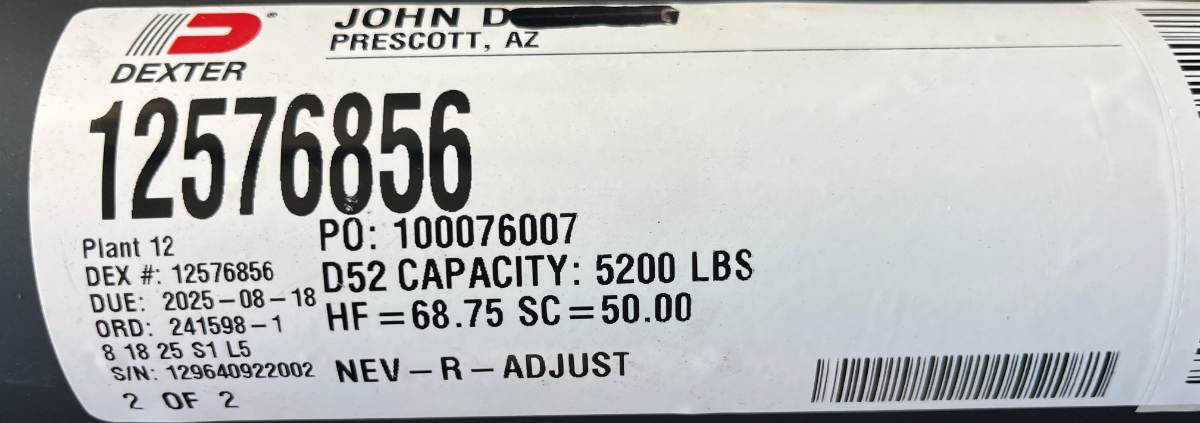

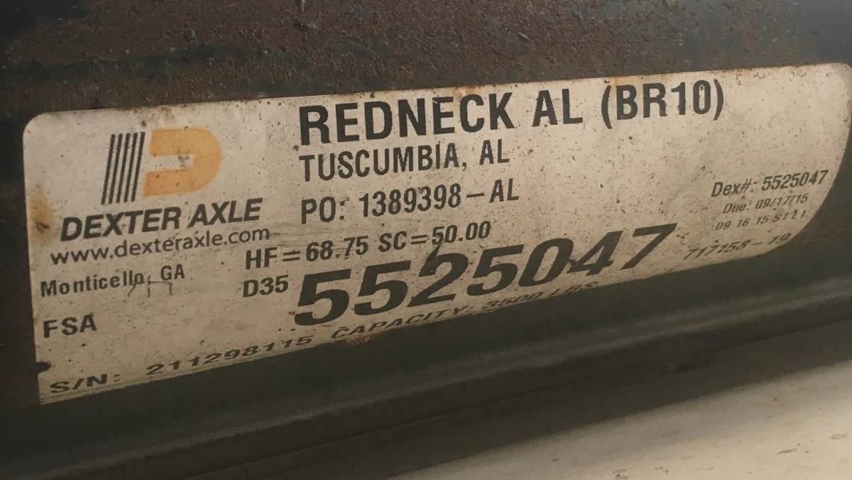

Not all Oliver TTs use the same axle. Our older hull was fitted with a 50" bracket length and most others have 50.5" (note the 50.00 marking on my labels). Since the axles on our Oliver were unique, Alcan took a picture of my original axle label and in their custom order, copied all the specs except went from D35 to D52 for 5200 LB axles. They only make Nev-R Adjust and Nev-R Lube axles now so the rest will be the same. So, the part numbers for our hull will NOT be what you need, but take a picture of your axle label and then call Dexter Customer Service. They are not bad to talk to and the will give you a proper part number for your D52 upgraded axles.

Sorry I checked my quote from Alcan and part # not there either. We ended up sticking with our original 3.5k’s as we had just put in new brakes and bearings. I suggest you ask Alcan when you order your springs as they’ll have that p/n for sure and it will need to match for the spring order. They also know the axles lead time by heart! Craig -

I have tried to run through all xxx-hundred posts on this subject at least twice. I still cannot find reference to the actual Dexter part number of the correct D52 axle for my E2. My Olly (615) unfortunately has the old 3500 axles and cheap CCP springs. I intend to have the work done locally. I have ordered the correct ez-flex and shoulder bolts from e-trailer, will order the 5 leaf springs and U-bolts from Alcan. I want to have the local shop order the correct complete axle assemblies directly from Dexter. Would someone please chime-in with the correct part number for the Dexter Axle? Pretty please with a shot of single malt... Bill
