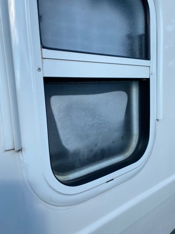

As the weather has changed our Ollie has developed a moisture buildup between the two layers of glass in the double pane sliding window in the bathroom (see photo). It comes and goes, and if the weather is hot enough with no cool nights or rain, the moisture does dissipate a bit, but never completely, so obviously a failed seal between the two panes of glass. For anyone else that’s had this issue, or other related window issues like a broken glass pane, can just the lower sliding window section be easily replaced? Or does it require replacing the entire window assembly? Just trying to decide if it’s worth fixing or just live with it. Thanks in advance.
