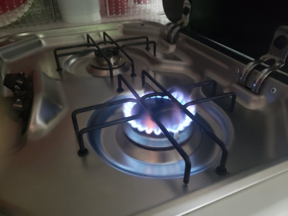

I think you probably have a little blade electrical connection for the piezo igniter. That needs to be lined up. If you can use a flashlight and mirror to see if the gas tube and jet haven't moved, you're probably good to go. The gas tube and jet are the only gas supplies. The alloy base and cap are useful, but just sit around and on top of the jet. As far as disposable, i looked around when my big burner gave me fits. The cooktop Oliver uses is (i think) smev, now owned by dometic, but still sturdy smev, and I would have ordered it if I couldn't fix mine. Probably the best available, usa. My old smev caps are screwed in, and make cleaning an issue. So, that's a tradeoff. If you travel bumpy roads frequently, take the caps off before you close the lid, and put them in the top drawer til you need to use the burners. At least, that's what I would do.

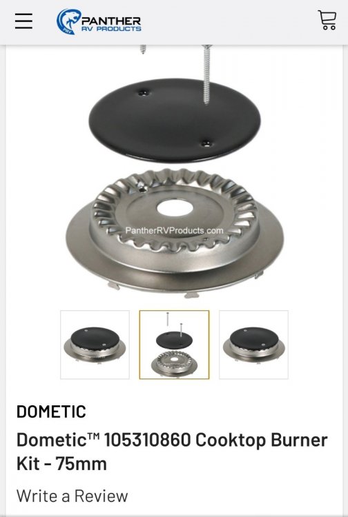

If your burner is like my smev, the pieces you've shown don't actually carry any fuel. There's a little gas jet, attached to a fixed gas tube, that supplies the fuel. It looks like a small, thin brass nut. (Mine is 11 mm, I think.) The alloy base plate with the ridges supplies air to the jet, "spreading " the flames. My guess is the base plate is attached by a couple of machine screws from the bottom, meaning you'd have to remove the cooktop to reattach it, like the small burner. The stainless steel cap is not fixed on yours. Mine is held on by old, stubborn, corroded and stripped screws.
