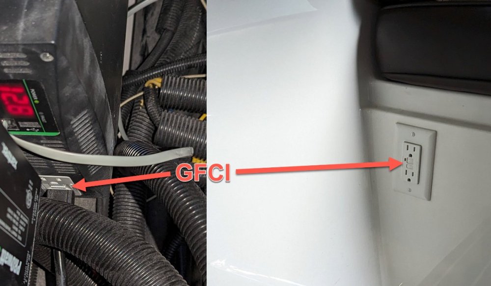

Well, I cannot believe it took me this long to find the issue with my intermittent brakes after Oliver failed to put on new axles for me last year. Since then I've been dealing with my RAM disabling the brakes periodically. No rhyme or reason... (known to me). At least three or four of you folks here would have found this sooner than me, I'm sure of it. As suggested by some, I verified all ground wires going inside the trailer from the brake bundle on the drivers side (only for snugness). I have even replaced all brake bundle connectors, some I did twice just to be sure (today). But the good thing is I learned a great deal, and I found a ton of wire connector corrosion along the way. Even the 7-pin connector (now replaced) was not looking good. But what I DID NOT check was the actual copper wire condition going INTO the negative/ground bus-bar inside the trailer. Well, after checking, re-checking, re-checking again all brake connectors today, and verified voltage to all brakes, I think I found what someone at Oliver had done. See, when they initially removed my axles from #110 last year, in hopes that the new axles would fit my frame (that's another thread), they slapped my old axles back on, and hence re-ran the wires back into the trailer (creating the new issue). Sure I checked for snug negative screws, but I never actually pulled out the wire from the bus-bar. Look what I found today. After fixing this "mess", and ensuring the sheathing was not inside the bus bar, my third test drive for the day was a success, but who knows, I've driven four hours in the past, before my truck was bitching about low voltage for the brakes. This had to be the issue, I hope. I was also able to snug up the main nut to the chassis ground, although I know that was not the primary issue. Sigh! -

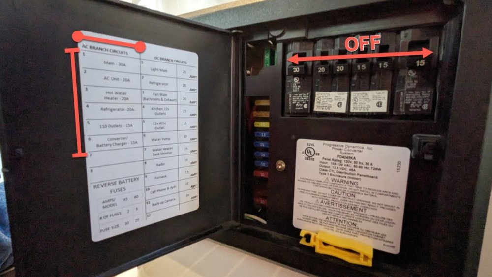

@katanapilot You are not confused any more than I was at first. There are THREE major subjects being discussed, too much for a single forum thread. 1. We have a common situation where Automatic Transfer Relay (ATR) has melted down a bit causing a power outage from Shore power. This box switches from shore power receptacle outside to/from the front Generator 30A receptacle (by front jack), but ONLY if you opted for the front power plug/receptacle (an add-on at build time). The old style ATR box commonly melts down on the plastic bus bar or actually catches fire inside the box (usually a small flame). Most folks get rid of the old ATR box and replace it with the one I have pictured above. (New part # PD5110010Q). In the past two years I know of at least four of these old boxes catching fire or melting down. You would smell plastic/rubber burning. NOTE: If you do not have a 30A receptacle in the front of the trailer, by the front jack, then you do NOT have an ATR box. There is not need for an ATR at that point since you only have a single shore power receptacle next to the battery box. 2. We also have a discussion about a power converter charging the batteries. The AC charger is in the breaker panel box (part # PD405-CSV). I have already upgraded mine, as many have, to be able to charge certified Lithium batteries, but I have not changed over to Lithium yet myself. 3. Lastly there is talk about the inline Transfer Relay Switch (TRS) which provides automatic switching between shore power and the inverter AC source. My TRS is a Xantrex PROwatt SW Inline switch, Part # 808-0915. Not sure who has what in their older trailers these days, but I still have a 2000 watt Xantrex inverter in my trailer, which I have replaced once as well. The inverter provides AC power from the batteries when shore power is not available, so we can still have hot coffee in the morning from our electric water kettle and blow our aging hair with a hair dryer. LOL FYI, if you are plugged into shore power at a campground, there is no need to have the inverter powered on. It will do nothing for you. In my case, the Prowatt TRS detects shore power, and switches to using that to provide you AC electricity, versus getting AC from the inverter. Assuming everything is working correctly. These could all be dedicated threads and likely are in the forums somewhere. I hope I do not add to the confusion. I too was confused at first over all the subjects spoken about.

@taylor.coyote It sounds like you have an RV tech on the way. That's the best I think in your situation, especially if you are not familiar with these parts, and on the road without all the tools. As @John Dorrer mentioned, many of us owners with older Olivers have had to replace their Automatic Transfer Relay (ATR) switch, AND SHOULD!!!! I've attached my pic of the old style box (insides) and my new style switch box. I changed out the box myself (with shore power disconnected!!!!). It took me maybe 20 or 30 minutes. I've also noted in my pics that my front shore power receptacle does NOT go thru my Electrical Management System (EMS) box. Many do have their front port going thru the EMS, mine was just not done like that at the factory, which proved handy last year in the hot July whether in Georgia, when my EMS kept over heating and switching off. I think it's time for a new one (to-do list). But, I always carry an external EMS to place on the exterior camp ground pedestals. When I realized it was not the camp ground killing the power and it was my EMS, I just used the front inlet port to run the power and used my external EMS for the rest of the trip. Worked like a champ. So, I guess I will NOT re-route that front port thru the EMS in the future, lesson learned. Not everyone has that front port. If folks do not have the front inlet power generator receptacle, then they will not have an ATR box. Hope this helps a bit, and you get help quickly. Reminder, the ATR switch box should be an annual inspectable item. I just checked mine too since I could not find my old pictures. My old box was very difficult, and scary, to push in the sides of the box to release the tabs. The new box is MUCH easier to push in and release the tabs. Here is the new style ATR switch box (I only order this type of important items. from eTrailer, NOT Amazon: https://www.etrailer.com/RV-Transfer-Switch/Progressive-Dynamics/PD5110010Q.html
