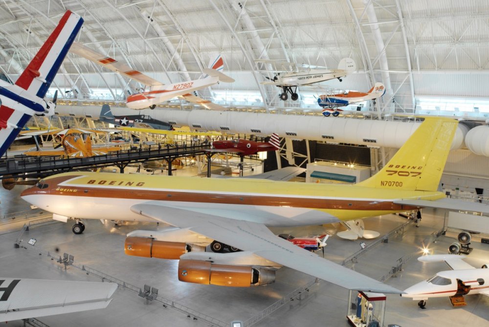

Zef, Here is a picture of the 707 Prototype in the Udvary Hazy pavillion of the Smithsonsian at Dulles airport. I was the Flight Engineer on the airplane when we flew it from Boeing Field in Seattle to the museum in August of 2003. This is the airplane that Tex Johnston did the barrel roll with at Seattle Seafair in 1954.
