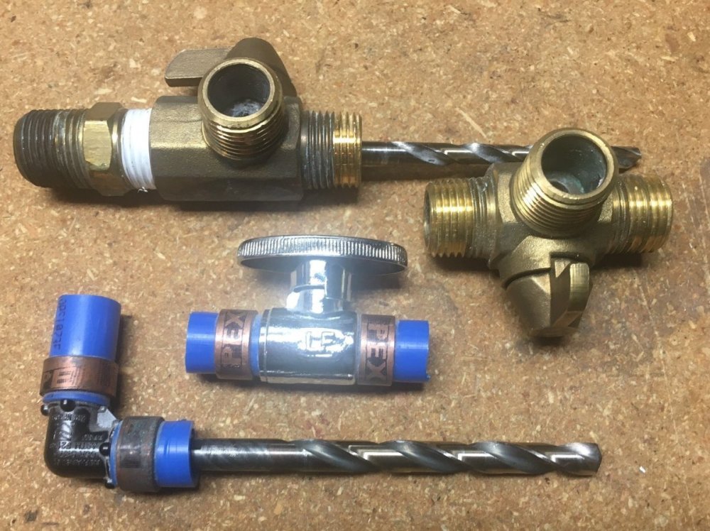

jd1923 Posted March 23, 2024 Posted March 23, 2024 5 hours ago, HDRider said: Tipping the front of the trailer as high as I could worked for me. I also open the valve on the last leg of the trip home. It is a finicky operation. You can have the front of your TT 2-3 FT above the rear and if the drain valve is not seated on the floor, your Fresh Tank can stay half full! (See my post above.) I made a comment about leaving the drain open in another thread and was warned of the authorities not liking that. We do it on roads less traveled, or just drain in our driveway while unloading. Our driveway is steep enough. With everything right, why does draining the Fresh Tank take so long? Because the drain valve has a 1/4" ID opening. See my pic, when I had replaced all OEM valves with motorized ball valves. Those are 1/4" and 3/8" drill bits to illustrate ID size. Every PEX connector reduces the 1/2" pipe to 3/8" and all the valves installed in our 2016 hull had 1/4" ID. Our motorized drain valve now has a 12mm opening which allows the tank to drain in half the time! Love the motorized valves since they are less restrictive. Also love the convenience of pulling extra water from your TV when the onboard fresh empties after for us 3-4 overnights boondocking. We fill the Fresh tank again and still have another 10-15 gallons for a third fill if needed. We leave home with over 65 gallons fresh water. And when we get home, I drain what's left in two fresh tanks! 1 1 Chris & John in Prescott, AZ | 2016 EII #113 | '01 Ram 2500 Cummins!
Ollie Ollie in Free Posted March 24, 2024 Author Posted March 24, 2024 5 hours ago, jd1923 said: Love the motorized valves since they are less restrictive. That's a great upgrade. 1 TV: 2008 F-350 Crew Cab, 6.4L diesel, 4WD, custom flatbed with storage boxes, Line-X underbody coating OLLIE: 2022 OE1 Hull 885, Lithium batteries (260AH), 230W solar panels, 2000W Pro inverter, Dometic AC w/Easy Start, Truma Tankless Comfort water heater
jd1923 Posted March 24, 2024 Posted March 24, 2024 All the details are here: Chris & John in Prescott, AZ | 2016 EII #113 | '01 Ram 2500 Cummins!
