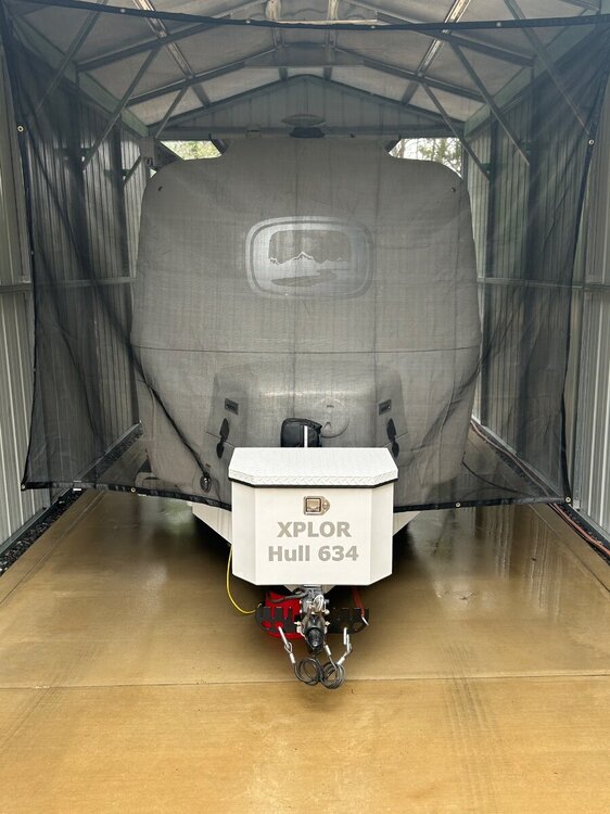

I recently sold my used cargo box and purchased the Sea biscuit custom locking cargo container and am very happy with it. If I were looking to add a cargo box I would seriously consider this option. It’s more money but you do get a lot more dry lockable storage and it’s very well made. David Hess the owner of Sea biscuit and his team craft fine products built to custom fit to Olivers right in Tenn and they ship. There are other much less expensive cargo box options as well.
If you opt to order from Sea biscuit you will need the Ubolts and plates from Oliver to secure the box. Mike Sharpe at Oliver Service can sell and ship you what you need. We store ALL of our immediate go to set up gear in this box with room to spare. It leaves plenty of extra room in our TV bed. David & Kristine Hess will be at the rally if you plan on attending. We are very happy with our cargo box!
