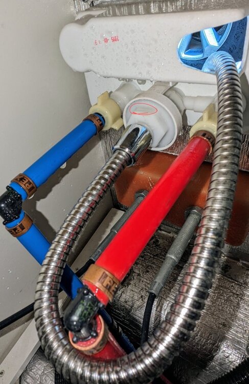

Moderators Wayfinder Posted May 5, 2024 Moderators Posted May 5, 2024 Well, of course I had no time to conduct a proper PMCS (Army maintenance check) on the Ollie until 6 days before departure. Retirement can't come soon enough. Now I see the outdoor shower faucet assembly is cracked inside the hull. I noticed it while bleeding air out of the lines. Water was poring out of the weep holes in the hull and water dripping over the wall into the basement compartment. Oh well, not a show shopper. Only leaks if outdoor shower is turned on, which I seldom use. Hopefully Camping World (yuck) will have the part on hand. If not, oh well. After the the rally. Maintenance, maintenance. #110 is showing her age. Maybe I will do a YouTube of it, we'll see. Chris o-o 2016 Legacy Elite II (demo) - Hull #110 -"Rock'in 110" o-o 2024 Ford F-250 Lariat, 7.3L Godzilla gasser o-o Augusta, Georgia

jd1923 Posted May 7, 2024 Posted May 7, 2024 Hulls 110, 113,117 are all old girls! The crack must have come from fighting with the hose. I’ve been using ours quite a bit lately and the hose will often not fully extend. From your pic, I can see it’s getting caught on the hot side PEX! I’m going to cover or wrap that plumbing with something so the hose can be pulled out unhindered. hope you can source the cracked part without replacing the entire faucet assembly. 2 Chris & John in Prescott, AZ | 2016 EII #113 | '01 Ram 2500 Cummins!
Moderators Wayfinder Posted May 8, 2024 Author Moderators Posted May 8, 2024 (edited) On 5/7/2024 at 1:17 AM, jd1923 said: Hulls 110, 113,117 are all old girls! The crack must have come from fighting with the hose. I’ve been using ours quite a bit lately and the hose will often not fully extend. From your pic, I can see it’s getting caught on the hot side PEX! I’m going to cover or wrap that plumbing with something so the hose can be pulled out unhindered. hope you can source the cracked part without replacing the entire faucet assembly. I was also thinking of Jerry Rigging cloth strip of something to better support that silver show hose, to take a bit of pressure of that plastic fitting. Also, I will likely add line marks or colored electrical tape (yellow, then red) as the... "do not pull any farther out" warning markers. Will work for me. I will likely add a bit more silver insulator material on the walls around that shower faucet area. Just to help a tad bit more keeping things warming in lightly cold weather. I always keep extra insulator inside the faucet box, inside the door, just to "attempt" to improve thermals. The new part is on order from the dreaded Amazon. Camping world did not have the exact part, and I wanted exact if I can get it. Edited May 8, 2024 by Wayfinder 1 Chris o-o 2016 Legacy Elite II (demo) - Hull #110 -"Rock'in 110" o-o 2024 Ford F-250 Lariat, 7.3L Godzilla gasser o-o Augusta, Georgia

jd1923 Posted May 8, 2024 Posted May 8, 2024 3 hours ago, Wayfinder said: I was also thinking of Jerry Rigging cloth strip of something to better support that silver show hose, to take a bit of pressure of that plastic fitting. Also, I will likely add line marks or colored electrical tape (yellow, then red) as the... "do not pull any farther out" warning markers. Better than tape would be some kind of donut clamped to the hose, so that it cannot be pulled too far. 3 Chris & John in Prescott, AZ | 2016 EII #113 | '01 Ram 2500 Cummins!

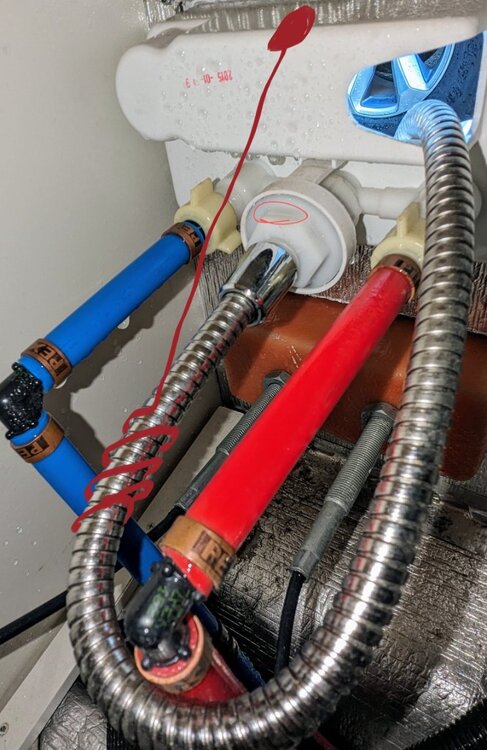

Moderators Wayfinder Posted May 9, 2024 Author Moderators Posted May 9, 2024 After looking at my picture of the faucet, I think I'll try some support using the faucet housing itself. Something like this I suppose. Chris o-o 2016 Legacy Elite II (demo) - Hull #110 -"Rock'in 110" o-o 2024 Ford F-250 Lariat, 7.3L Godzilla gasser o-o Augusta, Georgia
Ronbrink Posted May 10, 2024 Posted May 10, 2024 17 hours ago, Wayfinder said: After looking at my picture of the faucet, I think I'll try some support using the faucet housing itself. Something like this I suppose. Or just a simple cradle resting across the two adjacent pipes. Ron and Brooxie | Clear Lake (Houston), Texas 2020 OLEll, Twin, 579: No installed solar, dual 30# propane tanks w/GasStop safety devices, Renogy 40A DC-DC charger, 460Ah LFP battery bank/Victron SmartShunt, auxiliary Cerbo-S GX/Victron 30A Blue Smart IP22 Charger combo, interior mounted Hughes Autoformer, twin independent sliding Lagun mount tables, extended dinette table and pantry landing, tongue-mounted hoist, Beech Lane refrigerator Ventilation/Evaporate Coil fans, metal valve stems with TST cap sensors and signal repeater, Waste Master sewer hose management system, Dreiha Atmos 4.4 A/C upgrade/Ceilo Breez Max thermostat, FlagpoleBuddy Starlink Mini suction mount kit. 2019 GMC Savana 2500 Cargo Work Van: Explorer Limited SE, Low-Top 7 Passenger van conversion, 6.0L V8 Vortec, 6-Speed Automatic, RWD; Air-Lift LoadLifter air suspension/WirelessAir compressor; Bilstein B6 4600 Series shocks; metal valve stems for TST tire pressure monitoring system; Buyers Products cargo containment boxes/DC Cargo securement system; rear bumper DC-DC Anderson power cable outlet; 100Ah 12V portable power station/Dometic CFX 75L Dual Zone cooler; front 2” receiver hitch/QuikrStuff Mach2 double bike rack; Mechman 320A high output alternator; Starlink Mini/Veritas Vans magnetic mount.

Moderators Wayfinder Posted May 10, 2024 Author Moderators Posted May 10, 2024 6 hours ago, Ronbrink said: Or just a simple cradle resting across the two adjacent pipes. I considered that, but then I could hear someone, rightfully so, say it would put too much stress on those Pex pipes. If those leak, there's no stopping the leak without killing the water and pressure in the lines. If the faucet likes as it has, it only leaks when using the outside shower. Not a bad compromise. The part is actually suppose to arrive this afternoon, so I might be replacing it at the rally. Something fun to to do. 1 Chris o-o 2016 Legacy Elite II (demo) - Hull #110 -"Rock'in 110" o-o 2024 Ford F-250 Lariat, 7.3L Godzilla gasser o-o Augusta, Georgia

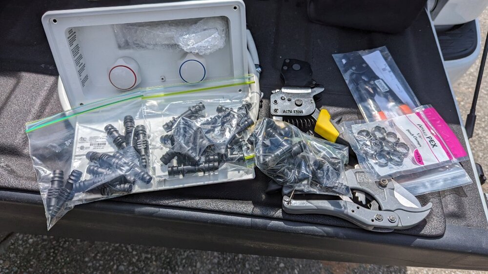

Moderators Wayfinder Posted May 10, 2024 Author Moderators Posted May 10, 2024 I'm looking forward to replacing the outdoor shower, but it will have to wait until I get to the rally. Part just arrived. Q: Can you make a deck chair from PEX piping, like all the things you can make with PVC? LOL. Just kidding! 3 Chris o-o 2016 Legacy Elite II (demo) - Hull #110 -"Rock'in 110" o-o 2024 Ford F-250 Lariat, 7.3L Godzilla gasser o-o Augusta, Georgia

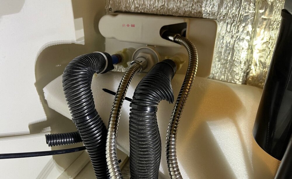

jd1923 Posted June 7, 2024 Posted June 7, 2024 On 5/10/2024 at 12:40 PM, Wayfinder said: I'm looking forward to replacing the outdoor shower, but it will have to wait until I get to the rally. Part just arrived. Upon inspection, mine has a light surface crack just where yours is located. Surface only, no leaks, so hope it stays put. I did some work to keep the shower hose from getting caught on the PEX or elsewhere. With parts on hand, I wrapped automotive plastic loom over the PEX and a large section of foam under the plumbing. It it very difficult to get your arms back there to fix the wire ties. I pulled it out and back in 5-6 times and got the full length out each time smoothly. Hoping I'm good now and the hose will not get caught anymore. Chris, have you had time to get your new shower kit installed? Chris & John in Prescott, AZ | 2016 EII #113 | '01 Ram 2500 Cummins!
