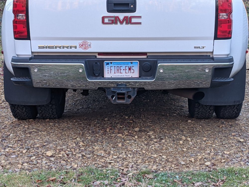

Steph and Dud B Posted November 6, 2021 Posted November 6, 2021 We have semi-rigid mud flaps on our dually, right behind the rear tires,approximately 9” above the ground. Adequate protection for the Ollie? Stephanie and Dudley from CT. 2022 LE2, Hull #1150: Eggcelsior. Tow vehicle: 2016 GMC Sierra 6.0 gas dually 4x4. Our Oliver journey: Steph and Dud B's RV Screed Where we've been RVing since 1999:
John E Davies Posted November 6, 2021 Posted November 6, 2021 34 minutes ago, Steph and Dud B said: We have semi-rigid mud flaps on our dually, right behind the rear tires,approximately 9” above the ground. Adequate protection for the Ollie? Define “adequate” please, are you hoping to drive on gravel roads and freshly chip sealed highways? If yes, then no they are not adequate by themselves, but if they are combined with a second set at the rear bumper, such as Rock Tamers, then they will be pretty good. The second set needs to come way out, to take care of those outer tires. And they will be a trip hazard and knee knockers, unfortunately, especially in the dark. You might want to add some reflective tape to the support arms. John Davies Spokane WA SOLD 07/23 "Mouse": 2017 Legacy Elite II Two Beds, Hull Number 218, See my HOW TO threads: Tow Vehicle: 2013 Land Cruiser 200, 32” LT tires, airbags, Safari snorkel, Maggiolina Grand Tour 360 Carbon RTT.
Moderators topgun2 Posted November 6, 2021 Moderators Posted November 6, 2021 1 hour ago, Steph and Dud B said: We have semi-rigid mud flaps on our dually, right behind the rear tires,approximately 9” above the ground. Adequate protection for the Ollie? If you stay on paved roads or go VERY slow on gravel roads then you will be OK. Otherwise - do what JD says above - Rock Tamers or the like. Bill 2023 Ford F150 Lariat 3.5EB FX4 Max Towing, Max Payload, 2016 Oliver Elite II - Hull #117 "Twist" Near Asheville, NC
Moderators SeaDawg Posted November 6, 2021 Moderators Posted November 6, 2021 We've used rocktamers for over a decade. We still go slow, on gravel. 2008 Ram 1500 4 × 4 2008 Oliver Elite, Hull #12 Florida and Western North Carolina, or wherever the truck goes.... 400 watts solar. DC compressor fridge. No inverter. 2 x 105 ah agm batteries . Life is good.
