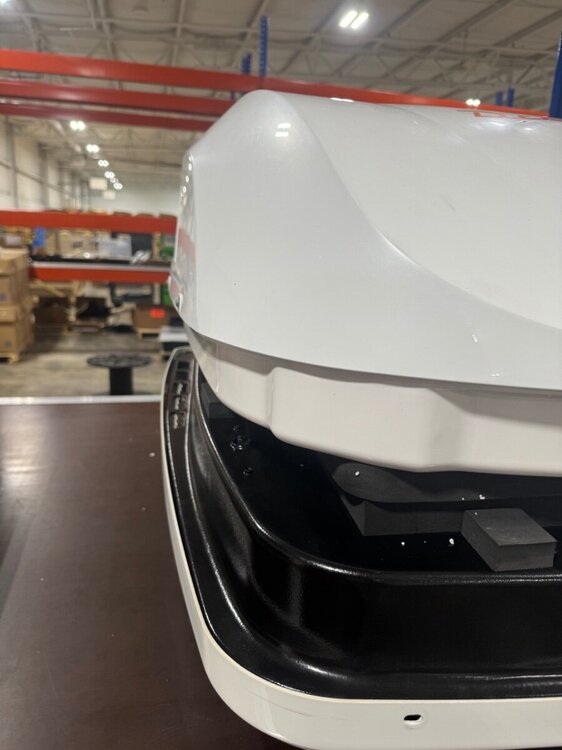

sdgelkhart.com, $1350 delivered was my quote. See pic for a forum to visit to obtain in depth information on the Atmos 4.4, including installation and performance testing videos.

Looking forward to someone installing the Atmos 4.4 (Gree, Tosot, Eco cool) unit. Looks great from what I read on the Sprinter van thread.
Compared to the Dometic PII it has almost the same footprint and weight. 2 1/2 inches longer in the back.
No condensate pump or line connection (drains onto the roof)
Remote control and WiFi thermostat available. Should make for easy install. Also, app controlled.
Quite a bit more efficient on shore power and batteries.
Very quiet!
$1350 shipped. Not including soft start if needed. (Single or small battery bank). Or cheaper depending on which brand you get off of Amazon, etc.
Definitely interested.
@Ronbrink and others let us know how the install goes.

@Ronbrink From what I understand, they all use R-32 due to Gree being the manufacturer for them all and then they are distributed under different labels depending on market.  Which is great since R-410A is going to be retired and R-32 is much more efficient. Thanks for making us aware of an exciting new option.
@Shawna and Scott From what I have seen it will work perfectly due to having almost the exact same footprint. Curious to see pics of first install on an Oliver.
