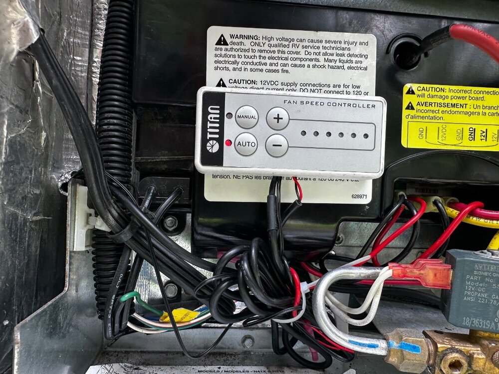

Often toggle switches terminate the ground and will NOT show 12VDC. I never tested mine, since when it was ON there was no power to the fan even when bypassing the thermal switch. I ran new wires. I used the main switch to connect ground to the new Beech Lane fan circuit.
i suggest new wires everywhere. I cut off all the old blue and red 20 AWG wires and replaced with automotive grade 14 AWG wiring. Pics above and I’ll keep an eye here for any questions as you progress with your mod.

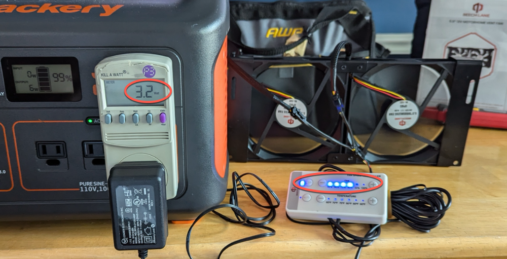

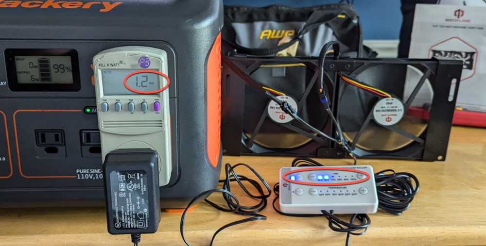

I have not installed the Beach Lane Twin fans yet, but I did just verify they work and noted how much they use per manual setting, at least indoors with ambient temps around 75 degrees. There are impressively quiet, even at 100%. And they move some serious air.  Make a nice decorative wooden enclosure and they'd be better than any desktop fan you could buy.  Would keep you cool at night for sure!  Hmmmm!
  • Speed  - Watts Used
  • 50%  -  0.6w
  • 60%  -  1.2w
  • 70%  -  2.05w
  • 80%  -  3.2w
  • 90%  -  4.6w
  • 100% - 6.6w

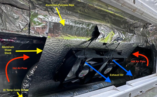

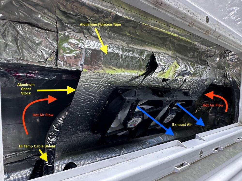

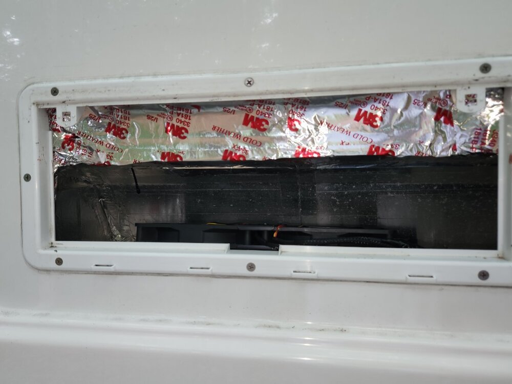

Added a cooling fan following many other installations in our 3 way Norcold.
Fan mounted by bolting onto a shall sheet of screen door panel from Home Depot.
Air flows up from the heat chamber around back side of the panel and forced out vent slots by fans.
Unit held in place with high temp furnace aluminum tape.
Used high temp race for wires down to the bottom chamber where the control is mounted and wired into +12 / GND.
Hope this helps anyone else doing a similar mounting process.
Pix 1: Upper Vent area:
Fans wouldn't fit directly onto vent cover due to space, so I chose to mount it at an angle that blows the hot air directly out the vents (which are slanted that direction).
Wiring in the controller to the +12 and GND took a bit of cable splicing and re-building.
In hindsight, if I'd had 3-way cable crimp connectors it would have been easier to wire in the controller.

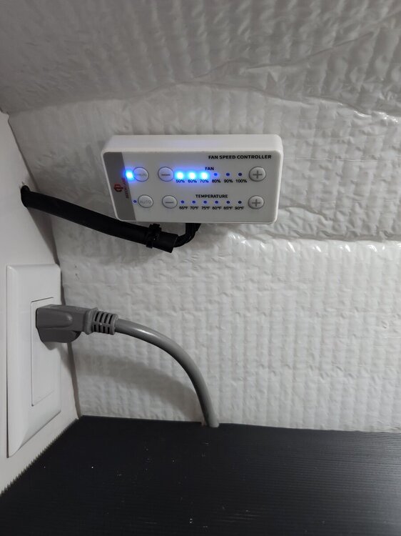

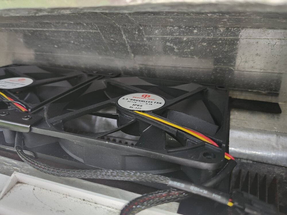

Finished the install.  A somewhat complicated project but definitely helped by all the great info posted in this thread and elsewhere.  Thank you very much!
To summarize:

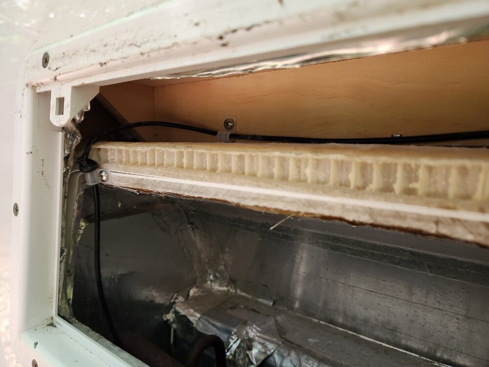

As the brackets supplied by Beech Lane weren't going to work in our 2021 LE2, hull #701, I rearranged the fans to bring the cables to the front and then fabricated a mounting bracket from some ABS sheet I had in my shop.  ABS is great stuff, nearly indestructible and easy to glue with ABS glue (a mix of acetone, MEK, and dissolved ABS.  Don't drink it.). Nothing else works, including epoxy.
The fans and bracket sit atop the space, let's call it a plenum for simplicity, in which the 'fridge coils reside. The rear longitudinal piece, which has foam tubing on it in the final version (not shown) sits snugly in the vee of back wall.  The tabs on the lateral pieces sit atop the hull honeycomb behind the grille surround and are screwed vertically into the honeycomb with 8x1 1/2" stainless sheet metal screws.  The fan assembly isn't going anywhere.

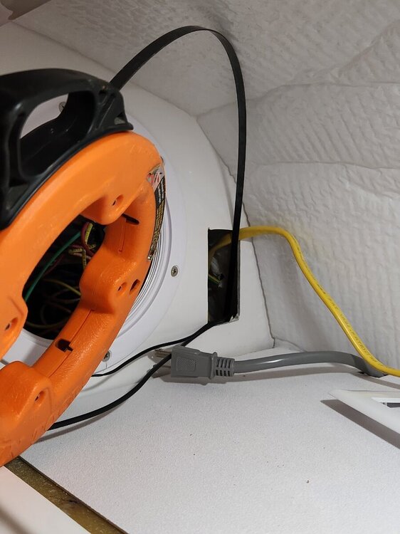

The three cables from the controller run through a new 1/2" hole drilled in the cabinet wall and downwards.  One you find the right spot with the fish tape it is straightforward to push the cables & tape downwards until they are visible from inside the plenum.
The fan power cable and connector are routed to the right, wrapped in electrical tape, and secured against the wall using 3M 3340 HVAC tape.  From there it passes through the bubble wrap insulation and up to the area to the left of the upper cabinet, behind the 6" round access panel and switch panel.  It is necessary to pull the bubble wrap insulation and original HVAC tape away to access this space from inside the 'fridge upper vent area.
Meanwhile, the controller and fan power wires are routed across the top of the vented area and secured to the plywood.  It is necessary to remove a piece of foam secured by HVAC tape to access this space.  From there the power wires are routed down the aft side of the 'fridge coil space and secured with cable clips.
As suggested by @RonbrinkI spliced the power cables into the existing +12V and ground by removing about 1/4" of insulation, wrapping the fan power wires around the 10 ga. 'fridge power wires, soldering them in place, then covering with shrink wrap and electrical tape.  The power cable supplied by Beech Lane is too short to reach all the way down to the bottom of the 'fridge so you'll need to add length if you go this route.  I used 18-2 cable from a big box store.  The OEM Beech Lane cable is like 22-2 and somewhat difficult to solder, so be forewarned.  The controller & fan power wires were secured with cable clips and 8x1/4" stainless sheet metal screws.
The temperature sensor was provisionally mounted in the upper aft part of plenum and secured with 3M HVAC tape.  Not sure whether that's the best place or not yet, it may be better off further down the plenum.  The pink foam which had formed the front wall of the uppermost part of the area behind the upper grille was replaced and secured with HVAC tape.
Last, the controller was mounted to the rear wall of the cabinet using heavy duty Velcro.  I used two 1/4" wide strips of hook material on the back of the controller and two 1" squares of loop material on the wall.   There's no need for more than that as the controller weighs very little and using more hook material will just tend to pull the loop material off the wall if and when you need to move the controller.  We'll see, we're not going anywhere 'hot' until February when we'll be in central Florida.

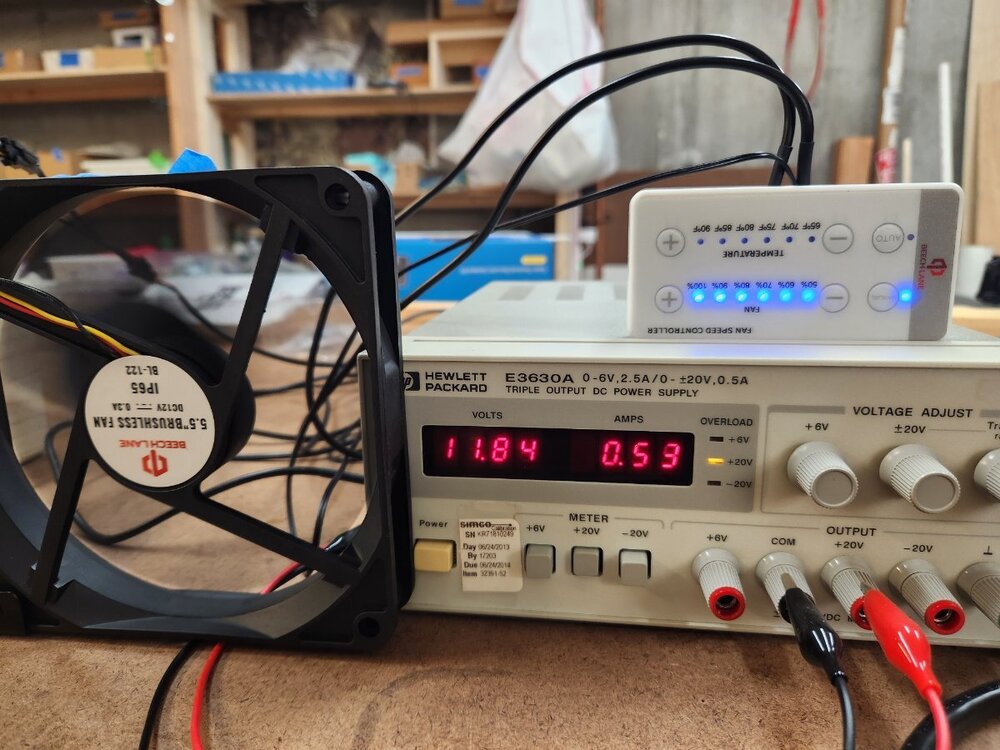

Bench testing showed about 0.6 A draw, or the amount shown on the fan label, when the fans were set to run at 100%.
Thanks to everyone and I hope this helps.

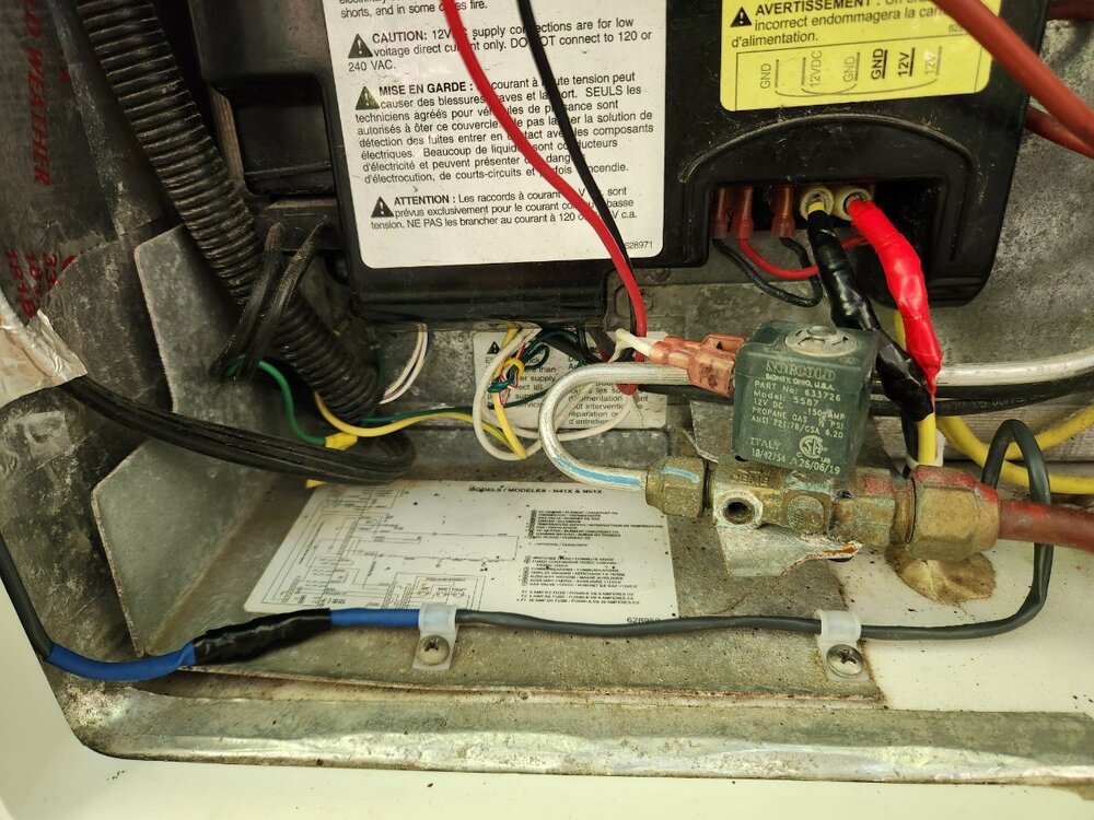

Forgot one.  You can see the black & red power wires for the existing fan (mounted on the coil fins) rising vertically from the control box.   Perhaps it is thermostatically controlled.  I'd didn't bother to figure it out.

Nice installation! Did you add the bubble insulation in the upper cabinet or did it come like that? My attic has the same exposed on the rear wall in 579.
Edited by Ronbrink
2020 OLEll, Twin, 579:
We did not add that, but it is possible the prior owners did as they did a lot of deep winter camping.
Thanks
Tim
2021 LE2, hull 701
I have the titan fan system, but the controller was defective.  Just been running it in manual until the fans die.  When  in use, my fans run 24/7 at a moderate speed.
Will be replacing it with the already purchased Beech larger fans.  My plan was to mount them in some sort of manner to create a ducted fan approach.  Thus eliminating teh flow of outside air into the top vent area.  This would allow a lower fan speed to get the same amount of cooler air flow from the below vent.
Your picture closely approaches this concept.  Best I have seen so far.  I also like your use of the thin sheet alumnum. Easy to work with and inexpensive to boot.
It appears from the picture that you have covered about 3/4 of trhe width.  So I would call it a mostly ducted approach. I am wondering why you didn't just cover the full width to move all their discharge to be hot air from the frig, not a mixture of hot air and cooler air from the sides being sucked in the top vent?
 Concerning the control module placement, I'll likely be using JD's approach and mount it inside the upper cabinet.
Concerning the power source, WAGO is the "way to go" since I have already done this for the Titans.  But for a first time install another owner may want to check into the existing fan power source ...if it is active when the frig is on.
Creative ideas you have emplyed and thanks for the post.
