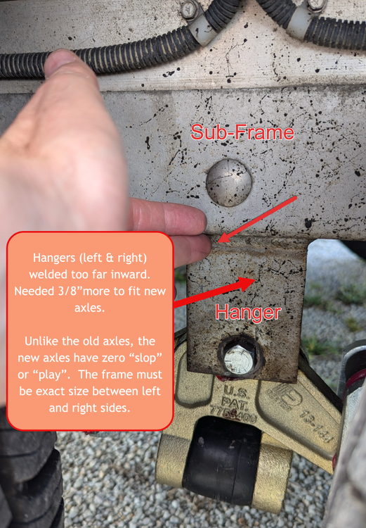

Moderators Wayfinder Posted July 11, 2024 Moderators Posted July 11, 2024 (edited) Okay, here are more details on the new axles not able to be fit onto #110. In the attached picture, my trailer's hangers are welded a bit too far inward on the sub-frame. The new axles do not have ANY "play" or "slop" in them for a fudge-factor. This is unlike the original axles. The frame hangers MUST be spot-on in regards to measurements. So, between the left and right hangers, there is not enough room. They needed 3/8" more to make them fit correctly. Oh well, it saved me a bit of $$. They said my shocks are still good and they installed my self-provided EZ-Flex suspension parts for me. The new windows and shades look awesome and the new batteries are working with more Amp Hours than I had with the crappy Interstate batteries. Jason seemed to give me a "facial & verbal compliment" and said the trailer is still looking great. I think he was a bit surprised due to the age of the camper. Wait until CGI gets their hands on it tomorrow. Oh, also, they are out of trailer covers and likely will not order them again, since not too many folks get them and .... some other reason, can't remember. He suggested I call Calmark Covers to see if they can still get me one. It will make the ceramic coating last longer. Mostly only cover it in winter and early spring. Edited July 11, 2024 by Wayfinder 4 Chris 2016 Legacy Elite II o-o Hull #110 o-o "Rock'in 110" o-o Twin Bed 2020 RAM 1500 Limited 5.7L Augusta, Georgia

Moderators Wayfinder Posted July 12, 2024 Author Moderators Posted July 12, 2024 9 hours ago, jd1923 said: Any chance you can ask for the hard measurements? I’d like to measure mine to see. Thanks I failed to get that measurement and I won't see them again. If those hangers are perfectly flush with the sub-frame, you have a good chance of them working. My hangers are not flush at all. Maybe the welder had a really good party the night before. LoL 1 1 Chris 2016 Legacy Elite II o-o Hull #110 o-o "Rock'in 110" o-o Twin Bed 2020 RAM 1500 Limited 5.7L Augusta, Georgia

Moderators Wayfinder Posted July 16, 2024 Author Moderators Posted July 16, 2024 @jd1923I asked Jason about that very thing, moving the hangers. He was not keen on that idea at all in fear it would not, or could not easily, be done well enough. I think it comes down to what's practical for all the man hours needed. 🤷♂️ Chris 2016 Legacy Elite II o-o Hull #110 o-o "Rock'in 110" o-o Twin Bed 2020 RAM 1500 Limited 5.7L Augusta, Georgia

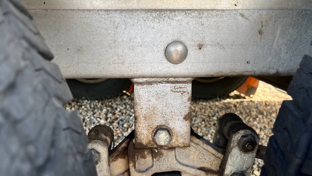

jd1923 Posted July 17, 2024 Posted July 17, 2024 (edited) This truly upsets me for Chris, and it makes me doubly mad since it appears mine are the same way (now hulls 75, 110, 113 and others?). One mine, it's recessed 1/4 to 3/8" on the outside and I can feel the weld sticking out a good 1/8" on the backside! Neither picture above, @rideandfly nor @Wayfinder shows the inside weld past the steel frame. If ALL hulls from 75 to 113 had this as the specs, then it is NOT a defect. But if some are and some are not, then certainly a defect. I'll get a better picture, but these three pictures look completely different in many ways. Trailer manufactures do not set specs for mounting distance of axles, in this case Dexter does. Were different axles used? Did Dexter change the spec? As @Mountainman198 nicely stated, "have the narrower steel suspension frame replaced with one with a SC of 50.50”, thereby allowing newer axles to be fitted." If you're replacing axles anyway, this would be another hour of labor to bolt on new steel frames, not a manhour concern. However, today like everything else, these steel frames are another considerable expense added to an axle upgrade. If I was to do this on our hull, I would determine the required length spec, take measurements, remove the steel frames and have a local welder replace the hangers. Or simply hold on to and service the original equipment as Chris has done. Edited July 17, 2024 by jd1923 Added last sentence 2 Chris & John in Prescott, AZ | 2016 EII #113 | '01 Ram 2500 Cummins!

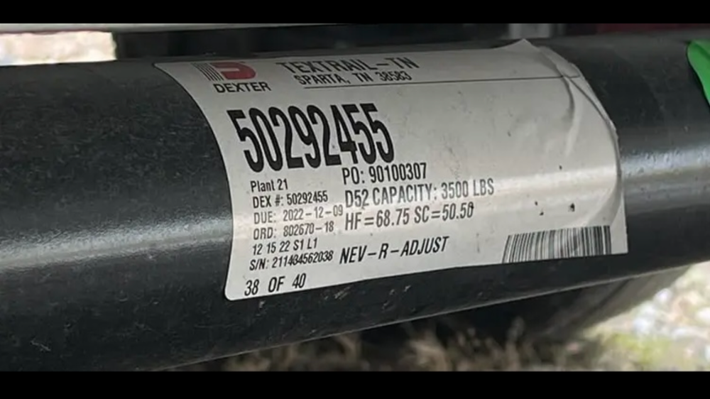

rideandfly Posted July 21, 2024 Posted July 21, 2024 (edited) Our original Dexter 5200lb axles built in 2014 installed by Oliver have HF (hub face) 68.75" and SC (spring center) 50.0". There is a difference, SC 50.0" older Dexter axle on our LE2 and SC 50.5" newer Dexter 5200lb axles on LE2s, overall difference of 1/2" or 1/4" per side. Our axles were originally for an LE1, but Oliver ran out of 3500lb axles and installed LE1 5200lb axles instead, as mentioned previously. See shop order notes below: Edited July 21, 2024 by rideandfly 1 Bill 2015 LE2 #75 2024 F350 6.8L
jd1923 Posted July 21, 2024 Posted July 21, 2024 4 hours ago, rideandfly said: There is a difference, SC 50.0" older Dexter axle on our LE2 and SC 50.5" newer Dexter 5200lb axles on LE2s... Thanks Bill, this makes it clear. Not a defect, but a change in specs over time. I had it on my to-do list to measure but instead realized with your note and the picture @Mountainman198 posted that I had taken a pic last year. As you can see, ours is the 50" axle as well. You have the 5200 LB axle 50". So, do we know that these are no longer available, or just not stocked by OTT? I would like the 12" brakes eventually. Licky for you, they ran out of the 3500s! 3 Chris & John in Prescott, AZ | 2016 EII #113 | '01 Ram 2500 Cummins!
