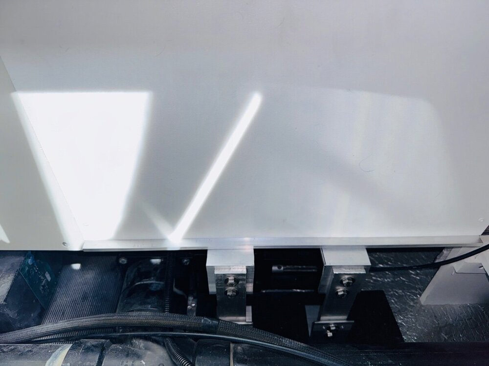

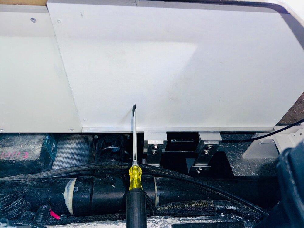

jd1923 Posted July 24, 2024 Author Posted July 24, 2024 I want to thank all that provided good feedback here! Always helpful. Want to show you my first step with a platform for the Victron Multiplus-II (see pics). More on this in a couple of weeks as I will start a new build thread. I'm waiting on the MP2. The Florida company Inverter Supply must receive shipment from the manufacturer and then ship to me. Thought I would get it this week, but it will be another week. I'm getting installation parts here and there. Love how this first step turned out. I had to put a steel cutting blade in my power miter saw. One mounting ear had to be cut back to slip it under and the two mounting brackets had to be cut to fit side-by-side. This base will hold the weight of the MP2 and I will build a 6x24" platform above it. It will just sit on the floor since I will not drill into the bottom/outer hull. The MP2 will also be strapped above. Much more later in mod post! 😂 3 Chris & John in Prescott, AZ | 2016 EII #113 | '01 Ram 2500 Cummins!
