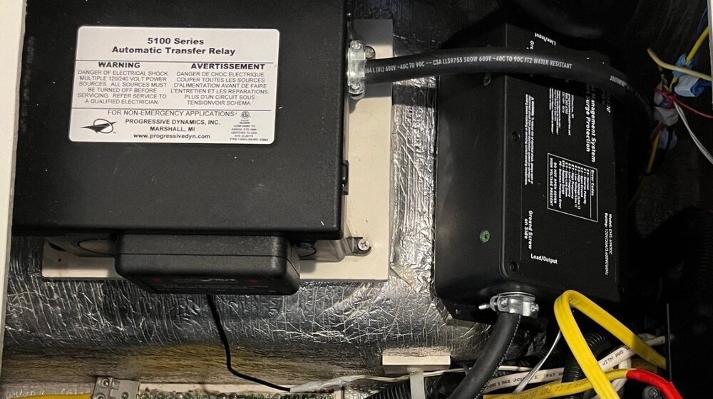

I arrived to a full-service camping facility late afternoon.  I was plugged into 30A shorepower.  Around midnight- so about 6 hours after plugging in, I heard a pop/boom and then my inverter (which had been off) remote bluetooth turned on and the inverter made the charging sound.    This cycle repeated itself about 3-4 times every 5 minutes before I got up and looked.  I went outside and unplugged the vehicle.  The next day- I plugged back in.  It didn't happen right away, but it happened again that night and I got up and looked under the dinette seat.  I could hear the popping coming from the Transfer Relay switch (I think I am not 100% sure).   I looked at the built-in surge protector codes.  It said error code 0, but I did notice the energy coming through was not consistent, it varied around 5 points.   Additional info:  1) I believe I may  have been the first to use this power system but I'm not 100% sure.  The host asked another camper if they had an issue and they didn't.  It was a new state park.  There had been lightning that night and the host said lightning did seem to affect the power in the area.   I had my own surge protector plugged in at the post.
Questions:  Was it my camper or their power?  Was there a safety issue/possible fire issue?  What makes the transfer switch pop?  Do I need service?  Is there a protection mechanism built into the camper that if shore power turns off the inverter will turn on?  Or was it just that the power went off, then came back on and I was hearing the charging of the batteries (not the inverter)?  It was that whiny machiney cooling off fan sound.
It has been a few weeks since this happened so I don't remember all the details, but I could have sworn the inverter turned itself on when the power was shut down/popped.  Is there some sort of protection built it where it can do that?  Maybe I misidentified the charger turning on as the whole inverter turning on.
Sincerely, Clare
The PD5100 ATS switches between two shore power sources (streetside or front receptacle intended for a generator). If the ATS goes bad, burns on the wrong side, you could have no power at all. It's likely not this device.
It is the EMS that has the remote switch with status and error code reader. See my first picture. The ATS is on left and EMS on the right. It would be difficult to ascertain which unit a noise would be coming from, being side-by-side in the same cabinet. Your setup may look different, since on our older hull OTT did not install an EMS and I installed the same unit to copy the newer OEM build.
Don't know how any power failure could start an inverter that was truly switched OFF, but I've read there are some different ON/OFF configurations on this model. Perhaps other experienced Xantrex 3000 owners could chime in here. We have a few!
The EMS E0 code means no error. This is the status you want. E1 through E10 are stated errors, defined on the cover plate and manual.
The EMS is a sensitive device. Another member just showed it to be the issue in their case. See this thread and notice the picture at the end showing the burnt neutral wire: Air conditioner and 110 outlets stop working while camping - Page 2 - Mechanical & Technical Tips - Oliver Owner Forums (olivertraveltrailers.com)
My second picture shows the insides of a good EMS when first installed. All wiring should look clean, free of corrosion and all connections tight.
It's impossible to diagnose an intermittent electrical issue from a past trip. I do suggest this as a check. Frist make sure that you are NOT connected to shore power and trip the 30A breaker as a secondary precaution. Remove the cover to the PD5100 ATS (snap-fit, clips on the sides) and remove the EMS cover plate (6 small Phillips screws). First use a strong flashlight and inspect every wire and connection, for anything not clean looking. Then tighten the 6 terminal screws in the EMS and I believe there are 9 connections in the ATS.
Replace the covers. Power up again when needed and that's likely all you can do for now, though you may soon get other suggestions. I also suggest when the Progressive Industries EMS-HW30C product is installed you do NOT add another "surge protector plugged in at the post." I've read here and elsewhere where many forum members will disagree with me on this notion, but IMHO possible interference between these devices outweighs redundancy. Give the lesser post model to a friend that needs one.
Could be there was no physical issue, merely the shore power at that campsite had intermittent surging causing the EMS to switch OFF/ON quickly which it is designed to do and does create sound in the solenoids opening/closing. However, I live by the motto "hear something, say something, do something!" You did the first two steps. Pull the covers on both devices for inspection and maintenance. Something I did when purchasing our used Oliver for peace of mind.

The person that can provide the best electronic advise on the Forum is Steve Landrum. I would send him a message. He maybe camping somewhere. The transfer switch has been an issue until the supplier upgraded the switch.
I also would suggest unhooking from shore power and checking the transfer switch wire connectors, and the EMS surge protector under the Dinette seat.

Another Oliver Owner had issues in a campground. He smelled burning under the Dinette. He didn't feel comfortable with electrical, so he hired a knowledgeable Mobile RV guy. This person went through everything and checked the transfer switch which was good. He found melted wires in the EMS. The mobile guy told him there was a good chance this wouldn't have happened if he had a good EMS surge protector at the post. The built in EMS saved his electronics. Contact a Mobile guy that knows electronics if you aren't comfortable. Again reach out to Steve Landrum.

I feel the greatest likelihood is that you hooked up at one location to shore power that had intermittent issues. Your PI EMS-HW30C protector worked well as it should have! The internal solenoids do make "popping" sounds when activated.
Clare, I'm not sure how old you hull is, though I still suggest you open the covers, take a good look, tighten terminal screws as I detailed above and best wishes, JD
If the Xantrex inverter is turned on and the trailer is connected to shore power, the inverter will kick in if shore power goes out. There's even a setting in the Xantrex that controls the delay before power transfers to the inverter.

You mentioned the power source was not consistent and was likely low enough for the EMS to shutdown to protect the Oliver. Here is a quote from another owner on this forum that you may find helpful in understanding the situation experienced.
On 12/24/2023 at 4:04 AM,  MobileJoy said “If the voltage drops to around 104V, the EMS will cut off shore power. If the Xantrex is drawing a lot of power (as it will by default when charging your batteries), with an unstable shore power source this could bring down the voltage to the point of EMS shutdown. This removes the power drain and allows the voltage to rise. Once it is sufficient, the EMS cuts back in and eventually powers the Xantrex. The resulting battery charging draw will bring down the voltage, etc., etc. I had this happen to our trailer at a campground that had unstable 30A shore power.”
I had this same occurrence happen to me once and this was a response provided by @MobileJoy that made perfect sense!
