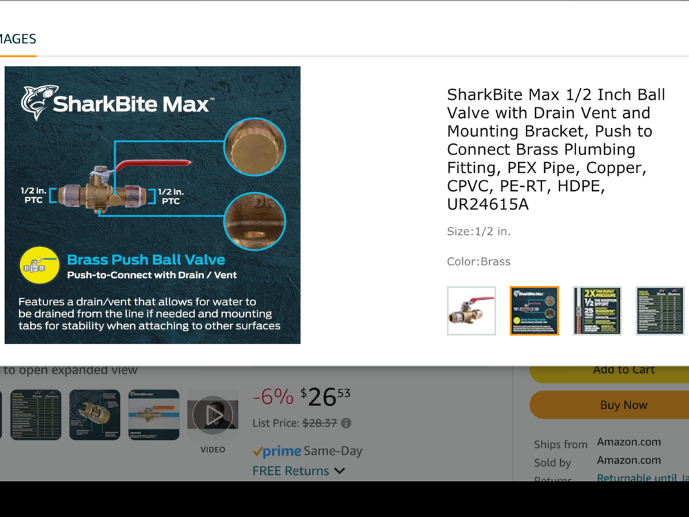

I would consider a shutoff valve with a drain vent like this SharkBite; available in 1/2 and 3/4”.
Two of these 1/2" Sharkbite valves with drains (one for hot, one for cold) plus a PVC pipe cutter, should be all that is needed. Depending on how much room you find around the Pex lines, I recommend making just one cut and trying to insert the Sharkbite fitting on both sides of that cut.  If there is room, that is best.  If some of the Pex must be cut out because there is not room otherwise, cut no more than 1/2 the length of the new valve out of the Pex pipe, to ensure enough Pex remains for insertion into both ends of the Sharkbite fitting.
FWIW, when we camped with Hull #1291 with outside ambient temps of 9 degrees F, the lowest temp in the bottom of the hull was near the outside faucet.  So, be sure there is no water left in the flexible hose to the shower handle as well.

The drain vent is a good extra. Without it use compressed air (<40 PSI) to remove water from lines prior to closing valves. Insulate shower opening or trunk door.
