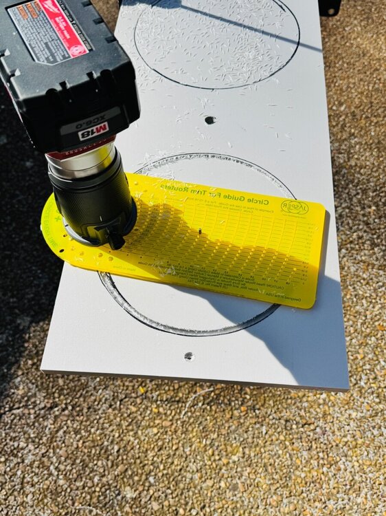

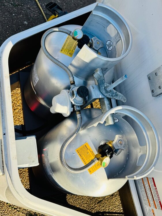

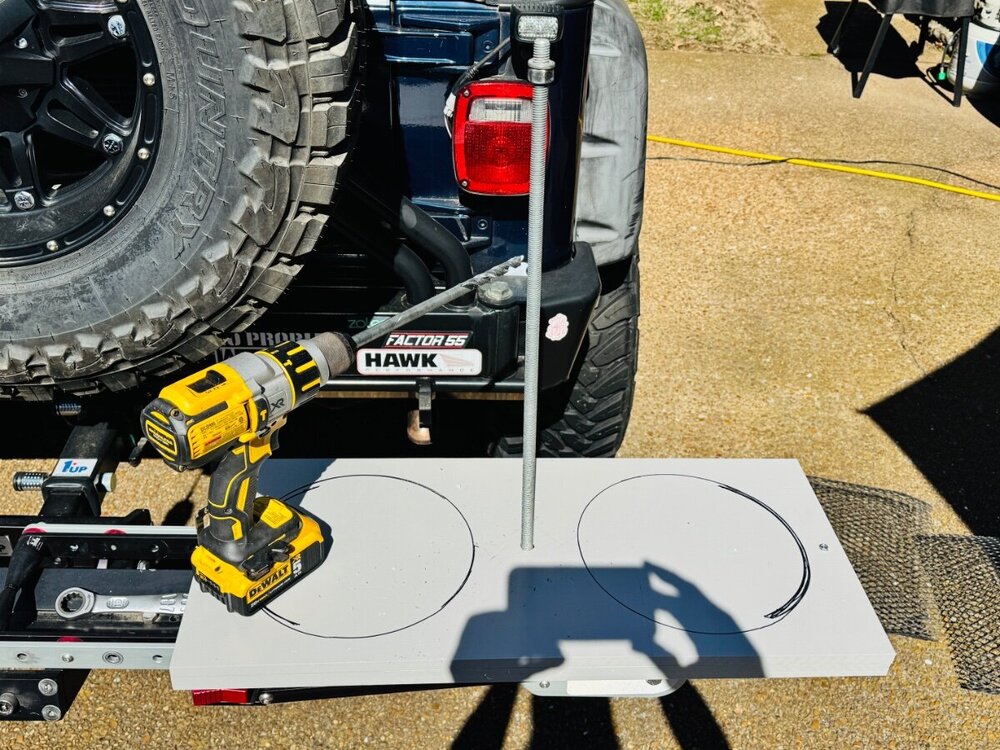

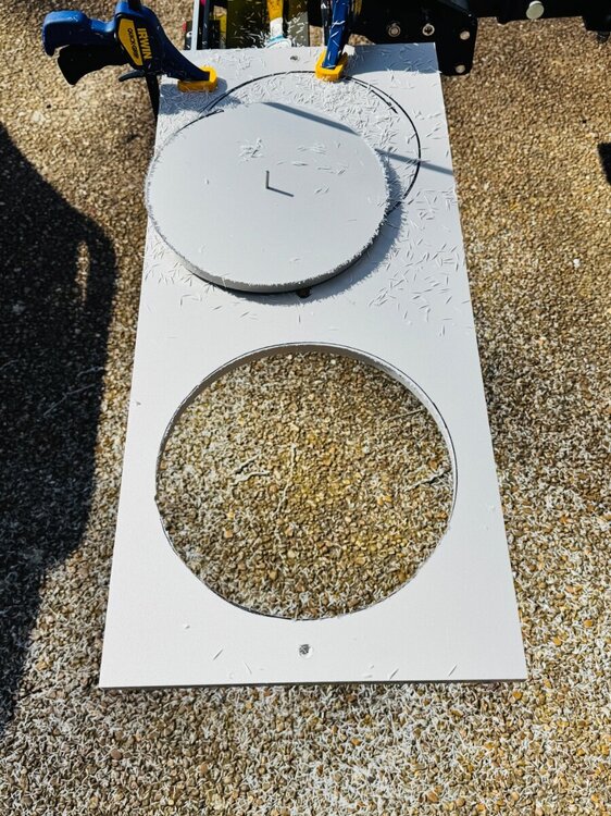

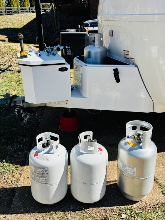

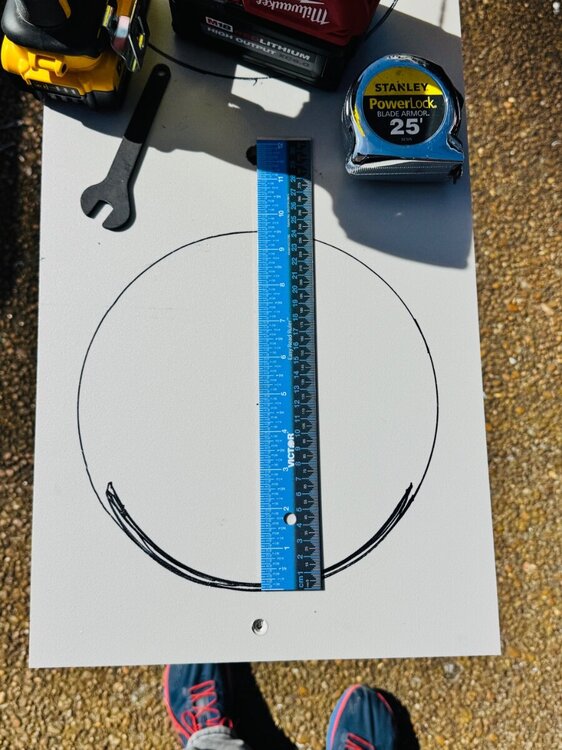

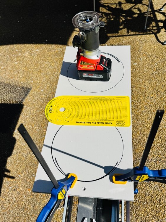

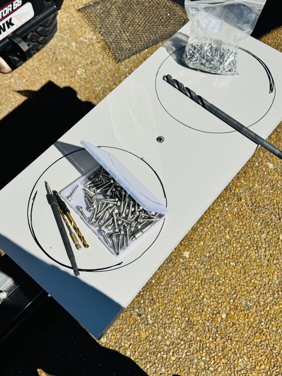

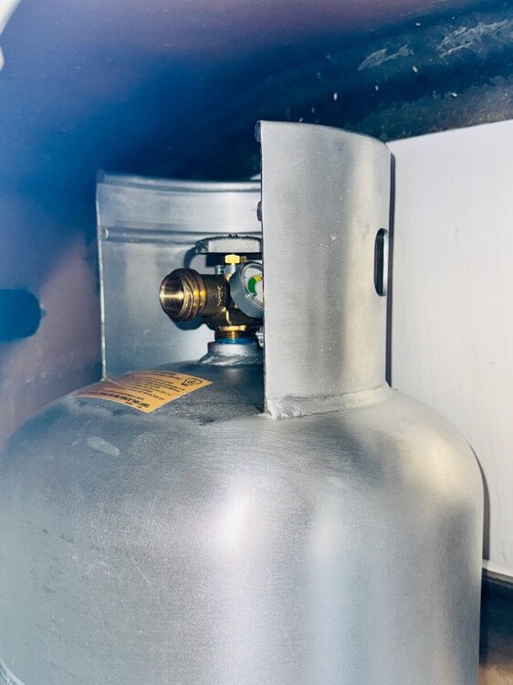

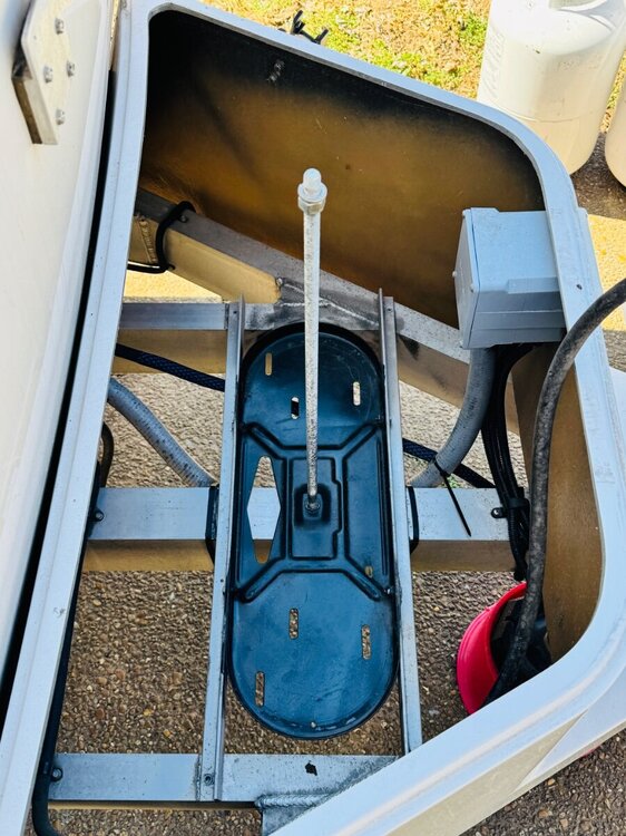

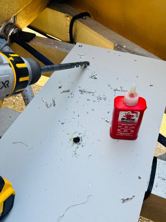

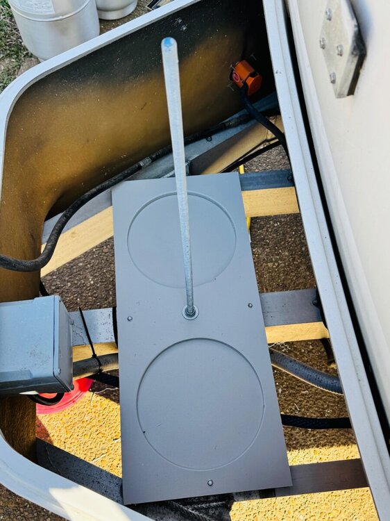

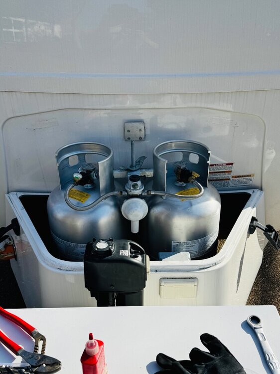

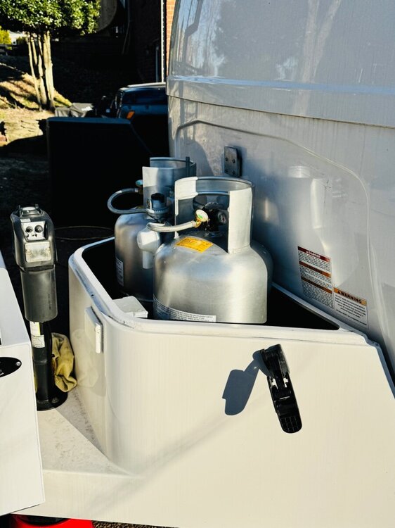

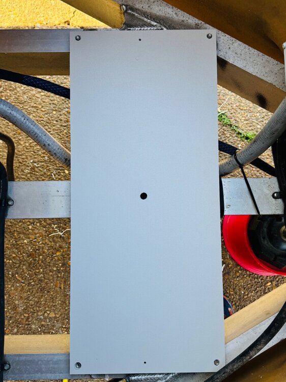

Finally got around to switching out our LP tanks for aluminum ones. 17 lbs vs 25 lbs. Supposedly holds 8 gallons of propane. We shall see. Had to make a custom tank mount due to bottom ring being too large for the steel tank mount. Made it out of HDPE 3/4 in bottom and top half with cutouts (9 9/16 in circle) was 1/2 in thick. Slight modification to center rod and large wing nut to secure tanks. Rod I used was 36 in. Needs to be long enough go through frame. Used my hand held router with a Jasper circle jig. Worked great. Very happy with the results. Couple inches to spare height wise with fiberglass shell back on. One of the last vestiges of steel removed from the Oliver.
https://flameking.com/product/ysn330-copy/
 Pre-purged vacuum ready for filling with propane
12x12x26.5 in
17 lbs
7-8 gallons
OPD valve
IMG_2735.thumb.jpeg.ba356090153feb74a91d55c2e23ee94e.jpegIMG_2734.thumb.jpeg.34aad2b252199151eda504dc95d1b542.jpeg3IMG_2738.thumb.jpeg.cb80dbae665cafeda9fa32b8e5875c7e.jpegIMG_2740.thumb.jpeg.ae7b1b1be1ec3fe5a0bc4c557bbb8155.jpegIMG_2742.thumb.jpeg.0375371f53289b7c3239e9e2ca01f9f0.jpegIMG_2744.thumb.jpeg.c07e4f49c422223343e3b1da7d05e040.jpegIMG_2746.thumb.jpeg.5be876ae48e84120155d77b747c4655a.jpegIMG_2747.thumb.jpeg.2fd6a7bb10cbd8c258acf4e19ce599fb.jpegIMG_2751.thumb.jpeg.367fa802566f43b8de1e741b096fbcff.jpegIMG_2750.thumb.jpeg.7b7cac4a69ad8d5287fca2caf162cb77.jpegIMG_2749.thumb.jpeg.934e9ded759eae3d645a4d3fdb86f7c8.jpegIMG_2728.thumb.jpeg.5c399f9fa1b80776536f80804990f310.jpeg
Edited by rideadeuce
  • Like 9

  • Aluminum tanks and mount are steel free. So no more Rust or annual maintenance. C
  • The old ones were coming up on expiration soon and one had a sticky valve… always a pain to fill
  • Safer in that they have an OPD valve
  • Lighter, picking 17 vs 25  lbs does make a difference, especially when full
  • New mount is easier to seat the tanks
  • 8 gallons vs 7 gallons
Some cons, would be the cost of tanks, custom mount needed (none available for purchase yet), wireless Mopeka propane tank monitor needs extra adhesive mount since tanks are not magnetic and decreased puncture resistance.
Get out there!

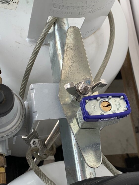

I put a lock on the LP tank spin nut. I locked the battery tray after our LiFePO4 upgrade since it was the single most expensive addition we've made. But the spare, OMG! 🤣I promise you, it has little to NO STREET VALUE! The other items mentioned, the crackhead thief can get quick cash on the street. Not an Oliver spare, nobody wants one except you. Heck, if I every wanted a bike rack (not me, unless it's a dirt bike), I would remove the spare and stick it in an outbuilding. But that's just me.
