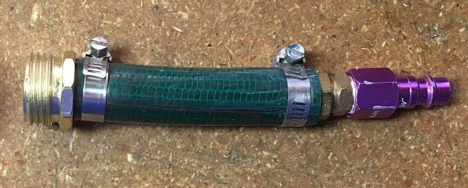

jd1923 Posted January 7 Posted January 7 (edited) 2 hours ago, Roger said: Just flushing the city lines doesn't get rid of the anti-freeze pumped into the fresh water tank when the freshwater line was winterized. This is what I am interested in flushing, more so than the city lines. I don’t use antifreeze, only compressed air (OTT does not recommend this). With antifreeze, yes use it in your plumbing since that will empty sooner or later into your gray tank. But do not pump antifreeze into your Fresh Tank! The tank is very slow to empty and difficult to rinse clean. Just blow compressed air to empty the fill line and drain the tank. Two seconds of air while you're waiting 30 min on the tank. No worries next season, just fill 'er up and go! 😎 Edited January 7 by jd1923 Added pic Chris & John in Prescott, AZ | 2016 EII #113 | '01 Ram 2500 Cummins!
Roger Posted Wednesday at 05:22 PM Posted Wednesday at 05:22 PM 10 hours ago, jd1923 said: I don’t use antifreeze, only compressed air (OTT does not recommend this). With antifreeze, yes use it in your plumbing since that will empty sooner or later into your gray tank. But do not pump antifreeze into your Fresh Tank! The tank is very slow to empty and difficult to rinse clean. Just blow compressed air to empty the fill line and drain the tank. Two seconds of air while you're waiting 30 min on the tank. No worries next season, just fill 'er up and go! 😎 Do you blow all yhe lines or just the freshwater tank? 2021 Elite II Twin Bed Hull #1023 - Kimba | 2025 Ford F-350 6.7 Diesel
jd1923 Posted Wednesday at 05:46 PM Posted Wednesday at 05:46 PM 15 minutes ago, Roger said: Do you blow all yhe lines or just the freshwater tank? I blow ALL the lines, but many here are concerned with this practice since it is not OTT recommend (they used to and then legal got in the way of practicality)! To me it takes me 10 min (half the time) when we get home from a trip and not draining or fussing to get ready again. I use compressed air in my garage every day, so it's right there and ready. To clear the Fresh Tank inlet is a straight run from hull to tank, so there should not be (false) concerns of damage to the water pump or anything else. See this procedure which I wrote up a couple years ago. BTW, step #13 was suggested and I added it but I don't believe it's necessary and have never done this step. I've never used RV antifreeze in three RVs we're owned. 1 Chris & John in Prescott, AZ | 2016 EII #113 | '01 Ram 2500 Cummins!
Moderators Mike and Carol Posted Wednesday at 08:32 PM Moderators Posted Wednesday at 08:32 PM 2 hours ago, jd1923 said: I blow ALL the lines, but many here are concerned with this practice since it is not OTT recommend (they used to and then legal got in the way of practicality)! To me it takes me 10 min (half the time) when we get home from a trip and not draining or fussing to get ready again. I use compressed air in my garage every day, so it's right there and ready. To clear the Fresh Tank inlet is a straight run from hull to tank, so there should not be (false) concerns of damage to the water pump or anything else. See this procedure which I wrote up a couple years ago. BTW, step #13 was suggested and I added it but I don't believe it's necessary and have never done this step. I've never used RV antifreeze in three RVs we're owned. I use an air compressor similar to the method JD posted. I’ve never used antifreeze. We do get below freezing a few times each winter and have had several days in single digits since we’ve been Oliver owners. When a serious freeze is forecasted I bring the trailer home and use a couple of electric heaters inside with the inner hulls open. No problems to date. I’d be a little more vigilant if we were in colder areas. We’ve been in the upper 70s since Christmas, but will probably get one or two freezes before spring. 2 Texas Hill Country | 2016 Elite II #135 | 2020 Ram 2500 6.7L Cummins
