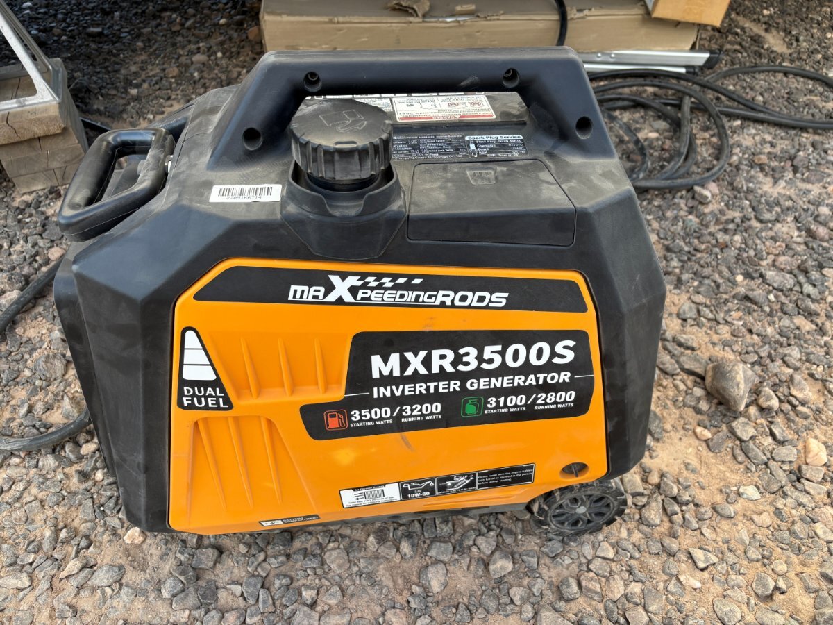

I may have missed something here. I believe the OP said he was running his generator on LP. I don't recall seeing that discussed. How much of a difference is there using LP vs fuel? It was my understanding there is a significant difference. Will the change of some settings then allow his AC to run without issues?
Good point. I believe running on propane derates the generator by a bit. With a 3400W unit, maybe enough to cause an overload in this situation, but I was wondering why it wasn't tripping the breaker on the generator. Now, after @Snackchaser's excellent explanation I'm wondering if an unbonded generator is preventing the generator's built in breaker from tripping, causing the Oliver's internal breaker to trip instead. However, the Progressive power protection should not have let him connect an unbonded generator in the first place, so maybe the generator's breaker is faulty?
John, we run our dual fuel Maxpeedingrods MXR3500S on propane without any issues. I prefer propane vs gas - it's cleaner burning, more eco friendly and lower maintenance. However, with propane you lose energy output, on our MXR3500S the specs are: Peak Wattage: 3500W (Gas) / 3100W (LPG) and Running Wattage: 3200W (Gas) / 2800W (LPG).
