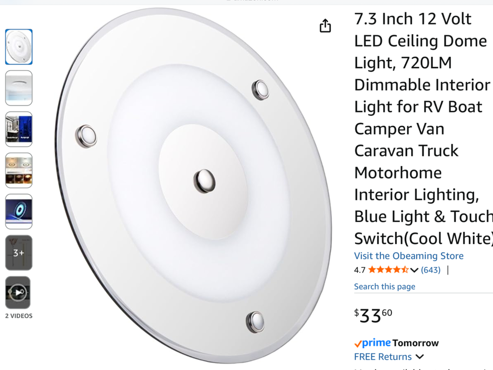

HDRider Posted July 11, 2025 Author Posted July 11, 2025 Anyone use these? I think they are the new Oliver standard. https://www.amazon.com/Homdec-Interior-Lighting-Surface-Dimmable/dp/B097SKPXSC?source=ps-sl-shoppingads-lpcontext&ref_=fplfs&smid=A1CK9LI16C4XW1&th=1 1 Jeff & Cindy - NE Arkansas - 2023 Legacy Elite II - Twin Bed - Hull #1423 TV - 2015 Silverado 2500 Duramax 4x4
johnwen Posted July 11, 2025 Posted July 11, 2025 38 minutes ago, HDRider said: Anyone use these? I think they are the new Oliver standard. https://www.amazon.com/Homdec-Interior-Lighting-Surface-Dimmable/dp/B097SKPXSC?source=ps-sl-shoppingads-lpcontext&ref_=fplfs&smid=A1CK9LI16C4XW1&th=1 Yes...that is what Oliver sent me a few months ago. I like them better. Bezel was difficult to twist off the first time but easy after that. 3 screws and slightly different hole pattern...NO MORE RIVETS...YAY! Good luck John 1 1 2022 Oliver II #996 "Bessie", 2019 Silverado LTZ 5.3, Veterans https://wenandjohnsadventure.com/

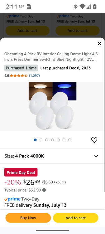

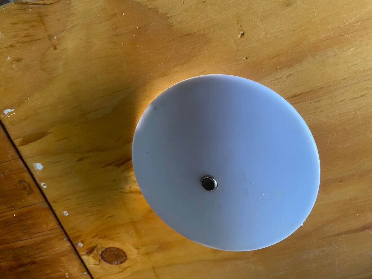

John Dorrer Posted July 11, 2025 Posted July 11, 2025 These are the lights we replaced the lights over the sink and stove. It has a on/off button in the center, blue night light and dimmable light. Box of 4 so I have 2 more if the others fail. We did have a problem with the one over the dinette. I removed the dome, and re-alligned the spring, and we have had no further issues. The key is just a light touch, not pushing on the dome. 1 2 John & Susan Dorrer, 2013 F250, 6.2 gasser, 4x4, 2022 Legacy Elite 2, twin beds, Hull #1045, Jolli Olli -

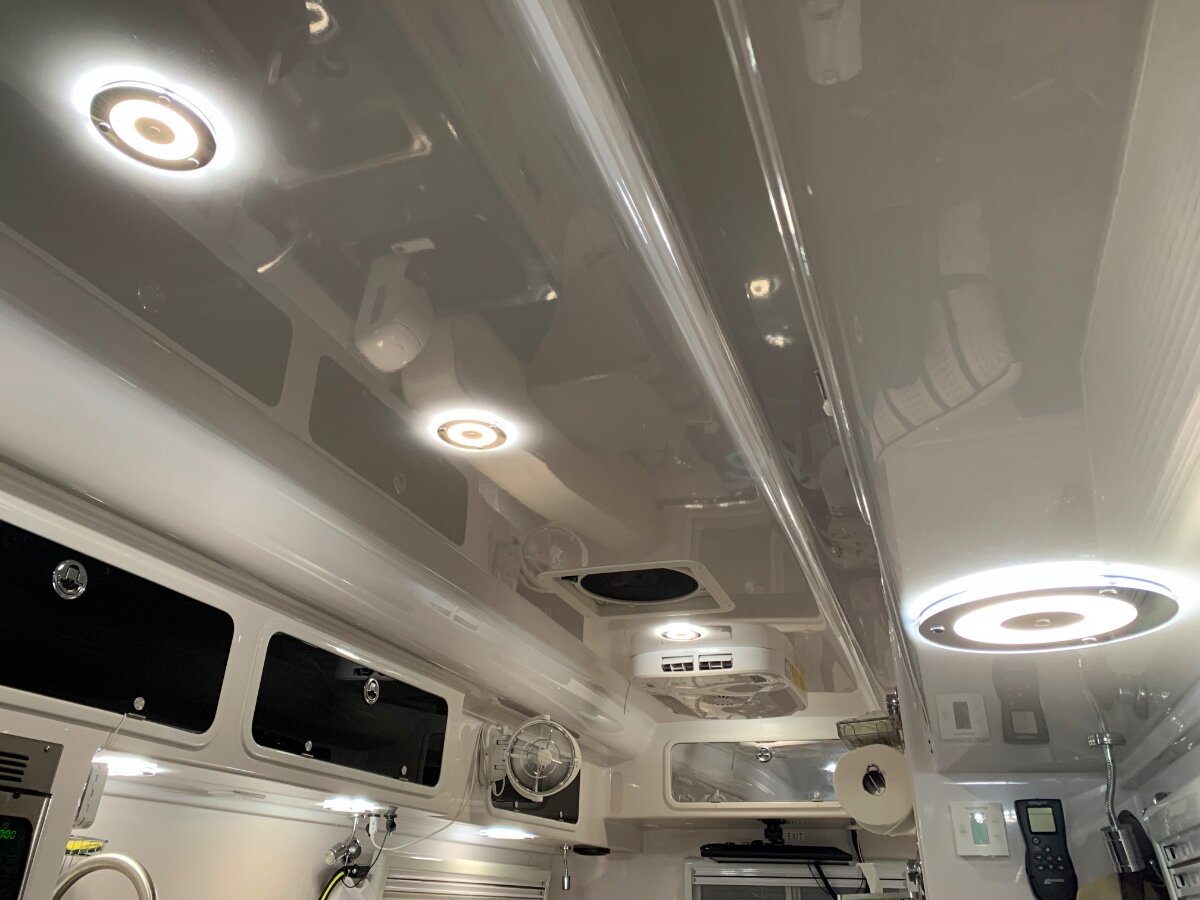

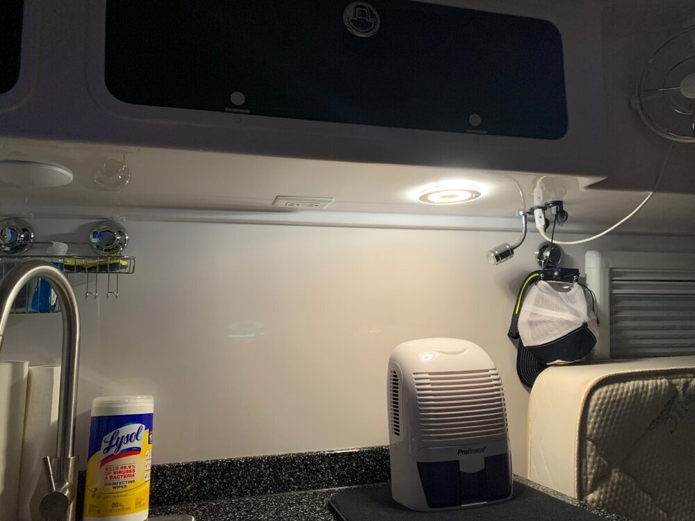

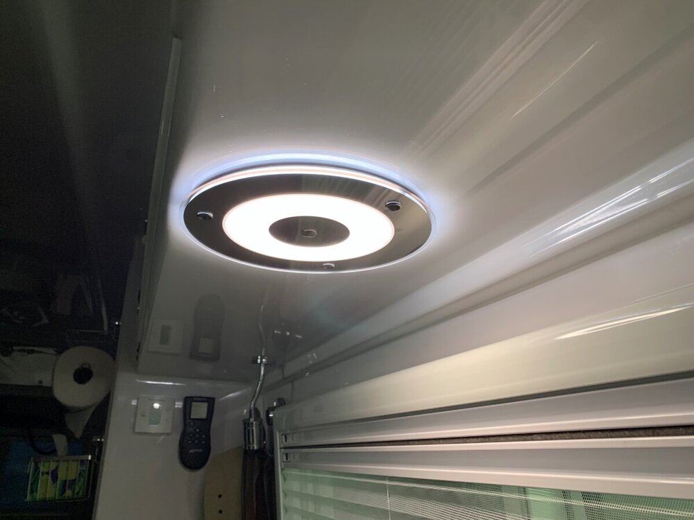

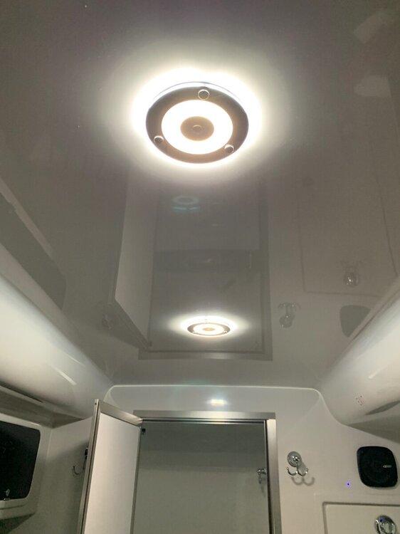

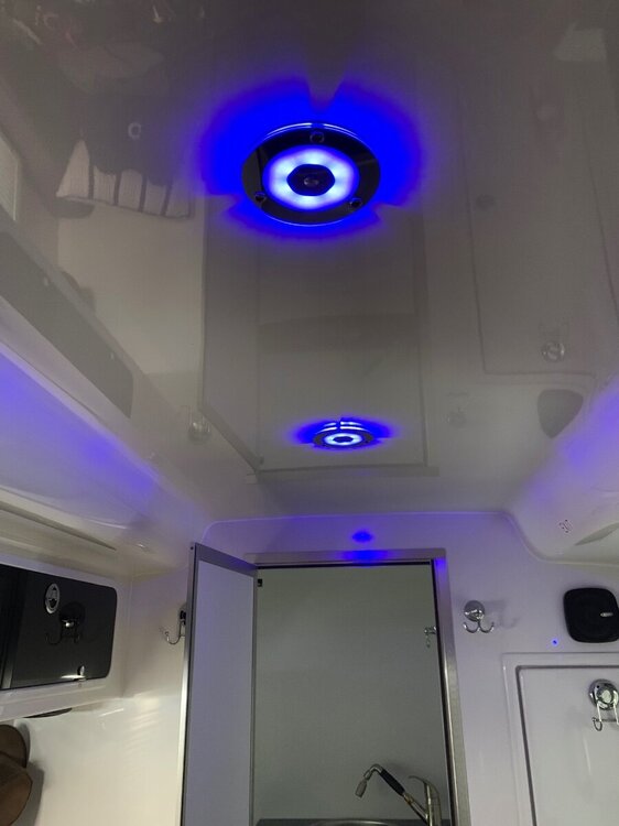

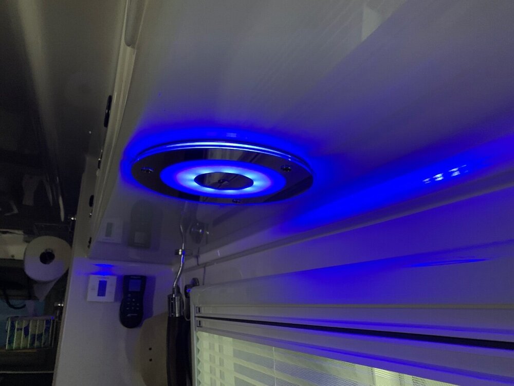

Ronbrink Posted July 14, 2025 Posted July 14, 2025 All this talk about touch lights and replacements made me reconsider making do with the stock fixtures. Currently installing two early arrivals and with one done, very pleased! I’ve always considered the lights to be too bright, especially over the dinette; sensitive eyes. Thinking that problem may be solved with these ones, dimmable cool white with a blue night light/ambiance feature. What think you? 5 1 Ron and Brooxie | Clear Lake (Houston), Texas 2020 OLEll, Twin, 579: No installed solar, dual 30# propane tanks w/GasStop safety devices, Renogy 40A DC-DC charger, 460Ah LFP battery bank/Victron SmartShunt, auxiliary Cerbo-S GX/Victron 30A Blue Smart IP22 Charger combo, interior mounted Hughes Autoformer, twin independent sliding Lagun mount tables, extended dinette table and pantry landing, tongue-mounted hoist, Beech Lane refrigerator Ventilation/Evaporate Coil fans, metal valve stems with TST cap sensors and signal repeater, Waste Master sewer hose management system, Dreiha Atmos 4.4 A/C upgrade/Ceilo Breez Max thermostat, FlagpoleBuddy Starlink Mini suction mount kit. 2019 GMC Savana 2500 Cargo Work Van: Explorer Limited SE, Low-Top 7 Passenger van conversion, 6.0L V8 Vortec, 6-Speed Automatic, RWD; Air-Lift LoadLifter air suspension/WirelessAir compressor; Bilstein B6 4600 Series shocks; metal valve stems for TST tire pressure monitoring system; Buyers Products cargo containment boxes/DC Cargo securement system; rear bumper DC-DC Anderson power cable outlet; 100Ah 12V portable power station/Dometic CFX 75L Dual Zone cooler; front 2” receiver hitch/QuikrStuff Mach2 double bike rack; Mechman 320A high output alternator; Starlink Mini/Veritas Vans magnetic mount.
Tom and Doreen Posted July 14, 2025 Posted July 14, 2025 Those look great! How was the installation and do they have a mechanical on/off switch or are they touch activated? 2 Tom & Doreen • 2023 Elite ll • Hull #1321 • 2023 Tundra Platinum Crew Max • Cheshire CT

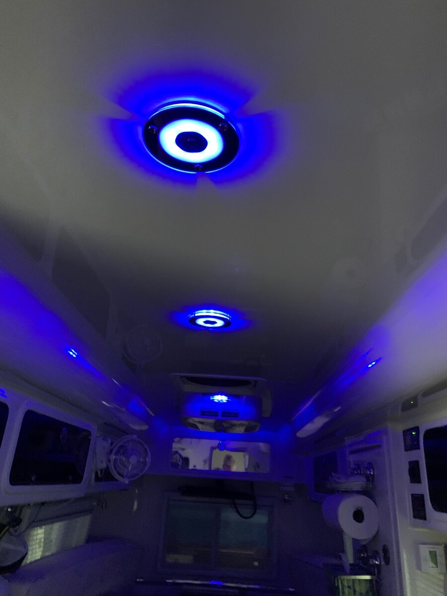

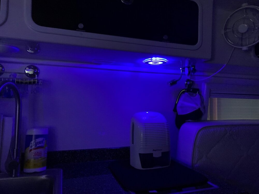

Ronbrink Posted July 14, 2025 Posted July 14, 2025 (edited) 15 hours ago, Tom and Doreen said: Those look great! How was the installation and do they have a mechanical on/off switch or are they touch activated? There is a touch sensitive control button in the center; touch to change colors, long touch to increase/decrease lighting. Can also be turned on/off by Master light switch to last setting(s). Simple install; a little larger diameter, but mounting holes were same. First install was above dinette, this second above the cooktop. I plan to install additional lights above each bed, over sink and maybe in wet bath under cabinet. Edited July 15, 2025 by Ronbrink 1 3 1 Ron and Brooxie | Clear Lake (Houston), Texas 2020 OLEll, Twin, 579: No installed solar, dual 30# propane tanks w/GasStop safety devices, Renogy 40A DC-DC charger, 460Ah LFP battery bank/Victron SmartShunt, auxiliary Cerbo-S GX/Victron 30A Blue Smart IP22 Charger combo, interior mounted Hughes Autoformer, twin independent sliding Lagun mount tables, extended dinette table and pantry landing, tongue-mounted hoist, Beech Lane refrigerator Ventilation/Evaporate Coil fans, metal valve stems with TST cap sensors and signal repeater, Waste Master sewer hose management system, Dreiha Atmos 4.4 A/C upgrade/Ceilo Breez Max thermostat, FlagpoleBuddy Starlink Mini suction mount kit. 2019 GMC Savana 2500 Cargo Work Van: Explorer Limited SE, Low-Top 7 Passenger van conversion, 6.0L V8 Vortec, 6-Speed Automatic, RWD; Air-Lift LoadLifter air suspension/WirelessAir compressor; Bilstein B6 4600 Series shocks; metal valve stems for TST tire pressure monitoring system; Buyers Products cargo containment boxes/DC Cargo securement system; rear bumper DC-DC Anderson power cable outlet; 100Ah 12V portable power station/Dometic CFX 75L Dual Zone cooler; front 2” receiver hitch/QuikrStuff Mach2 double bike rack; Mechman 320A high output alternator; Starlink Mini/Veritas Vans magnetic mount.

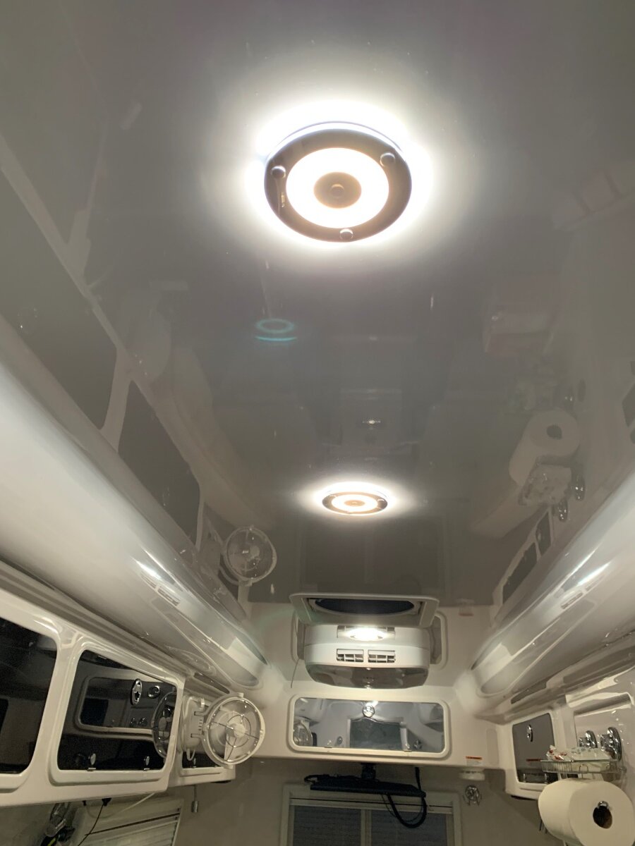

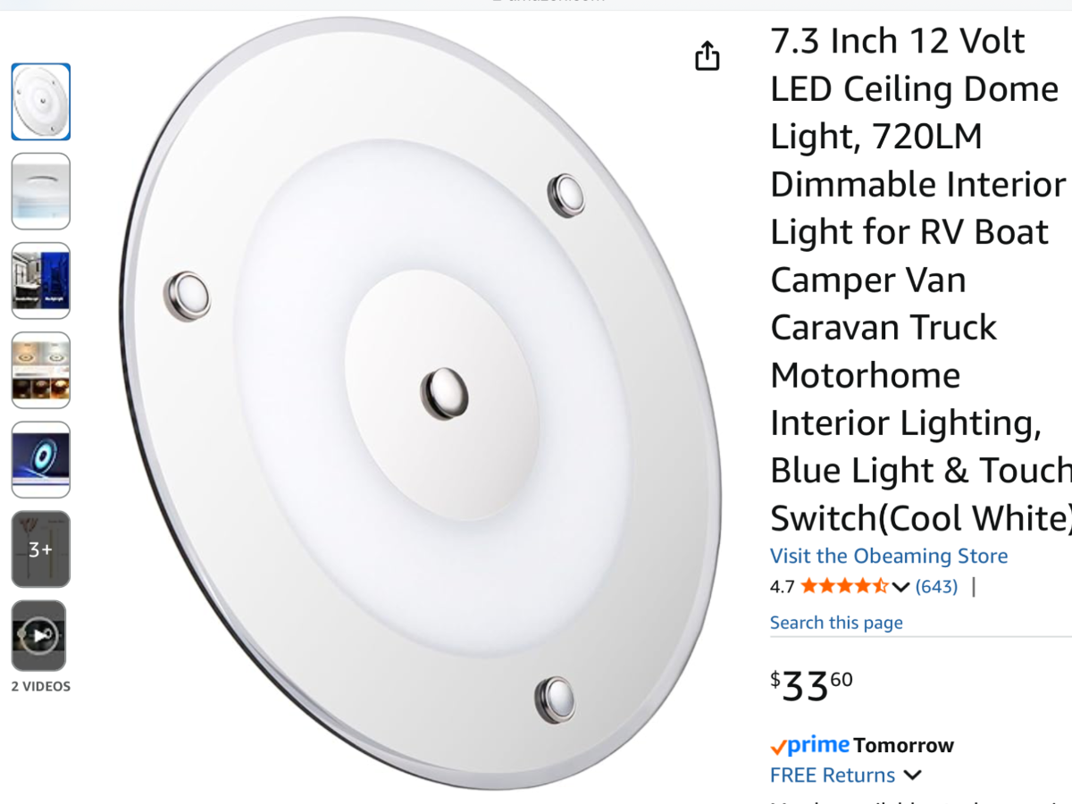

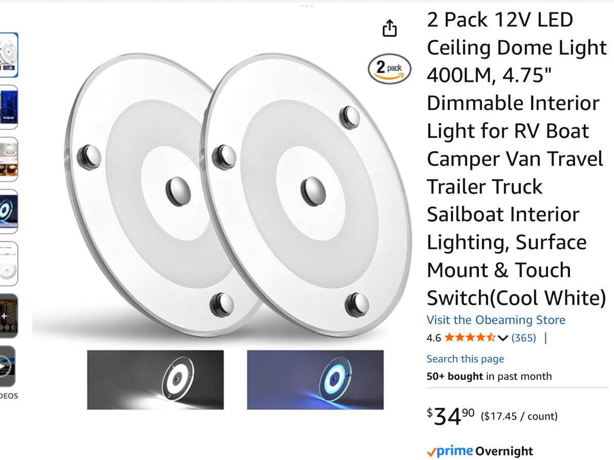

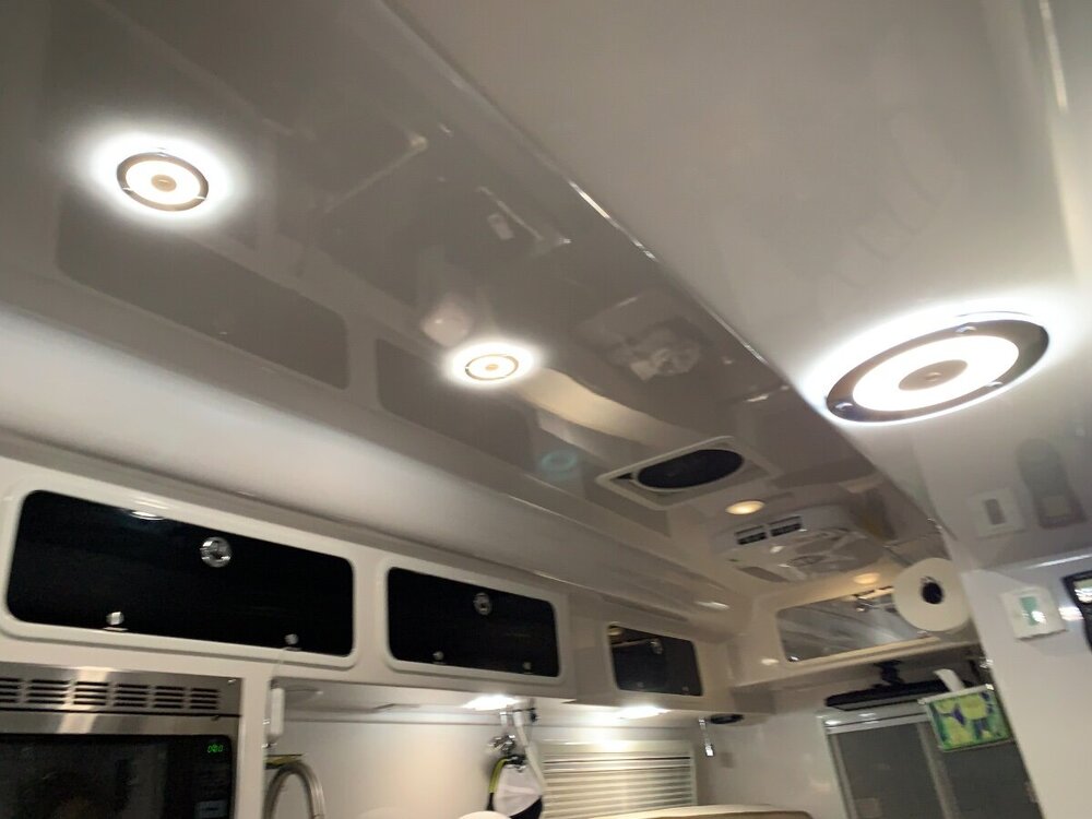

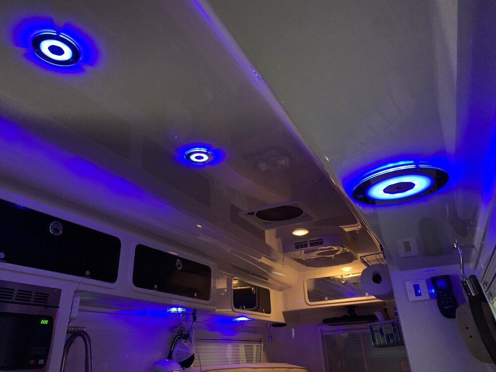

Ronbrink Posted July 25, 2025 Posted July 25, 2025 On 7/14/2025 at 4:52 PM, Ronbrink said: I plan to install additional lights above each bed, over sink and maybe in wet bath under cabinet. So the wifey thought the light installed over the dinette was too dim, even though its brightest setting was 400 lumens. To maintain harmony, it was upgraded to the larger in this line of fixtures, 720 lumens. I hate it when she’s right! I can easily dim this light to my liking when dining and have an abundance of light when need be. I have since installed the larger size over each twin bed and two of the smaller in the ceiling; of which two of the four stock lights started failing over a year ago. Today I plan to replace the remaining ceiling and sink fixtures using the smaller to complete this project. Let there be light! As before, the Ceiling switch controls the four lights in unison to their last settings; and the Master switch does the same for all of the lights. I remain undecided if the wet bath under cabinet light will be upgraded in like manner. 1 1 1 Ron and Brooxie | Clear Lake (Houston), Texas 2020 OLEll, Twin, 579: No installed solar, dual 30# propane tanks w/GasStop safety devices, Renogy 40A DC-DC charger, 460Ah LFP battery bank/Victron SmartShunt, auxiliary Cerbo-S GX/Victron 30A Blue Smart IP22 Charger combo, interior mounted Hughes Autoformer, twin independent sliding Lagun mount tables, extended dinette table and pantry landing, tongue-mounted hoist, Beech Lane refrigerator Ventilation/Evaporate Coil fans, metal valve stems with TST cap sensors and signal repeater, Waste Master sewer hose management system, Dreiha Atmos 4.4 A/C upgrade/Ceilo Breez Max thermostat, FlagpoleBuddy Starlink Mini suction mount kit. 2019 GMC Savana 2500 Cargo Work Van: Explorer Limited SE, Low-Top 7 Passenger van conversion, 6.0L V8 Vortec, 6-Speed Automatic, RWD; Air-Lift LoadLifter air suspension/WirelessAir compressor; Bilstein B6 4600 Series shocks; metal valve stems for TST tire pressure monitoring system; Buyers Products cargo containment boxes/DC Cargo securement system; rear bumper DC-DC Anderson power cable outlet; 100Ah 12V portable power station/Dometic CFX 75L Dual Zone cooler; front 2” receiver hitch/QuikrStuff Mach2 double bike rack; Mechman 320A high output alternator; Starlink Mini/Veritas Vans magnetic mount.
Todd B Posted July 25, 2025 Posted July 25, 2025 The fact that they turn on to their last setting may have sold me. I dislike that the master switch activates the touch lights. However, if they could adjust to a lower setting or turn on blue, that would be nice. I just don't like that when I don't want them on I have to go touch each one. 3 Todd & Kat 2023 LE ll twin, hull # 1305, Truma AC & WH, Platinum solar, Natures Head 2024 Ford F250 Lariat 7.3L gasser / 3.75, FX4

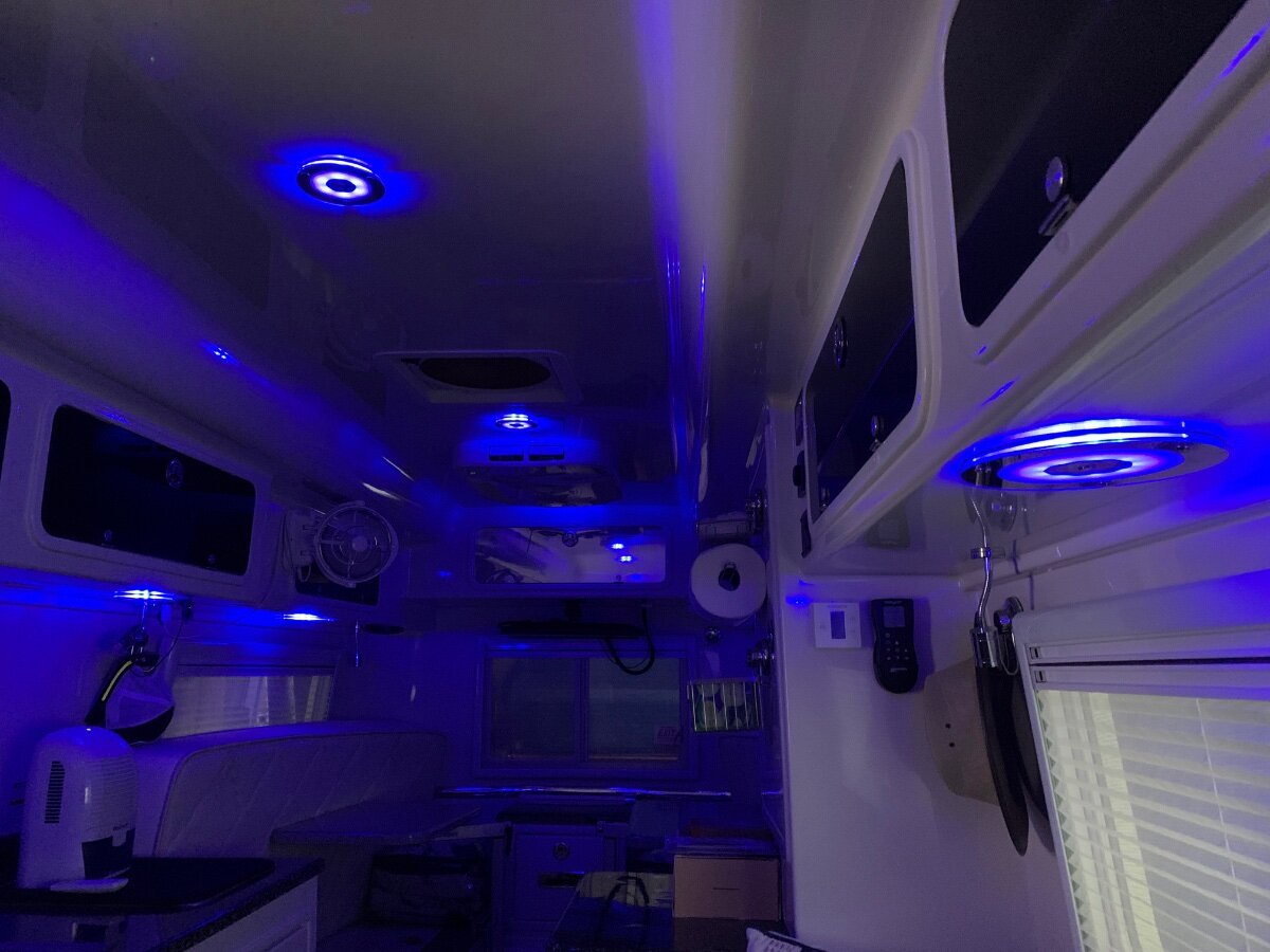

Ronbrink Posted July 26, 2025 Posted July 26, 2025 On 7/25/2025 at 7:04 AM, Ronbrink said: Today I plan to replace the remaining ceiling and sink fixtures using the smaller to complete this project. Install of the nine replacement lights in the main cabin DONE. The ‘cool white’ (blueish tint) vs the stock ‘warm white’ (yellowish tint) color temperature is so much brighter! Pics at full lumen and blue lighting: 1 Ron and Brooxie | Clear Lake (Houston), Texas 2020 OLEll, Twin, 579: No installed solar, dual 30# propane tanks w/GasStop safety devices, Renogy 40A DC-DC charger, 460Ah LFP battery bank/Victron SmartShunt, auxiliary Cerbo-S GX/Victron 30A Blue Smart IP22 Charger combo, interior mounted Hughes Autoformer, twin independent sliding Lagun mount tables, extended dinette table and pantry landing, tongue-mounted hoist, Beech Lane refrigerator Ventilation/Evaporate Coil fans, metal valve stems with TST cap sensors and signal repeater, Waste Master sewer hose management system, Dreiha Atmos 4.4 A/C upgrade/Ceilo Breez Max thermostat, FlagpoleBuddy Starlink Mini suction mount kit. 2019 GMC Savana 2500 Cargo Work Van: Explorer Limited SE, Low-Top 7 Passenger van conversion, 6.0L V8 Vortec, 6-Speed Automatic, RWD; Air-Lift LoadLifter air suspension/WirelessAir compressor; Bilstein B6 4600 Series shocks; metal valve stems for TST tire pressure monitoring system; Buyers Products cargo containment boxes/DC Cargo securement system; rear bumper DC-DC Anderson power cable outlet; 100Ah 12V portable power station/Dometic CFX 75L Dual Zone cooler; front 2” receiver hitch/QuikrStuff Mach2 double bike rack; Mechman 320A high output alternator; Starlink Mini/Veritas Vans magnetic mount.

HDRider Posted July 26, 2025 Author Posted July 26, 2025 On 7/14/2025 at 2:59 PM, Ronbrink said: All this talk about touch lights and replacements made me reconsider making do with the stock fixtures. Currently installing two early arrivals and with one done, very pleased! I’ve always considered the lights to be too bright, especially over the dinette; sensitive eyes. Thinking that problem may be solved with these ones, dimmable cool white with a blue night light/ambiance feature. What think you? Can you provide a link to where you got them? Or, a part number and the manufacturer? They look great 1 1 Jeff & Cindy - NE Arkansas - 2023 Legacy Elite II - Twin Bed - Hull #1423 TV - 2015 Silverado 2500 Duramax 4x4
Ronbrink Posted July 26, 2025 Posted July 26, 2025 1 hour ago, HDRider said: Can you provide a link to where you got them? Or, a part number and the manufacturer? Amazon purchases: 2 1 Ron and Brooxie | Clear Lake (Houston), Texas 2020 OLEll, Twin, 579: No installed solar, dual 30# propane tanks w/GasStop safety devices, Renogy 40A DC-DC charger, 460Ah LFP battery bank/Victron SmartShunt, auxiliary Cerbo-S GX/Victron 30A Blue Smart IP22 Charger combo, interior mounted Hughes Autoformer, twin independent sliding Lagun mount tables, extended dinette table and pantry landing, tongue-mounted hoist, Beech Lane refrigerator Ventilation/Evaporate Coil fans, metal valve stems with TST cap sensors and signal repeater, Waste Master sewer hose management system, Dreiha Atmos 4.4 A/C upgrade/Ceilo Breez Max thermostat, FlagpoleBuddy Starlink Mini suction mount kit. 2019 GMC Savana 2500 Cargo Work Van: Explorer Limited SE, Low-Top 7 Passenger van conversion, 6.0L V8 Vortec, 6-Speed Automatic, RWD; Air-Lift LoadLifter air suspension/WirelessAir compressor; Bilstein B6 4600 Series shocks; metal valve stems for TST tire pressure monitoring system; Buyers Products cargo containment boxes/DC Cargo securement system; rear bumper DC-DC Anderson power cable outlet; 100Ah 12V portable power station/Dometic CFX 75L Dual Zone cooler; front 2” receiver hitch/QuikrStuff Mach2 double bike rack; Mechman 320A high output alternator; Starlink Mini/Veritas Vans magnetic mount.

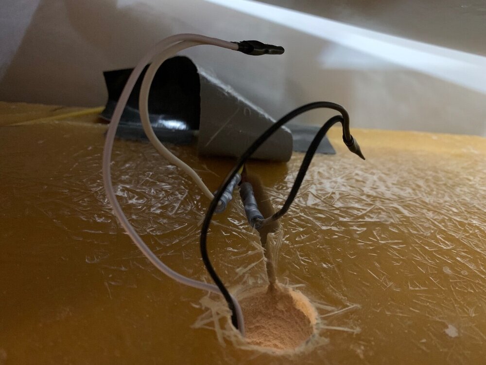

Jjnps Posted October 8, 2025 Posted October 8, 2025 Hi Ronbrink, so when installing did you wire the black on the fixture to the red or yellow on your Ollie under the cabinet by the sink? How are the holding up? The look great and thinking about replacing mine as the cabinet under sink would not shut off one night middle of the night…
Ronbrink Posted October 8, 2025 Posted October 8, 2025 11 hours ago, Jjnps said: Hi Ronbrink, so when installing did you wire the black on the fixture to the red or yellow on your Ollie under the cabinet by the sink? How are the holding up? The look great and thinking about replacing mine as the cabinet under sink would not shut off one night middle of the night… All of my lead wires were black/white, ceiling and under cabinet. In your situation, probably black to the red and white to the yellow; in my trailer yellow designates ground/neutral. These are quality lights and thus, expected to hold up well; no issues to date and so much easier to operate. The former lights were indeed frustrating, which lead me to do the total light replacement, no regrets! 1 Ron and Brooxie | Clear Lake (Houston), Texas 2020 OLEll, Twin, 579: No installed solar, dual 30# propane tanks w/GasStop safety devices, Renogy 40A DC-DC charger, 460Ah LFP battery bank/Victron SmartShunt, auxiliary Cerbo-S GX/Victron 30A Blue Smart IP22 Charger combo, interior mounted Hughes Autoformer, twin independent sliding Lagun mount tables, extended dinette table and pantry landing, tongue-mounted hoist, Beech Lane refrigerator Ventilation/Evaporate Coil fans, metal valve stems with TST cap sensors and signal repeater, Waste Master sewer hose management system, Dreiha Atmos 4.4 A/C upgrade/Ceilo Breez Max thermostat, FlagpoleBuddy Starlink Mini suction mount kit. 2019 GMC Savana 2500 Cargo Work Van: Explorer Limited SE, Low-Top 7 Passenger van conversion, 6.0L V8 Vortec, 6-Speed Automatic, RWD; Air-Lift LoadLifter air suspension/WirelessAir compressor; Bilstein B6 4600 Series shocks; metal valve stems for TST tire pressure monitoring system; Buyers Products cargo containment boxes/DC Cargo securement system; rear bumper DC-DC Anderson power cable outlet; 100Ah 12V portable power station/Dometic CFX 75L Dual Zone cooler; front 2” receiver hitch/QuikrStuff Mach2 double bike rack; Mechman 320A high output alternator; Starlink Mini/Veritas Vans magnetic mount.

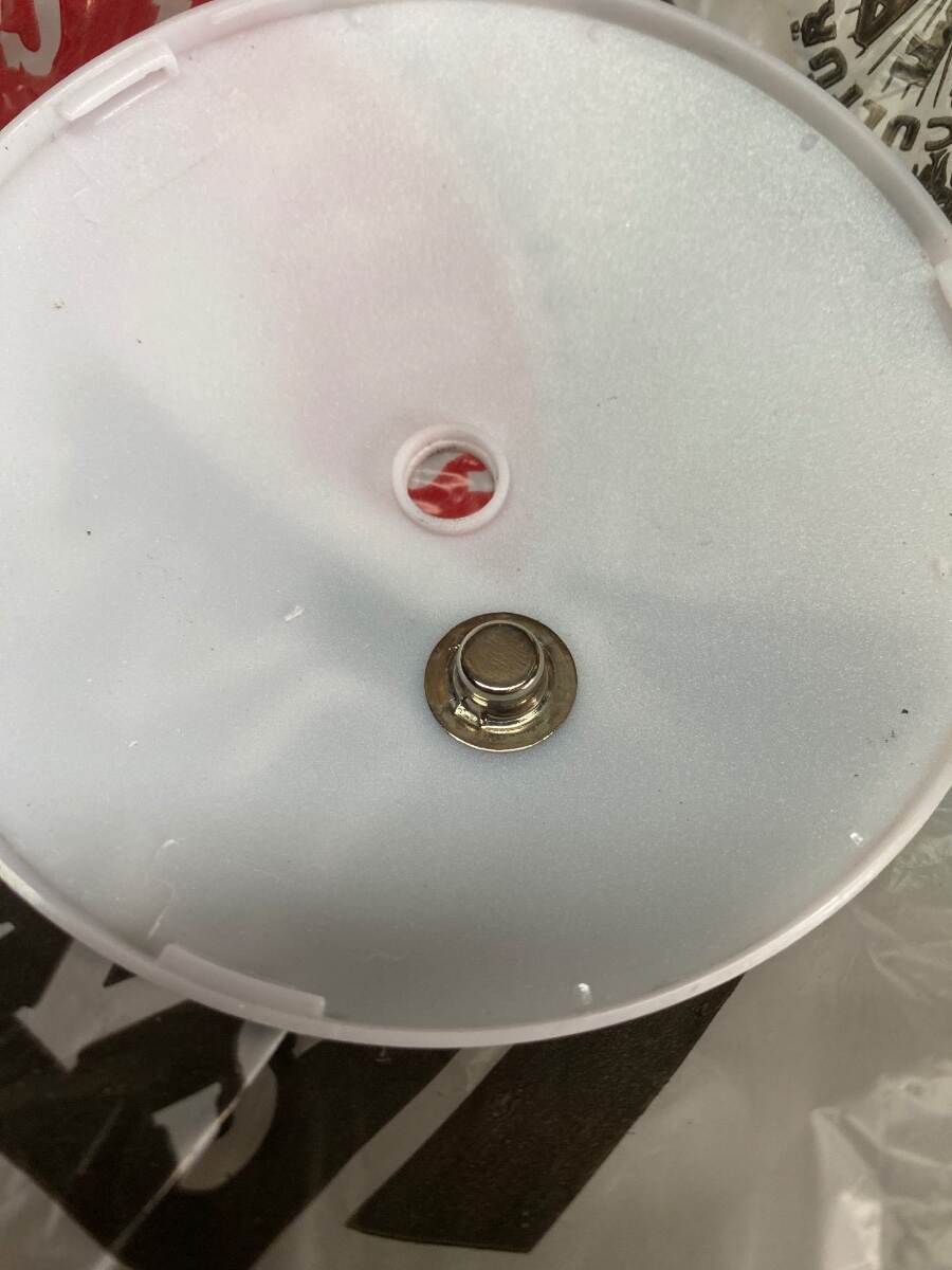

2008RN Posted December 12, 2025 Posted December 12, 2025 I got an Idea on how to fix the original lights that were failing. First, I had 3 lights that went from randomly failing to one out of 10 times trying to turn it on the light my come on. I played with the ones over the kitchen counter for 6 months trying to get them working better. When the 3 light started failing I decided to upgrade to the 7" and 3" white and blue lights for the touch lights. As I was taking things apart I noticed that I could turn the light on/off every time by just touching the spring. I also found that I could get within about .050 of an inch (just less than 1/16 of an inch) of the spring the light would turn On/Off every time. After I finished installing the all of the new lights, I thought I would try something. I took the light that was failing the most, and drilled a 3/8 hole in the center of the cover. I put the cover back on the light and it looks ugly. I thought If I could find a piece of metal button I could make it look nicer. Then I remembered I had a couple of 5/16 push on axle nuts/caps. The axle cap fit perfect in my hole and I put the cap back on. The cover looks like it was manufactured like this. I hooked the light up to 12V and tested it. It works great. Just like the light did with me touching the spring. Not pushing required, just get real close or light touch on the axle cap. This is a cheap and quick way to possible getting your lights functioning again. You might try to use a 3/8 press on nut cap. And drill the hole to 7/16 so the spring would set inside the axle nut instead of on the flange of the cap. Although you might not have enough spring pressure to have the spring tightly touching the nut. BTW, I do like the new lights. The 7" cool white (5000K) model is almost as bright as the originals, the 3 inch ones are dimmer. We chose to use the 3" one over the beds and kitchen table. 3 Early 1999 Ford F250 SD 7.3L Diesel 2020 Elite II Twin - Hull # 648
