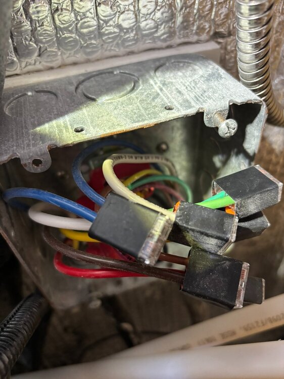

tallmandan Posted July 12, 2025 Posted July 12, 2025 6 hours ago, Tony and Rhonda said: I am also trying to find the TV charge wire. I'm not sure if this will help as I don't know if a 2017 trailer was wired the same way as my 2020 trailer. I disconnected my charge wire when I upgraded to lithium batteries a few months ago. Mine did not have a bus bar. I couldn't find anything under the seats or bed. Inside the bathroom access panel under the sink I found that my 7-pin cable entered a standard galvanized steel junction box containing all of the connectors. Each was connected with a Wago lever connector and then wrapped with electrical tape to safeguard the lever coming undone from vibration. I just found the black charging wire, unwrapped the tape and lifted the lever on the connector to pull the wire. I capped it, taped it and then put everything else back together. Oliver's electrical connection design was less than elegant but it made for an easy disconnect once I found the junction box. 2 2020 Elite II #627, 2021 Silverado 1500 3.0L Duramax, Colorado

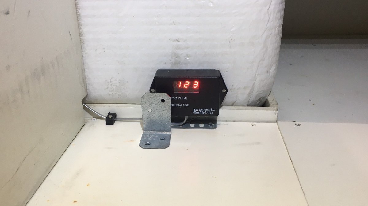

dewdev Posted July 14, 2025 Posted July 14, 2025 (edited) I use a Progressive Industries EMS at the power pole, so I can immediately see the quality of power at the power pole and see if there are any error codes. I still check the one in the attic, but not necessarily in a hurry. Edited July 14, 2025 by dewdev 1 2018 Oliver Elite II, Twin Bed, Hull #354, new Lithonics batteries and Xantrex Freedom XC 3000 Pro Inverter in 2025 2024 RAM 1500, 4 x 4; Gas. 5.7L V8 Hemi MDS VVT Torque; 3.21 rear axle ratio w/TIMBREN spring rear suspension addition Maine
jd1923 Posted July 14, 2025 Posted July 14, 2025 3 hours ago, routlaw said: Interesting, never heard of the EMS and my #70 certainly does not have one installed. @tallmandan sort of figured this is where the 7 pin cable entered into the cabin but did not want to open up that can worms at the time so took the easier route by disconnecting at the exterior plug thanks to @Mike and Carol suggestion. The EMS is between your Shore Power Outlet and your 120VAC power panel that holds the half dozen breakers for your A/C, Microwave, 110V outlets, etc. It has nothing to do with the trailer wiring, harness connected to the tow vehicle. The EMS (Electrical Management System) protects against shore power that is wired incorrectly, does not have ground or is at a voltage outside of the proper range. One can be added by cutting the interior shore power cable in two and wiring the device in between. See the attached picture. The device on the left is the ATS (Automatic Transfer Switch) which switches between inputs of shore power from the bodyside outlet or the secondary front outlet used to connect a generator in the front basket. The device on the right is the PI EMS that I installed. 58 minutes ago, dewdev said: I use a Progressive Industries EMS at the power pole, so I can immediately see the quality of power at the power pole and see if there are any error codes. I still check the one in the attic, but not necessarily in a hurry. Some here believe in this redundancy. I believe it's like paying two insurance companies when only one of them will pay the claim. And if the one at the pole reads with good numbers, there's no need to check the one in the Attic. Having one EMS is sufficient. If you do not have one, and do not want to install one, the pole EMS is fine. But I would move the EMS display in a usable location before adding another at the pole, that's just me. I do not want any devices out at the pole like EMS or water filters, etc. I like mine integrated internal to the Oliver which makes for quick and easy camp setup and tear down. The expensive EMS device at the pole have been known to disappear or get lost! 🤣 1 Chris & John in Prescott, AZ | 2016 EII #113 | '01 Ram 2500 Cummins!
dewdev Posted July 14, 2025 Posted July 14, 2025 (edited) @jd1923 The Progressive unit (for at the pole) has a metal loop so you can lock it to the power pole, so hopefully it is harder to disappear. Edited July 15, 2025 by dewdev 3 2018 Oliver Elite II, Twin Bed, Hull #354, new Lithonics batteries and Xantrex Freedom XC 3000 Pro Inverter in 2025 2024 RAM 1500, 4 x 4; Gas. 5.7L V8 Hemi MDS VVT Torque; 3.21 rear axle ratio w/TIMBREN spring rear suspension addition Maine
