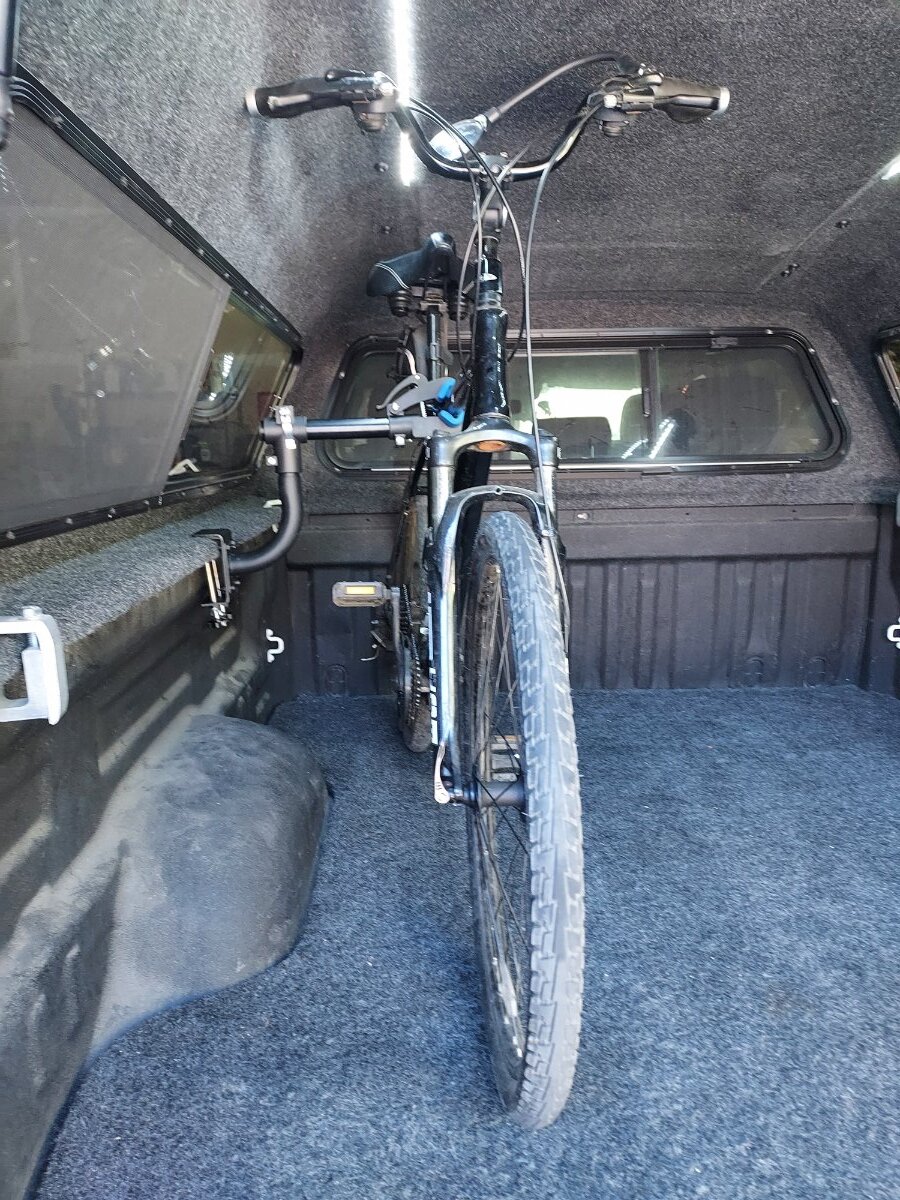

Thanks for your helpful suggestion.  I have considered the Ride88  system.  I actually purchased a different product from Amazon that secures the bike to the truck bed sidewall rather than that front of the bed: https://www.amazon.com/dp/B0FP4TT13F?ref=ppx_yo2ov_dt_b_fed_asin_title  See attached photo.
But, carrying my large mountain bike in the truck bed significantly limits the amount of other stuff we can haul in the bed.  Our hope is to be able to carry the bike in a bike rack behind the trailer while on the road.  Then, when necessary, secure the bike at night inside the truck bed with canopy.  We can remove other stuff carried in tubs, that is a less likely theft target than the bike, and secure the bike inside the truck bed with canopy at night.

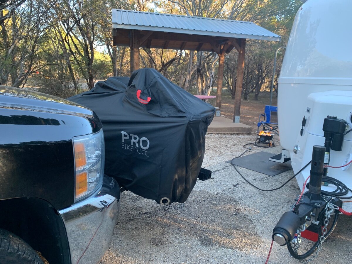

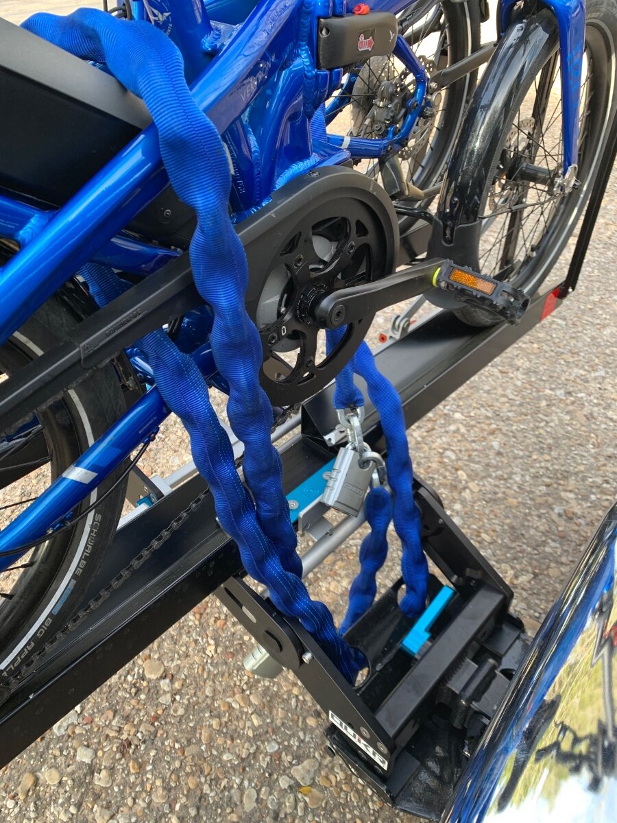

Other than front TV or rear Oliver carry, I’ve seen owner pics and discussion of racks mounted between the two using a double 2” receiver; trailer towed from lower, rack mounted in upper. These receivers are rated for the heavier load, I kinda remember 10,000 lbs., not sure if a reducer was used in the upper to enable use of a 1.25” bike rack, but think that setup would be an option. Be sure and buy a rack with optional ramp, a real back saver! As for securement, I chain our bikes to the rack at night, cover in place and set alarms!

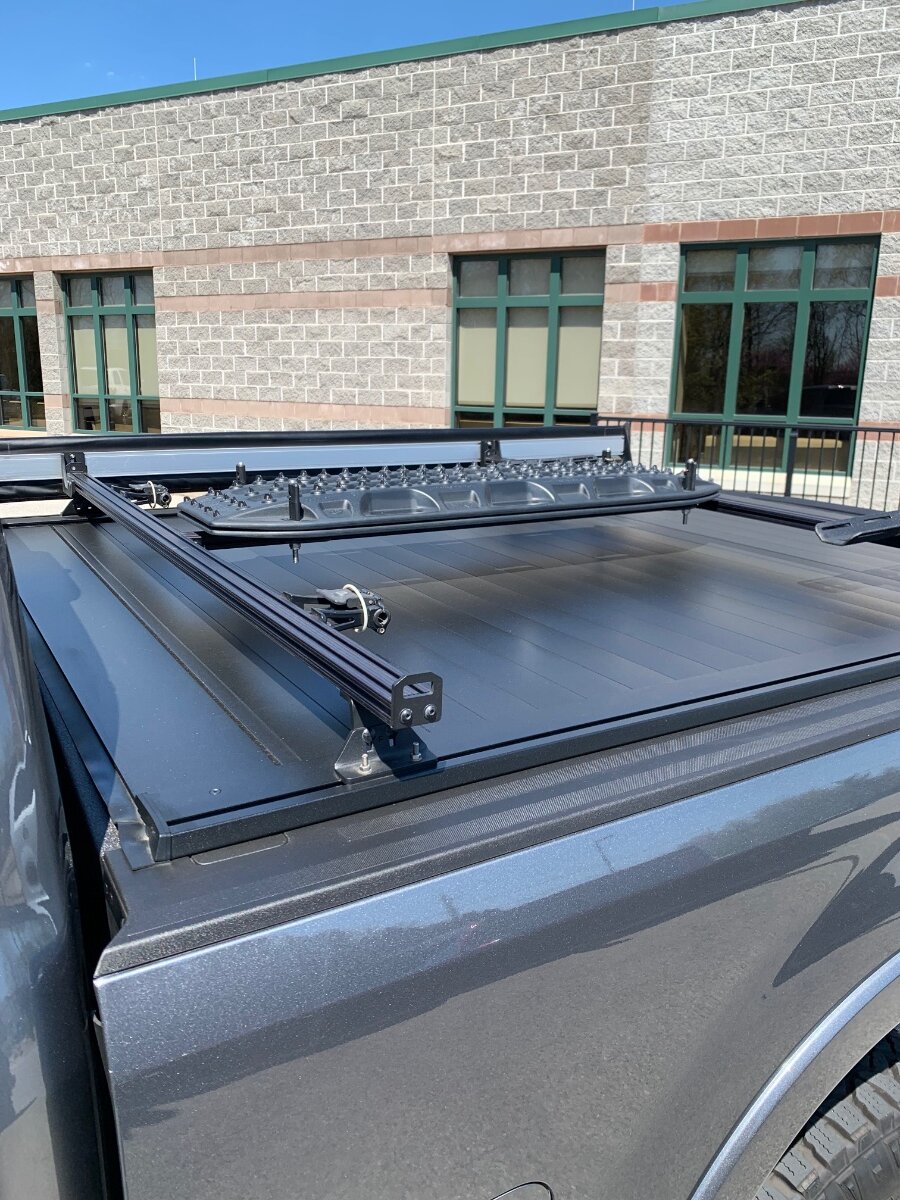

I have always been afraid to mount my bikes on the front of the TV.  Too many bugs and other road hazards. I have been very happy carrying my bikes on a low bed rack mounted above my Retrax bed cover. The front of the rack has two rocky mounts for the thru axles, the rear trays are from Voodoo. I made the bed rack with components from various venders. I have to remove the front wheels for travel, but have full bed capacity except for the bed consumed by the Retrax roll box.

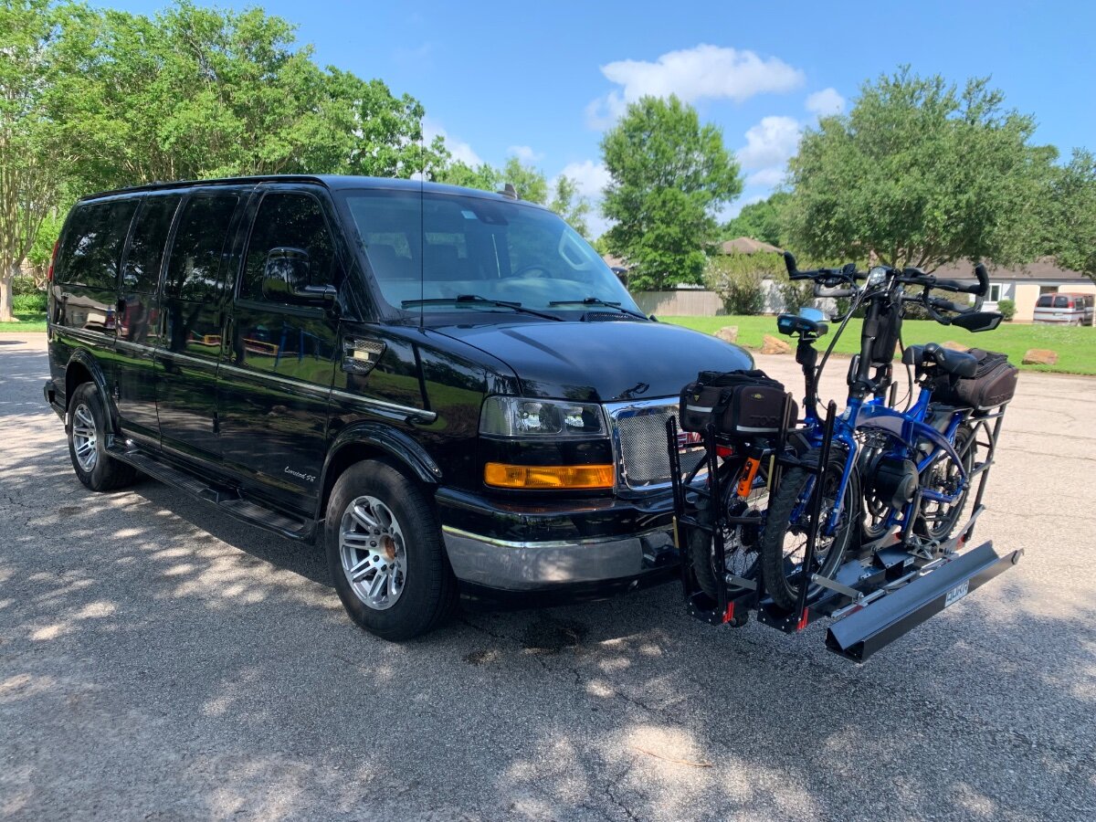

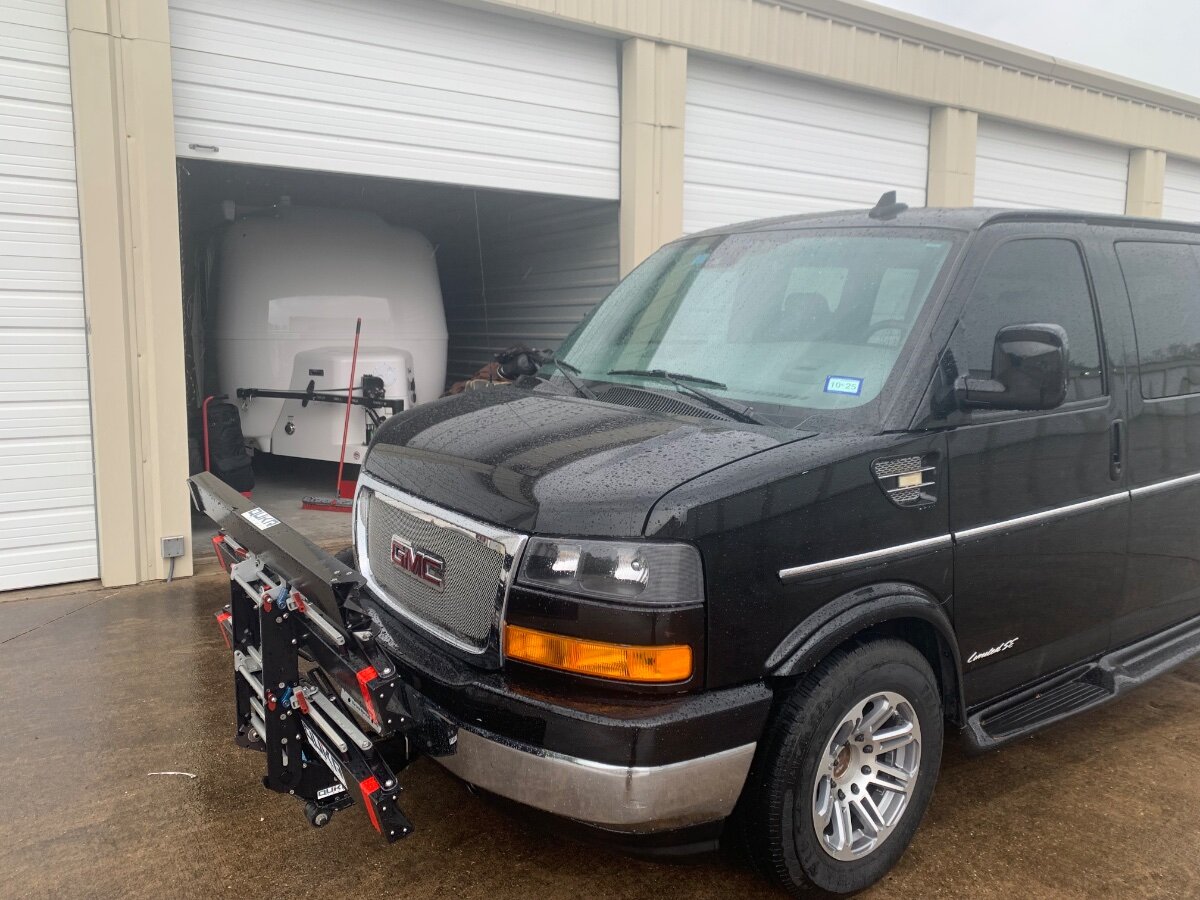

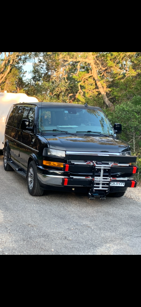

I had a Retrax cover on my former TV truck, but needed more bed room so replaced it with an A.R.E. cap. As with the former, we travel with the bike rack on the front of the Savana, but our folding ebikes are stowed inside in protective bags. Once at camp the ebikes are deployed and the rack is then used for local transport and securement.
