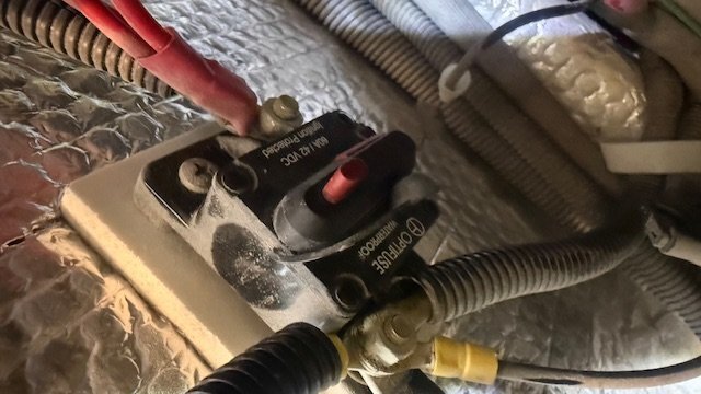

Skipster Posted September 27, 2025 Posted September 27, 2025 possible fixes checked breaker panel. Switched on and off. Heard clicking noise but no power no inverter turned breaker on an off under seat across from inverter still no power. it worked fine 2 weeks ago skip and cyd nielsen hull #822 Elite tow vehicle 2017 jeep trailhawk v6

jd1923 Posted September 28, 2025 Posted September 28, 2025 (edited) 2 hours ago, Skipster said: should be something simple. Are all your 12V circuits working? e.g. lights, stabilizer jacks, etc. Attach some pictures here, of the inverter, inverter panel or on/off switch, wiring into the inverter and devices near the inverter. Do you have a multimeter, or test light? @ADKCamper gave you a good checklist for testing. The gurus are here. Post pictures and get a meter or simple test light at an auto parts store. It is likely simple.. Edited September 28, 2025 by jd1923 2 Chris & John in Prescott, AZ | 2016 EII #113 | '01 Ram 2500 Cummins!

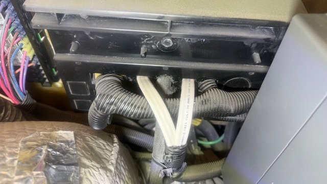

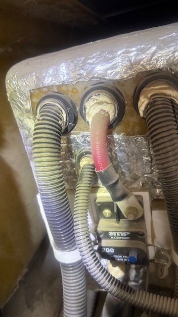

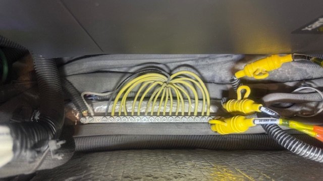

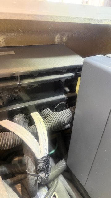

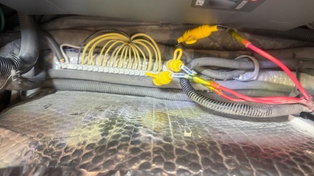

Skipster Posted September 28, 2025 Author Posted September 28, 2025 here are some pictures of the inverter and nearby fuses ect I will get tester and I have a testing 12v light stick. but the problem is I do not know where to put the tester or the light 12v tester.... sorry for my ignorance Its pretty tight in there skip and cyd nielsen hull #822 Elite tow vehicle 2017 jeep trailhawk v6
Moderators topgun2 Posted September 28, 2025 Moderators Posted September 28, 2025 (edited) Skip - I don't see any obvious issues other than the dust that is everywhere. That dust can get into many areas that you don't want it to - I know this because every couple of years I have to plug and unplug the remote cable (runs from the back of the remote switch inside the living area of the Ollie) to the inverter. I've never had to bother with the connection on the back of the inverter switch but it is the connection that goes into the inverter itself. However, as I think you said that you had already tried turning the inverter on/off at the inverter itself, I doubt that this is your issue. But, its worth a shot. If you decide to try this, what you are looking for is what appears to be one of those little phone jack connections. Simply press down on the little plastic tab and pull straight out and push straight back into where it came out. Do this two or three times to help "clean" the connections. Bill Edited September 28, 2025 by topgun2 grammer 2 2023 Ford F150 Lariat 3.5EB FX4 Max Towing, Max Payload, 2016 Oliver Elite II - Hull #117 "Twist" Near Asheville, NC
jd1923 Posted September 28, 2025 Posted September 28, 2025 6 hours ago, Skipster said: I have a testing 12v light stick. but the problem is I do not know where to put the tester or the light 12v tester.... Having these pictures is great! It may make all the difference in us helping you. Your test light should have an alligator clip on one end, clip it to the negative bus which is the one you have pictured 3 times with all yellow wires. You then want to touch both sides of the SMP 200A breaker shown in your 4th picture. I’m pretty sure this is the breaker between your batteries and inverter. If the breaker is closed (on) and in working order, there should be power on both terminals (test light ON). If you have power on the battery side and not on the other, you need a new breaker and you’ve found your issue. Let us know on this test for next steps if necessary. 1 3 Chris & John in Prescott, AZ | 2016 EII #113 | '01 Ram 2500 Cummins!
Tom and Doreen Posted September 29, 2025 Posted September 29, 2025 Like @jd1923 said, take measurements around this circuit breaker, input vs output . These have been known to fail. As John said you should measure 12V on each side with respect to ground. 1 1 Tom & Doreen • 2023 Elite ll • Hull #1321 • 2023 Tundra Platinum Crew Max • Cheshire CT

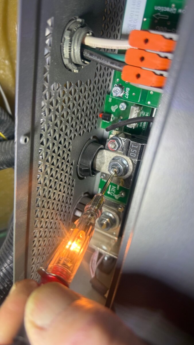

Skipster Posted September 29, 2025 Author Posted September 29, 2025 18 hours ago, jd1923 said: Having these pictures is great! It may make all the difference in us helping you. Your test light should have an alligator clip on one end, clip it to the negative bus which is the one you have pictured 3 times with all yellow wires. You then want to touch both sides of the SMP 200A breaker shown in your 4th picture. I’m pretty sure this is the breaker between your batteries and inverter. If the breaker is closed (on) and in working order, there should be power on both terminals (test light ON). If you have power on the battery side and not on the other, you need a new breaker and you’ve found your issue. Let us know on this test for next steps if necessary. I tested and do have 12v power on either side of the big breaker. I also tested(picture) inside zantrex panel and have power there as well 2 skip and cyd nielsen hull #822 Elite tow vehicle 2017 jeep trailhawk v6
Skipster Posted September 29, 2025 Author Posted September 29, 2025 What would be my next step skip and cyd nielsen hull #822 Elite tow vehicle 2017 jeep trailhawk v6
jd1923 Posted September 29, 2025 Posted September 29, 2025 4 minutes ago, Skipster said: I tested and do have 12v power on either side of the big breaker. I also tested(picture) inside zantrex panel and have power there as well. I read in your other post that unplugging and plugging the inverter makes a noise. This and your test shows you have power to the inverter. The noise means it’s doing something internal. Time to get in the phone with Xantrex Tech Support. You have power in but nothing out. They will have tests for you to do and next steps. Your issue must be the inverter is not powered on or something else internal to the inverter. Good work so far! Keep us posted. 1 3 1 Chris & John in Prescott, AZ | 2016 EII #113 | '01 Ram 2500 Cummins!
