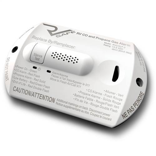

Our factory-installed RVSafe propane/CO alarm has a "Silence/Test" button, which enables us to shut down false alarms without a quick disconnect.  It looks like the one in the photo below.  It has gone off when my wife uses hair spray in the trailer!

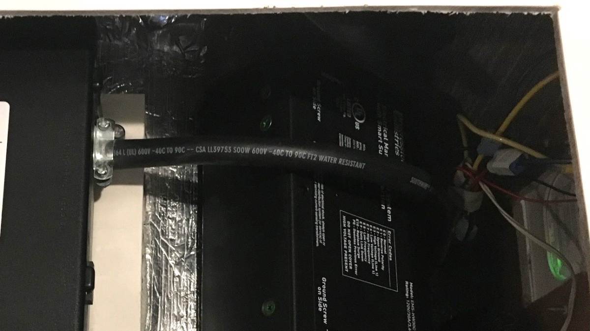

Yours is wired under the bed? Ours is mounted to and wired under the rear dinette seat already. On the right side of the picture below you can faintly see the wiring and a large square cutout. Too bad OTT mounted a recessed model detector requiring this awful 3x3" square hole in the fiberglass! Prior owner replaced it with a surface mount model, same as @Rivernerd has pictured above. Ours is dated 2026 so very soon we have to replace ours.
It's simple to rewire most anything from under the beds to under the dinette given that the combined 12VDC and 120VAC power panel is under the dinette. I moved almost everything out from under the beds as you can read in this post.

Given these detectors have a Silence/Test switch on the face, I'm not adding a switch and don't believe it's a good idea given it can be left off when needed.
Have you tested this Silence/Test switch?
Does it really Silence the alarm for more than a couple of minutes?  If so, how do you turn it back "on"?
2 1/2 years never a false alarm for us. Though no RV antifreeze or hairspray ever in our hull. 🤣
The test button will produce the alarm for a few seconds, and then it continues to be ON.
