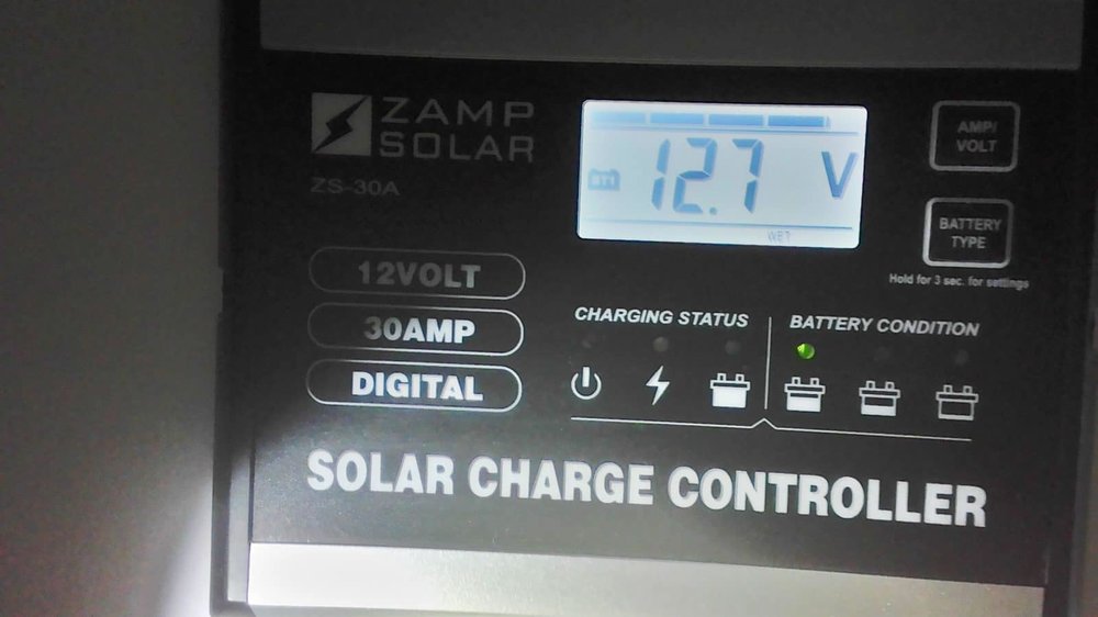

The key is the 4 bars on top showing full, not the battery charging indicator showing at 3, because it's not meaning 3/4, it just means that it's fully charged with no charger running. The only way to get the 4th on the left is when the blue light on the lightning bolt goes out during the day. There is a learning curve but it runs itself just fine as is.
