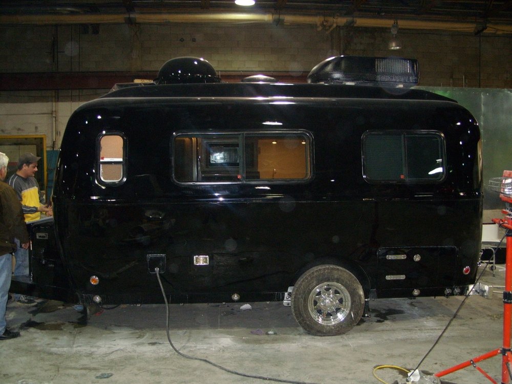

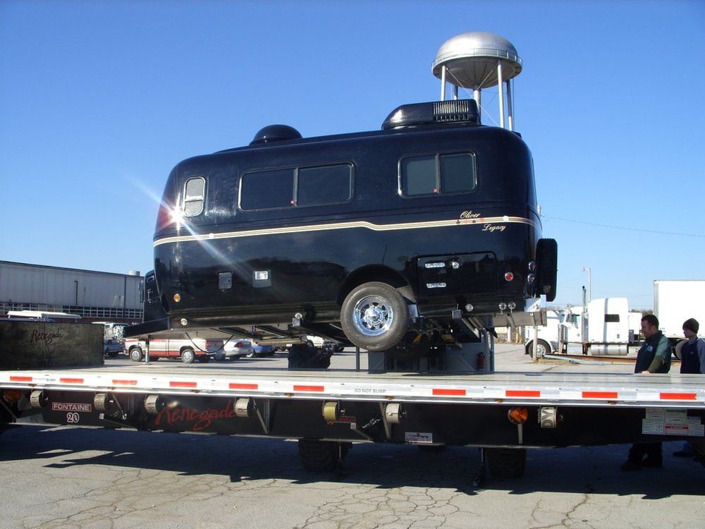

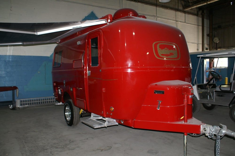

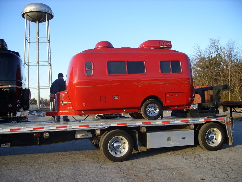

Moderator+ ScubaRx Posted September 11, 2017 Moderator+ Posted September 11, 2017 In the early days Oliver toyed with the idea of different colored trailers. They abandoned that idea due to the difficulty of painting every exterior item to match and the additional cost. However, there were two early Oliver's that were painted and sold. Hull #010 is red and currently owned by our forum member bshaffer. I'm not sure of the Hull # of the other (probably #009 or #011) but it was black and dubbed the "Gamblers Edition" due to the unique graphics and interior upholstery. After construction, both of these units were loaded onto a flatbed truck and shipped out West (Jim Oliver has a house in Lake Havasu, AZ) where they were ultimately sold. They also had a partially painted hull section that was blue. Steve, Tali and our dog Rocky plus our beloved dogs Storm, Lucy, Maggie and Reacher (all waiting at the Rainbow Bridge) 2008 Legacy Elite I - Outlaw Oliver, Hull #026 | 2014 Legacy Elite II - Outlaw Oliver, Hull #050 | 2022 Silverado High Country 3500HD SRW Diesel 4x4

Overland Posted September 11, 2017 Posted September 11, 2017 It's interesting that both of those trailers, red and black, were at the factory, parked together in the big parking lot, when my wife and I first visited in December of 2015. I don't know why they were there but I'm glad we got the opportunity to see them.
