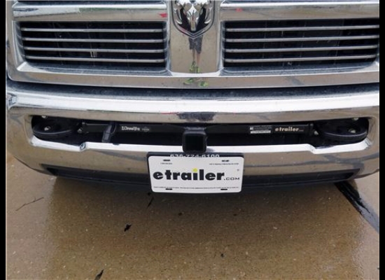

GrayGhost Posted April 10, 2017 Share Posted April 10, 2017 Would something like this work for you? It might be preferable to keep the weight off the back of the trailer for sway prevention. https://www.etrailer.com/ball-mounts/curt/d210.html 3 GrayGhost 2015 Legacy Elite II Hull # 98 2020 F150 3.5 EcoBoost Link to comment Share on other sites More sharing options...

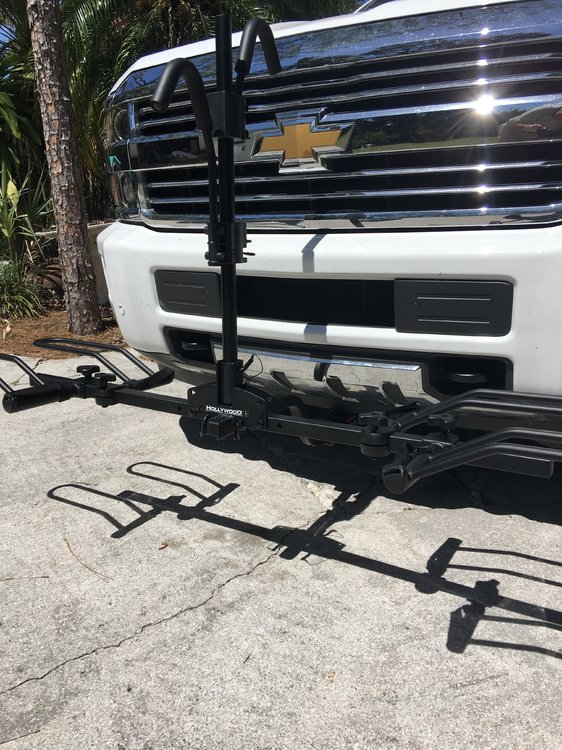

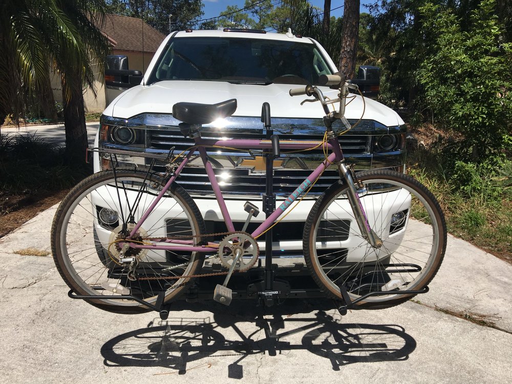

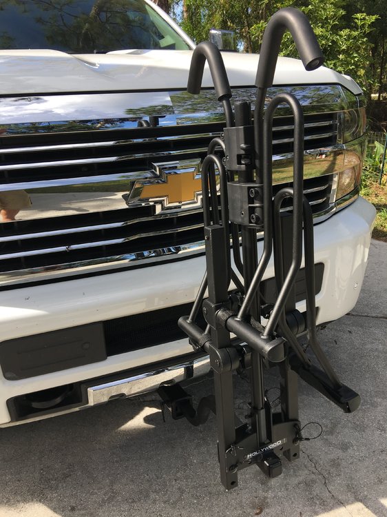

GaryJona Posted April 11, 2017 Share Posted April 11, 2017 I am going to try this with a front mount bike rack have not gone on a trip with it yet I did try it around town and seem to work well. I will have it on my trip to the Rallies next month so that will be my first long drive test. I did get the one that the bike tires are what is supporting the weight on the rack and it had a 45 lbs capacity per bike vs the Swagman like this one was 35 lbs. We will see but I put on my own front hitch which was easy took less than two hours and can even use to pull my Trailer around to park if needed. At least another option I'll try a few photos. Thanks Gary 3 Gary & Jona 2016 Silverado 2500 Diesel Legacy Elite II Hull 81 Link to comment Share on other sites More sharing options...

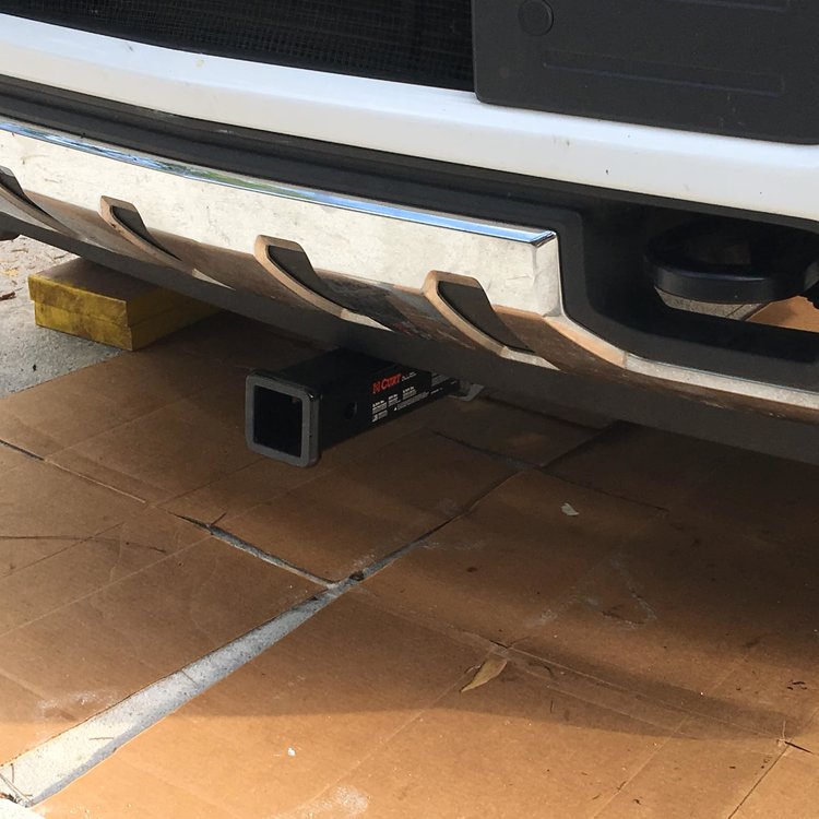

GaryJona Posted April 11, 2017 Share Posted April 11, 2017 I just put on a front mount hitch for a Bike rack I'm going to try. I have only tried it around town and next month I will take it on the road to the rallies to see how she goes. I put on my own hitch took around an hour or two pretty easy. Looks like it will work quite well we'll see. The rack will support two bikes up to 45 lbs each. Thanks Gary 1 Gary & Jona 2016 Silverado 2500 Diesel Legacy Elite II Hull 81 Link to comment Share on other sites More sharing options...
donthompson Posted April 11, 2017 Author Share Posted April 11, 2017 This is a reply to Grey Ghost's post. I investigated this option last fall. It looked promising, but there isn't enough clearance to avoid issues when making tight turns. 1 Don 2020 Kimberley Kruiser T3 2019 Ram 2500 Diesel States I visited with my Ollie (Sold October, 2019) Link to comment Share on other sites More sharing options...

John E Davies Posted April 11, 2017 Share Posted April 11, 2017 Wow, that is remarkably low to the ground. Do you not see this as a problem? There is at least one other option that won't destroy your ground clearance and approach angle. At least it will tell you when you get too close to a concrete curb..... Please post an update on how this has worked for you. JohnDavies Spokane WA SOLD 07/23 "Mouse": 2017 Legacy Elite II Two Beds, Hull Number 218, See my HOW TO threads: Tow Vehicle: 2013 Land Cruiser 200, 32” LT tires, airbags, Safari snorkel, Maggiolina Grand Tour 360 Carbon RTT. Link to comment Share on other sites More sharing options...

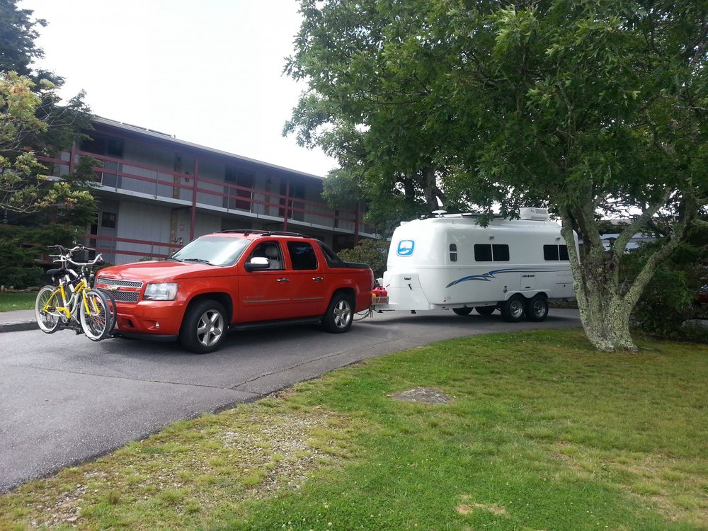

Moderators bugeyedriver Posted April 15, 2017 Moderators Share Posted April 15, 2017 This is how my Breezer Downtown bike will ride to Newfoundland this summer. I took it out for a test ride today and it is absolutely steady with no dipping or wobbling. I have a Curt front hitch for the Taco and use Swagman X/C carrier and an anti-wobble clamp. No ground clearance is lost for the vehicle (the skid plate is lower by several inches) Contrary to how it appears, there is no problem with visibility from the handle bars. The wheels do not extend beyond the sides of the truck, so there is no loss in maneuvering. Parking between vehicles at the grocery store was not a problem. The bike is secured to the hitch with a locking cable. After putting a topper on the back of the Taco, the previous setup interfered with opening the hatch. This was a good solution for me. I'm not too worried about bug splatter on the bike. As long as the seat is clean I'm good to ride. The chain is fully enclosed in a shroud, so there should be minimal issues with rust. My Taco has 218,000 miles on it and still runs like brand new. 2 Pete & "Bosker". TV - '18 F150 Super-cab Fx4; RV - "The Wonder Egg"; '08 Elite, Hull Number 014. Travel blog of 1st 10 years' wanderings - http://www.peteandthewonderegg.blogspot.com Link to comment Share on other sites More sharing options...
