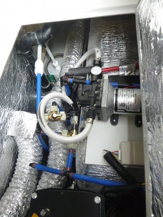

Moderators topgun2 Posted August 18, 2017 Author Moderators Posted August 18, 2017 Wow! You guys are right on it this morning. Below are a few quick photos of this mod. Note that I did not take it apart to see just how far the pickup tube goes towards the bottom of the tank. But, Jason told me that now I would be able to use virtually 99% of the water that was in there, so, I assume that they put that tube right to the bottom. Also, since I only live about seven hours from Hohenwald and just got home yesterday afternoon, I did not have a chance to "test" it. Hope this help! Bill 2 2023 Ford F150 Lariat 3.5EB FX4 Max Towing, Max Payload, 2016 Oliver Elite II - Hull #117 "Twist" Near Asheville, NC
Moderators topgun2 Posted August 18, 2017 Author Moderators Posted August 18, 2017 Routlaw, The fresh water tank mod is designed to allow the water to pick up "all" of the water in the fresh water tank versus the original design that only got something like 80% of the total capacity of the tank before the pump started to suck air. I believe that credit should go to "Raspy" for the original design and idea of putting the pickup into the top of the tank (versus the original that is from the side) with a tube that extends to the bottom of the tank. As soon as I get a bit of time I will post a trip review - with Colorado fish pictures. Bill 2023 Ford F150 Lariat 3.5EB FX4 Max Towing, Max Payload, 2016 Oliver Elite II - Hull #117 "Twist" Near Asheville, NC

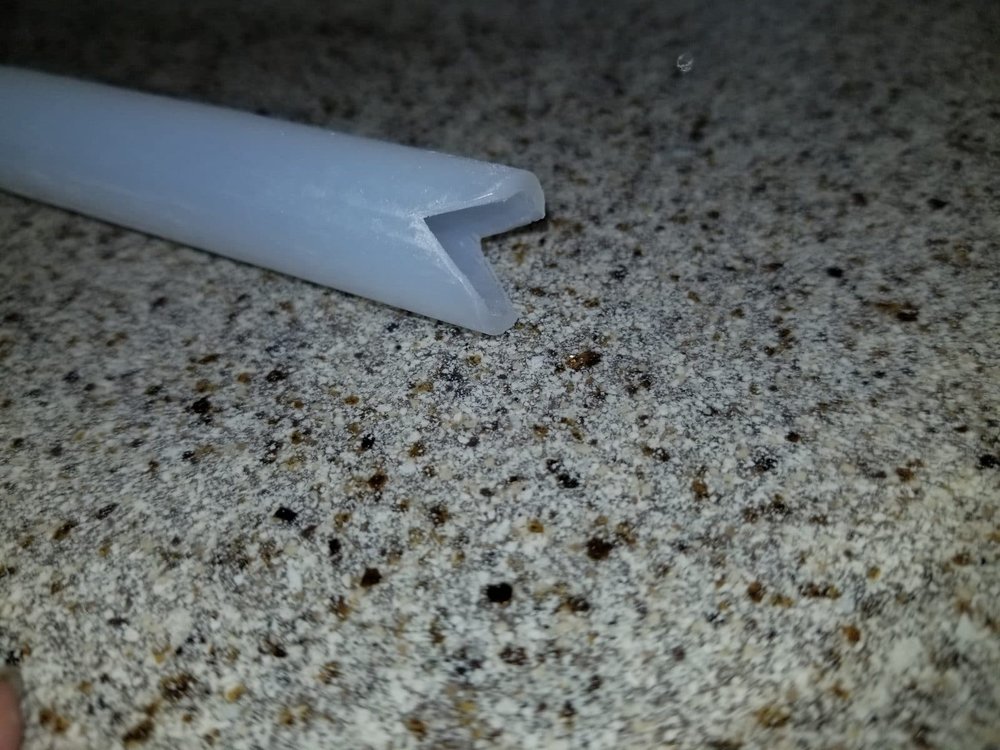

bradbev Posted August 25, 2017 Posted August 25, 2017 I had a list of about 5 items I asked Oliver to check out Monday. One was the water pickup. I was told it was about a 45 minute job. I didn't get a chance to see the tube inserted in mine, but did get a chance to watch another trailer being modified. The pex tube is notched then pushed all the way to the bottom of the tank. I'll try to attach a picture in this message. This morning I had a chance to test results. As level as I could get it, the level indicator showed 6% before it started to suck air and stop pumping. This was down from about 35% before. So I'm happy with the results. FYI, before, it would start sucking air at about 35% but feed would continue down to maybe 25%. The new set-up stops drawing quickly. I possibly could have pulled s little more out by raising the nose. 4
KarenLukens Posted August 25, 2017 Posted August 25, 2017 It takes just 45 minutes to make right :) And probably 3 minutes now before the tank is installed during the build process on new trailers. Excellent news on the resolution of this easy to fix problem. Do you know if they are doing all of the spin welds on the new tanks, or did they get the tank factory to start putting them in for them before shipment? We can now mark this major problem as Solved :) I didn't realise that this is a new thread being that we've been out of touch for a week :) Happy Camping, Reed & Karen Lukens with Riffles our Miniature Poodle 2017 Oliver Legacy Elite II Standard, Hull #200 / 2017 Silverado High Country 1500 Short Bed 4x4 Past TV - 2012 Mercedes-Benz ML350 4Matic BlueTEC Diesel Click on our avatar pic above to find the videos on our Oliver Legacy Elite II
KarenLukens Posted August 25, 2017 Posted August 25, 2017 Wow! You guys are right on it this morning. Below are a few quick photos of this mod. Note that I did not take it apart to see just how far the pickup tube goes towards the bottom of the tank. But, Jason told me that now I would be able to use virtually 99% of the water that was in there, so, I assume that they put that tube right to the bottom. Also, since I only live about seven hours from Hohenwald and just got home yesterday afternoon, I did not have a chance to “test” it. Hope this help! Bill What's the story on the new 3way valves? Happy Camping, Reed & Karen Lukens with Riffles our Miniature Poodle 2017 Oliver Legacy Elite II Standard, Hull #200 / 2017 Silverado High Country 1500 Short Bed 4x4 Past TV - 2012 Mercedes-Benz ML350 4Matic BlueTEC Diesel Click on our avatar pic above to find the videos on our Oliver Legacy Elite II
Raspy Posted August 25, 2017 Posted August 25, 2017 That looks like it will work pretty well. I wonder too, how they plan to resolve the issue for the trailers out West? Anyone can contact me if needed. John "I only exaggerate enough to compensate for being taken with a grain of salt." LE2 #92 (sold), Black Series HQ19
Moderators topgun2 Posted August 25, 2017 Author Moderators Posted August 25, 2017 Reed - those are the "old" three way valves. Don't know exactly when they made the switch but, as far as I know, this is what was used through at least March, 2016. I've never had a problem with them. Bill 1 2023 Ford F150 Lariat 3.5EB FX4 Max Towing, Max Payload, 2016 Oliver Elite II - Hull #117 "Twist" Near Asheville, NC
