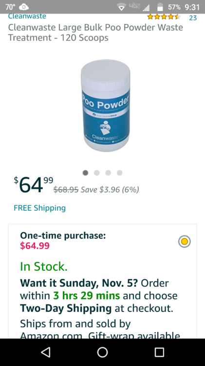

Reed, I thought they would. Have you ever tried the gel powder material like this?
One trip, a long time ago, we tried the kitty litter and trash bag thing, and it was a HUGE fail. Good experiment, but not my favorite memory...

Reed, Have you ever tried the gel powder material like this? One trip, a long time ago, we tried the kitty litter and trash bag thing, and it was a HUGE fail. Good experiment, but not my favorite memory… Sherry
Nope, we use a sealed soap type packet for the black tank

Reed -
If you look at the "poo" product Sherry mentions above, I don't believe it is meant to be used in the manner you're thinking (in the black tank).  Basically it is similar to the stuff that is in the bottom of the plastic bags that both you and I have used.  I understand that it is a bunch cheaper to buy this powder in bulk and use your own plastic bags, but I've never used it and given the number of times that I "go" this route it doesn't seem to be worth the bother to me.
Yes,
The poo powder I referenced was NOT meant to be utilized directly in the black tank. Ohhh so clog. .
I meant using it in a plastic kitchen bag , biodegradable, just situated in the onboard toilet, instead of a tent or other site.
It will be in the 20s soon, at night, where we will be. I'd rather have a way bag, and a winterized trailer, than not. In our 2008, we don't have a lot of your more advanced insulation and conveniences.
Sherry
Yes, The poo powder I referenced was NOT meant to be utilized directly in the black tank. Ohhh so clog. . I meant using it in a plastic kitchen bag , biodegradable, just situated in the onboard toilet, instead of a tent or other site. It will be in the 20s soon, at night, where we will be. I’d rather have a way bag, and a winterized trailer, than not. In our 2008, we don’t have a lot of your more advanced insulation and conveniences. Sherry
Yuk... No don't try using kitchen bags, they smell. The one's that Bill listed have a double zipper on a strong plastic bag. Once it's zipped up, the smell stays in the bag. We tried the kitty litter once... Never again :)
