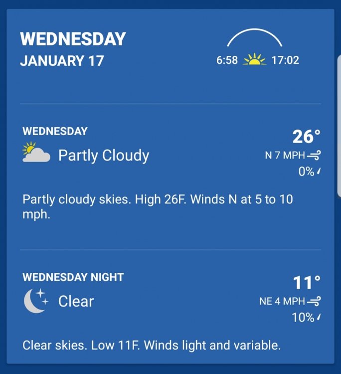

ShallowGal Posted January 11, 2018 Share Posted January 11, 2018 Wednesday the 17th is our Ollie's day of birth and this Florida girl, who is trailer & winter camping for her first time, is comforted by this thread - considering the forecast. Chris & Duke Chadwell 🐾Maddie & Baxter🐾 Elite II Hull 292 2022 F-250 Lariat 7.3 Godzilla 4x4 Lakeland,FL Link to comment Share on other sites More sharing options...
