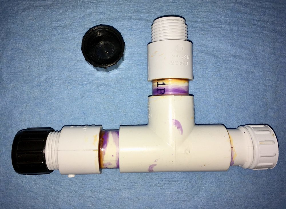

All parts are standard 3/4" PVC fittings except for the female and male garden hose adapters, which may be a little harder to locate. Ace Hardware had everything I needed. I used yellow CPVC cement because I didn't't have the regular kind, but it is fine for this application.
You can insert this inline with your fresh water hose after the filter, with the short arm facing up. With no water pressure in the hose (tee empty), unscrew the cap and pour in or inject the appropriate quantity of household bleach. Install upper cap and turn on the water.

I don't use the tee routinely, but if the water source is suspicious (like a non-residential well), and I have no alternative, then I use it. For city water it is not at all needed. But you DO need to shock your system, annually at least, with bleach, to make sure nothing nasty is growing in there..... and I don't drink anything straight out of the RV tank, it ALWAYS goes through a pitcher filter.

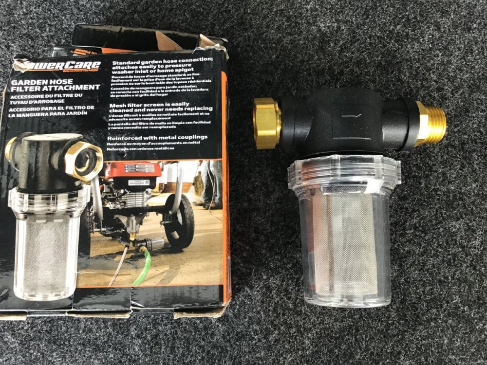

I found this inline pressure washer filter system.  It works great a little bleach or peroxide in the container the ends are made for the garden hose. Bypass the water heater and let the water flow through the system. Let it sit rinse done.

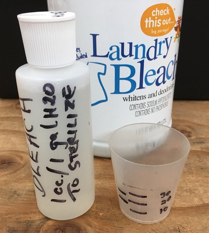

For sanitizing, NOT drinking, we use 1/2 to 2/3 cup of bleach for the 30+ gallon fresh tank and all the associated pipes. Just run each faucet until you can smell the chlorine. We usually let it sit overnight and then drain and rinse. Don't forget the outside wash station.

Yes, that's far too much bleach for drinking  water.
