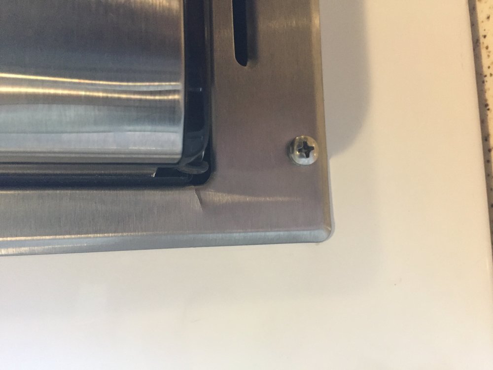

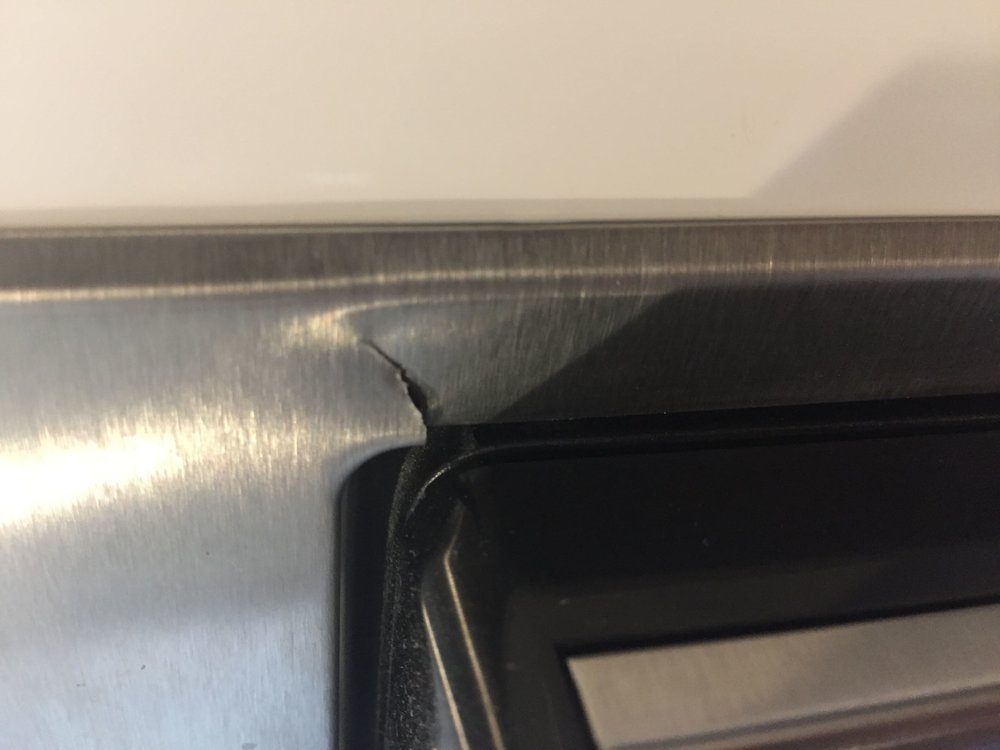

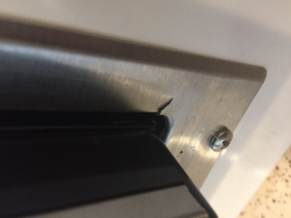

Foy_Mirna Posted September 28, 2018 Share Posted September 28, 2018 With 5 days of straight rain we have had plenty of time inside. So organize and clean. While cleaning the outside of the microwave I notice my paper towel was catching on the corners of the stainless steel frame round the microwave. Looking closer I found three of the frames corner have stress cracks. See other phots below I can only surmise this is form installation or the microwave is not fullly suppprted and movement is stressing the material. Anyone’s else have this happening or ideas of why? As always, this form and been amazing and I truly appreciate all who contribute to it. Onward, Foy and Mirna Roamy Mc Roadhouse 2017 Legacy Elite II, Twin Bed Hull #227 2021 RAM 1500 Limited Link to comment Share on other sites More sharing options...
Overland Posted September 28, 2018 Share Posted September 28, 2018 ...microwave is not fully supported... Impossible to say for certain, but that sounds like the most logical answer. 1 Link to comment Share on other sites More sharing options...
STEVEnBETTY Posted September 28, 2018 Share Posted September 28, 2018 Foy, I just checked mine, no cracks. I imagine your diagnosis is correct, either the mounts are loose or have never been connected. I seem to remember someone else posting about their microwave coming out ( it wasn't mounted correctly) Steve 1 STEVEnBETTY Link to comment Share on other sites More sharing options...
Moderators topgun2 Posted September 28, 2018 Moderators Share Posted September 28, 2018 Yep - that was probably me. However, my microwave was only held in by the "face plate" and when the 3/4 inch screws that held it in place let go, the whole microwave almost broke loose going down the road. There is supposed to be a bracket on the top, middle of the microwave that holds it firmly to the surrounding cabinet above. One should be able to see this bracket by removing the face plate, shining a light across the top of the microwave right in the middle. The bracket is made of thin, but strong steel. Bill 1 2023 Ford F150 Lariat 3.5EB FX4 Max Towing, Max Payload, 2016 Oliver Elite II - Hull #117 "Twist" Near Asheville, NC Link to comment Share on other sites More sharing options...

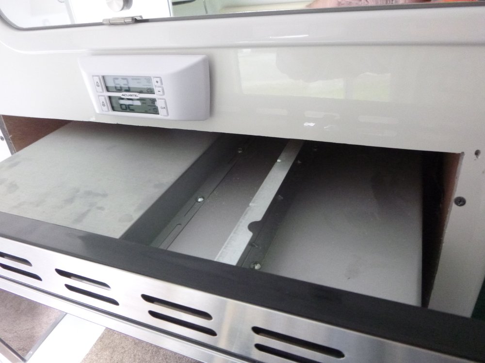

Moderators topgun2 Posted September 29, 2018 Moderators Share Posted September 29, 2018 Sorry for the delay - I just got home from a short trip to upper NY State. Jason sent me the parts that should have been there in the first place and I installed them myself. The hardest part was cutting a 4 inch hole through the cabinet above the microwave down into the area where the microwave sits - that fiberglass is really tough stuff and basically destroyed the carbide bit I used. The missing bracket was installed on the top of the microwave and then - via the 4 inch hole - it was secured to the microwave cabinet from above with a couple of stout stainless screws. Even though Jason included a "port hole" to be placed where I had drilled the 4 inch hole, I decided that I would not use it due to the "bump" it would cause in the bottom of that cabinet. Instead, I glued a thin piece of lexan that I had laying around over the hole and replaced the existing black rubber mat over it - you'd never even know that it was there. The whole process took less than 45 minutes and I was being super careful. The microwave has never moved in the three years since. The attached photos show the microwave before I attached the bracket that Jason sent me - that bracket is attached to the metal piece seen running from the front to the rear of the top of the microwave. In my case the only damage that was done was that three out of the four screws that hold the face plate of the microwave on were stripped out of the fiberglass and the fiber-granite top below the microwave was gouged by one of those screws. Jason replaced the fiber-granite top and supplied four screws that simply were a half inch longer and worked perfectly for holding the face plate while also concealing the stripped holes. Sorry that I didn't take a picture of the installed bracket. Bill 1 2023 Ford F150 Lariat 3.5EB FX4 Max Towing, Max Payload, 2016 Oliver Elite II - Hull #117 "Twist" Near Asheville, NC Link to comment Share on other sites More sharing options...

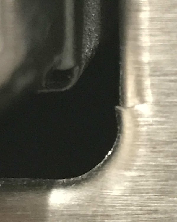

Kayrae51 Posted September 29, 2018 Share Posted September 29, 2018 Foy, I just noticed a small crack in the lower right corner of our microwave frame while cleaning the other day. It’s just big enough to catch my cleaning cloth. I assumed it was cracked during installation but your thoughts sound more likely. Thanks for bringing up this subject......Kathy [attachment file=52095C67-95A3-44DE-B5E6-B5CC0A31817D.jpeg] 1 Clair & Kathy Reed - plus our travel companion: Emma 2017 Legacy Elite II - Hull# 245 2014 Ram 1500 3.0 V6 Eco-diesel 4x4 Link to comment Share on other sites More sharing options...
Townesw Posted September 30, 2018 Share Posted September 30, 2018 We also have a crack in the lower right corner of the trim frame. We have the Contoure RV-950S. Looks like it is a different unit from what topgun2 has so it might mount differently. 1 Bill and Martha 2018 LEII Hull 313 2019 Chevrolet 2500HD Duramax Link to comment Share on other sites More sharing options...
