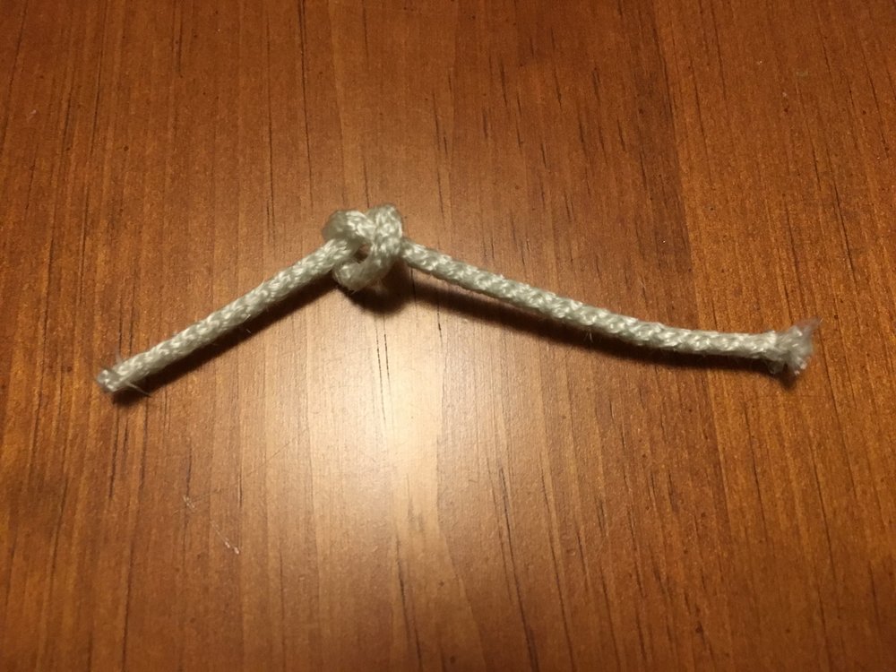

Frank C Posted November 11, 2018 Posted November 11, 2018 New to the forum. Just ordered our Elite II on November 2nd. Won’t be delivered until May 9th, but yeah, I had the same thought about using fiberglass lantern wicks. I plan on trying these when I get my trailer. Should provide good capillary action to wick water through the weep slot and out of the track Legends Direct Premium Long Lasting 18-Pack 1/8" x 6" Round Fiberglass Replacement (Tiki) Style Wicks https://www.amazon.com/dp/B008FP73LG/ref=cm_sw_r_cp_api_B5l6BbVAPFHT7

Frank C Posted November 27, 2018 Posted November 27, 2018 I did finally receive those fiberglass wicks. They are extremely flexible. See photo. I did some quick tests with a glass of water and they do provide a good capillary action. So I have a pack of them all ready to install when I pick up my Elite II in May. Legends Direct Premium Long Lasting 18-Pack 1/8" x 6" Round Fiberglass Replacement (Tiki) Style Wicks https://www.amazon.com/dp/B008FP73LG/ref=cm_sw_r_cp_api_KNC.BbRPWHWXF
Moderators mossemi Posted November 27, 2018 Author Moderators Posted November 27, 2018 They sure look flexible and now all you have to do is wait until May to use them. We’ll see you at the rally. Mike and Krunch Lutz, FL 2017 LEII #193 “the dog house”

Frank C Posted November 30, 2018 Posted November 30, 2018 Seems like anything stuck in the weep holes would cause a partial blockage of the drains and not allow them to drain as good as if they are clear. The capillary wick material can actually help the drainage. The weep holes by themselves can sometimes not drain because of surface tension of the water. And given that the windows are tilted inwards, the tracks won’t drain completely because the outer weep hole is actually a little higher than the bottom inside track surface. A capillary wick material can actually get liquid to flow uphill (just like it does in a wick lantern) to help drain water out of the track. Just have to position the outside end of the wick a bit lower than the end inside the track. As mossemi mentioned, the pipe cleaner works as a pretty good wick as well. I just went a little further and figured I’d try a fiberglass lantern wick material as an experiment, just because I like tinkering. No metal wire to rust. ? 3 1
