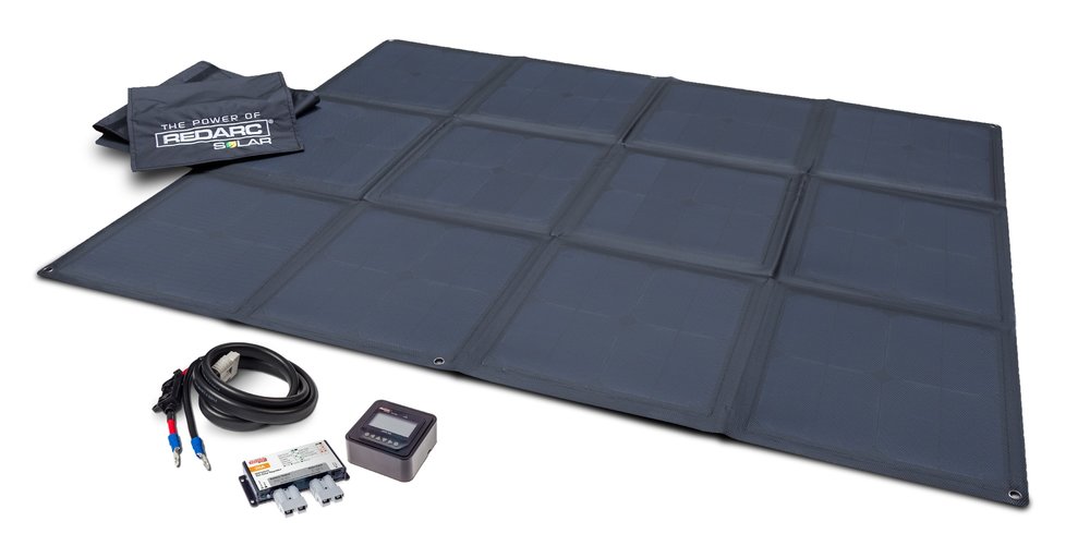

Folding solar blanket, the good side:
The cables are beautiful, using a really heavy gauge wire and high-amperage Anderson Powerpole connectors.
The bad side - they are not yet sold in the USA so you would have to have it shipped in from Oz, they require a charge controller in the RV, and they are the cost of a really nice generator: ... https://www.redarc.com.au/solar-products/solar-blankets
A more affordable HardKorr: .... https://fordraptorlights.com/products/hardkorr-150w-flexible-folding-solar-mat
I have not seen a Chinese knockoff but I would not be surprised if there is one out there. I would buy a 120 w or larger one for up to $300. It would easily fit on a shelf in the closet or in the rear attic. There are a number of them listed at Alibaba (wholesale) but i haven’t seen them for sale here. ..... https://www.alibaba.com/countrysearch/CN/folding-solar-blanket.html?searchweb=Y&
Anybody have a link to one?

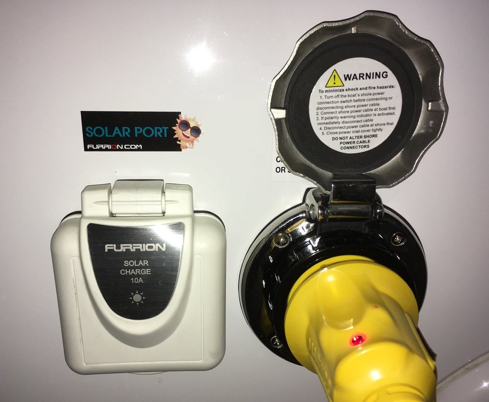

I haven’t looked at a current production trailer, but this is what they installed in mine (218).
The installation instructions call for an inline 10 amp fuse to protect the wiring inside the trailer. Mine did not have one... make sure yours does. The positive and negative wires run directly to the battery, so you need a panel with an onboard charge controller and an output of no more than about 8 amps. A 100 or 120 watt would be perfect.
I sourced a compatible 20 amp male plug and high quality Anderson Powerpole connectors to make a heavy gauge power cable to run my ARB fridge (inside my truck) off the trailer when parked. It works dandy. And I can use the cable as an extension for a solar panel in the future. I can post more info if anyone is interested. Here is the plug...https://www.amazon.com/CNLINKO-Industrial-Circular-Connector-Waterproof/dp/B01M4RQ3X1/ref=pd_cp_263_1?pd_rd_w=W9luB&pf_rd_p=ef4dc990-a9ca-4945-ae0b-f8d549198ed6&pf_rd_r=Z19YVZZ7KAH8KQMVWZS6&pd_rd_r=993fda2b-55b9-11e9-bfd2-9b05f136c4af&pd_rd_wg=EJPXx&pd_rd_i=B01M4RQ3X1&psc=1&refRID=Z19YVZZ7KAH8KQMVWZS6
It would be nice if they added a picture on the standard features page.
I am not at all liking the tacky happy face sun sticker, it needs to come off. It says Solar Charge right on the cover. It’s not even straight ?
Mine came with a Zamp port and I had the option to pay more for the Furrion. It goes direct to the battery, so the portable panel will need a charge controller on it (which most if not all do). Of course I’m sure you could rewire it to go through the onboard charge controller easily. Just make sure you don’t overload the controller. I’ve never checked if there’s a fuse on the port but my panels (also Zamp) have a fuse on them.
I don’t understand the 8 amp limit John. Can you explain?
Well, if you run 10 amps through it, the fuse will pop. Possibly. I picked 8 amps as a safe 80% load. Most smaller panels are fine, I would not try a 200 watt setup through the Furrion connection. You could always add a second one and use two separate panels and harnesses.
If you knew for sure your panel peaked at 10 amps, I guess you could increase the fuse to a 15 amp one without any risk.

Use a 10 amp, that is the specs for the connector and you don’t need to downsize it.
The male plug is rated at 20 amps and you need to use as large a cable as possible. I used 10 AWG and it was a tight fit. Soldering was a little tricky, you need a big iron. The bigger the conductor, the less the voltage drop. This is very important with longer cables when you are using a regulated panel that is only putting out less than 15 volts at best, at its onboard controller.
The factory location is ideal, it is super easy to reach it from under the dinette and also to run the cable into the battery compartment.
