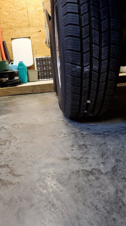

I dropped to 55 for our drive to the rally and one other small trip this year. I was going to try 50 on the return trip from the rally (190 Miles) but the 55 felt so good I am just going to leave it there for our trip out west. I could not tell any difference in tire temperatures between 60 and 55. Very smooth ride. At 55 the tires seem to have a good foot print and just a little buldge on the bottom sidewall. Our trailer weight is 5500 lbs.

Keep the tires harder if you have no TPMS. Keep them harder if you travel a long way at high speed. Keep them harder if you have an Elite, which has a higher tire loading and may be more prone to instability than an Elite II (my opinion only). Increase pressure if your new lower pressure makes the trailer feel less stable. A large pressure change has much more effect as the number gets closer to the recommended minimum value. For example, a change from 80 to 60 is fine. But a change from 50 to 40 is not - work your way lower gradually! If you don’t want to bother with all this, set them at 55 or 60 and just check them every now and then.... IMHO.
The way they are delivered with 80 psi is simply way too high and it will just beat up your expensive trailer. FACT.
