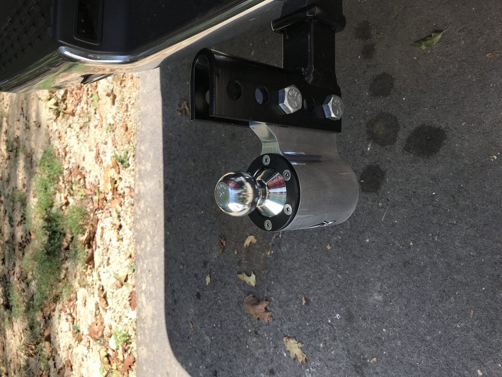

We have a Ram 1500 with collision avoidance. We had a problem hooking up our Ollie at delivery due to brake activation after installing ball into receiver. When we got to Crockett SP we had an issue backing up again to the site with nothing in proximity. I suspect it has something to do with hitch. Each time the issue was resolved by turning off the CAS for the rear. Has anyone had this problem before
? Do you think my ball should be installed with the adjustment going up as seen in the attached picture.

I think the forward collision avoidance system works with the adaptive cruise control to apply the brakes to maintain the set separation with the vehicle in front of you ..... I don’t see any possible way it could be confused by a trailer hitch.
My Land Cruiser has a proximity sensing system. It screams bloody murder if I have it active and install a hitch. The rear “radar” sensors think that the hitch is an obstacle.
Maybe you should post your concerns on a Ram forum, or call the Customer Service number. Your system may not be working as designed.
There is nothing wrong with the ball mount, and you can cut off the excess material with a hacksaw if you like. Just make sure that you don’t need those extra holes for another vehicle, or for re-trimming the trailer if you install different diameter tires on your truck....
Many newer cars have rear proximity sensors that auto-brake if it detects something within a particular distance. Too many heard the solid tone and kept going I guess. Trimming the excess mount may help, but if the sensors are in the chrome part of the bumper, it may still detect the ball. Disabling the sensor/rear cas might be the right thing. I don't drive with my hitch mount installed if there isn't a trailer, partially in case of collision and partially to save my shins.

Either my new 2019 Ram does not have that feature, or I just don't hear, or see it on the dash. True about banging your shin, but I find with the Anderson ball assembly it does not stick out as much as my old WDH with the spring bars type did.
