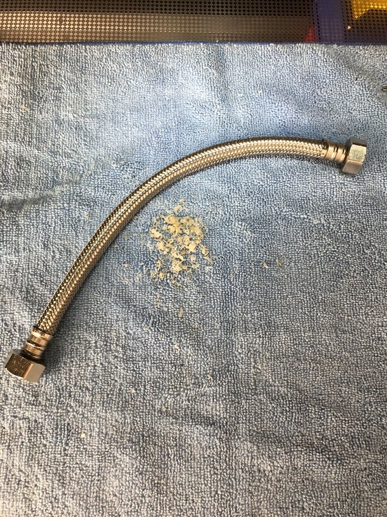

Landrover Posted August 27, 2019 Share Posted August 27, 2019 Hobo If you still have low water flow at the sink. And you found white plastic in the pump strainer. You’ll need to remove the steal braided line going into the pump. Use a coat hanger and run it through you should find it packed with plastic chips. Once its clean you should have normal flow and your shower head should stay on when you use the spray. If it cures the problem let service know. 1 Grant 2022 GMC Denali 2500 HD 2019 Elite 11😎 Link to comment Share on other sites More sharing options...
Landrover Posted August 27, 2019 Share Posted August 27, 2019 Let’s try this again tried to post and got a 404 error lost everything. Hobo If you still have low water flow at the sink and you found white plastic chips in the pump strainer, you’ll need to remove the steal braided line to the pump. Use a coat hanger and run it through you should see it packed with plastic. Once cleared you should have normal water flow and your shower head will stay on spray. If this cures the problem let service know. Sorry for the double post i lost the first post then it appeared. Grant 2022 GMC Denali 2500 HD 2019 Elite 11😎 Link to comment Share on other sites More sharing options...

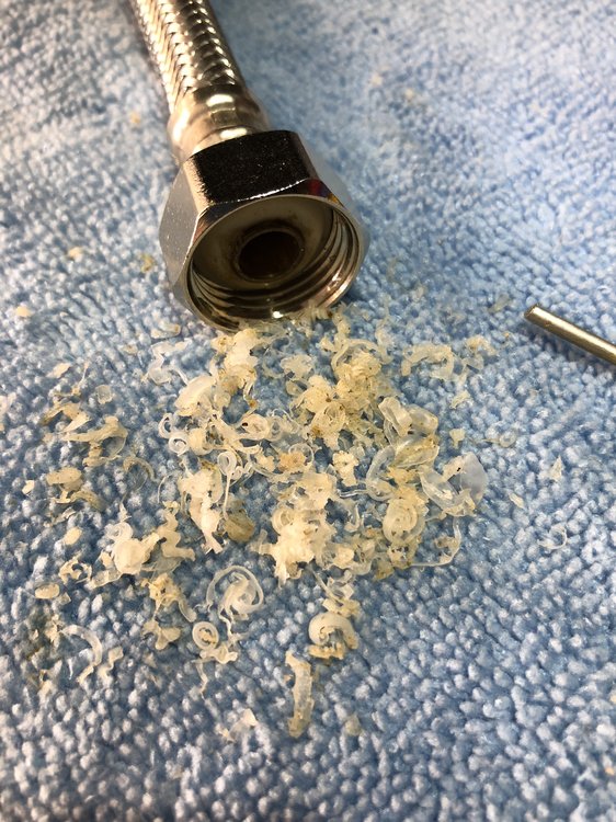

Landrover Posted August 28, 2019 Share Posted August 28, 2019 Just wanted to show what you might find. it will restrict the water flow.but not stop it. Grant 2022 GMC Denali 2500 HD 2019 Elite 11😎 Link to comment Share on other sites More sharing options...
Moderators topgun2 Posted August 28, 2019 Moderators Share Posted August 28, 2019 Sure does look like you found the hard part! Assume that this has fixed the flow problem? Bill 2023 Ford F150 Lariat 3.5EB FX4 Max Towing, Max Payload, 2016 Oliver Elite II - Hull #117 "Twist" Near Asheville, NC Link to comment Share on other sites More sharing options...
Landrover Posted August 28, 2019 Share Posted August 28, 2019 It did for me. Hobo described the same problem i had. It will be interesting to see his outcome. Grant 2022 GMC Denali 2500 HD 2019 Elite 11😎 Link to comment Share on other sites More sharing options...
hobo Posted August 28, 2019 Author Share Posted August 28, 2019 OK, Landrover hit the nail on the head. I removed the stainless water line leading to the filter and it was PACKED with white plastic shavings. It was quite the effort getting that stuff out. Pushing a heavy copper ground wire through it (after several attempts to dislodge the debris with my air compressor) only served to pack it in on either end. I took a small drill bit and once the debris was compressed at one end, I (by hand only) twisted the drill bit into the plastics and dislodged it little by little. Then I would compress the debris to the other end and repeat. Took a dozen or so sets of this before I could finally get the heavy copper wire all the way through. Put everything back together and the water flow, everywhere, is excellent using the pump. Shower head also retains the spray function now. Only question I have is "what the heck size are the fitting nuts? 3/4" is too big, 5/8 is too small, 13/16 is too large. I didn;t have an 11/16s on hand. I need tools on board for this. I ended up using vice grips and pliers but not my favorite tools for this job. Thanks again to all who chimed in. HOBO 2018 Elite II, Hull #414 (the very last 2018 produced). Trailer name "2 HOBOS" . 2018 F250 4X4 Crew Cab, 6.7L diesel Link to comment Share on other sites More sharing options...
